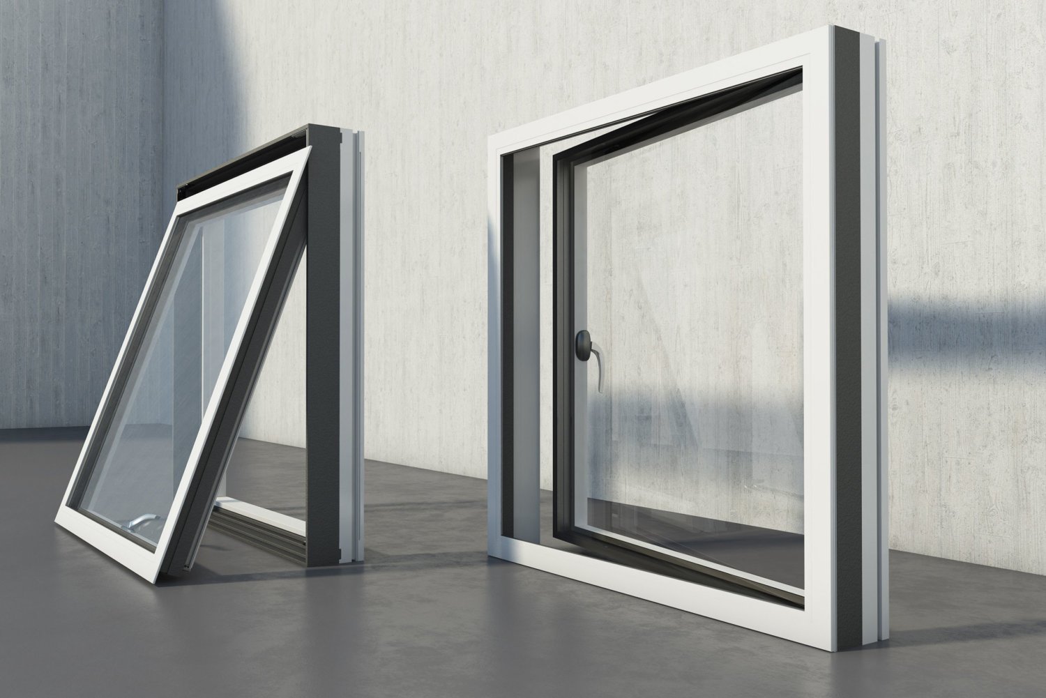

Dreadnaught Posted July 11, 2020 Share Posted July 11, 2020 On the subject of escape windows, I found my particular window supplier (Ideal Combi) was well clued-up on the requirements. I was able to simply say to them that I wanted the smallest compliant opening section and they specified it, including taking account of the angle to which the window would open. 1 Link to comment Share on other sites More sharing options...

Temp Posted July 14, 2020 Share Posted July 14, 2020 How about a more contemporary design. These from Denmark so check standards. https://idealcombi.com/windows/contemporary-windows/ 1 Link to comment Share on other sites More sharing options...
Temp Posted July 14, 2020 Share Posted July 14, 2020 On 11/07/2020 at 14:09, Dreadnaught said: On the subject of escape windows, I found my particular window supplier (Ideal Combi) was well clued-up on the requirements. I was able to simply say to them that I wanted the smallest compliant opening section and they specified it, including taking account of the angle to which the window would open. Ha just spotted it's the same company. Link to comment Share on other sites More sharing options...
soapstar Posted July 14, 2020 Author Share Posted July 14, 2020 21 minutes ago, Temp said: How about a more contemporary design. These from Denmark so check standards. https://idealcombi.com/windows/contemporary-windows/ They do look particularly nice, might give them a shout and ask current lead times etc Link to comment Share on other sites More sharing options...
