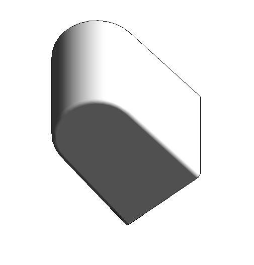

Temp Posted July 7, 2020 Posted July 7, 2020 1 hour ago, Robert Clark said: https://www.victorianplumbing.co.uk/grohe-euro-ceramic-600mm-1th-basin-half-pedestal I might be able to load their CAD model. I'll have a go and let you know. 1

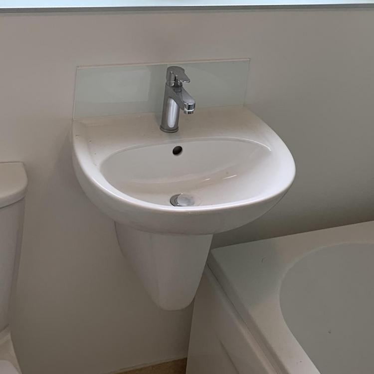

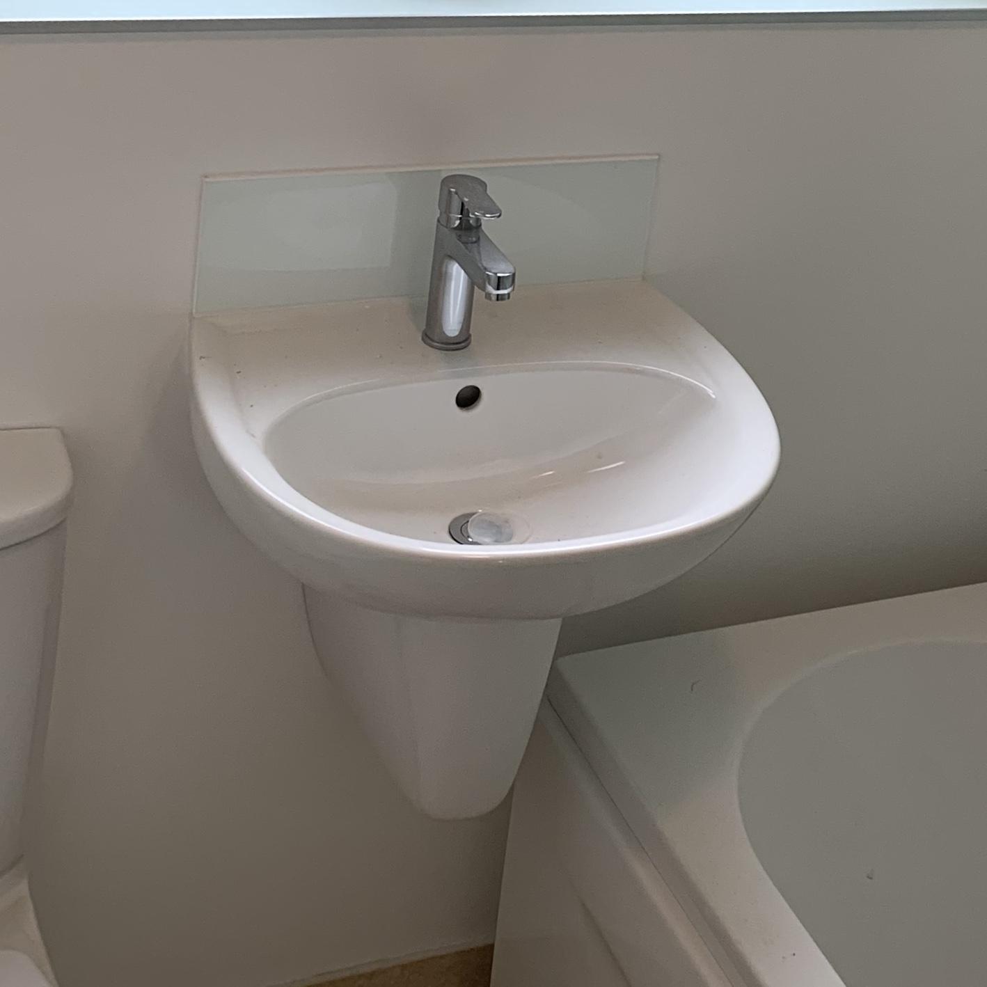

PeterW Posted July 7, 2020 Posted July 7, 2020 Twyford Galerie Plan and is open at the bottom but not by much. 1
Temp Posted July 7, 2020 Posted July 7, 2020 (edited) Managed to open the cad model of the Grohe and look at the bottom. As suspected it looks like this.. Edited July 7, 2020 by Temp 1
Temp Posted July 7, 2020 Posted July 7, 2020 Just for info.. Grohe use a program called Revit from Autodesk to create their cad models (.rfa files). To view them you need the Revit CAD program or the free Viewer that comes with it. Only problem is the downloaded is 7GB even if you only want the free viewer. I'll leave it installed on my PC for a week or two in case you'd like me to look at some others but after that I'll probably uninstall it. 1

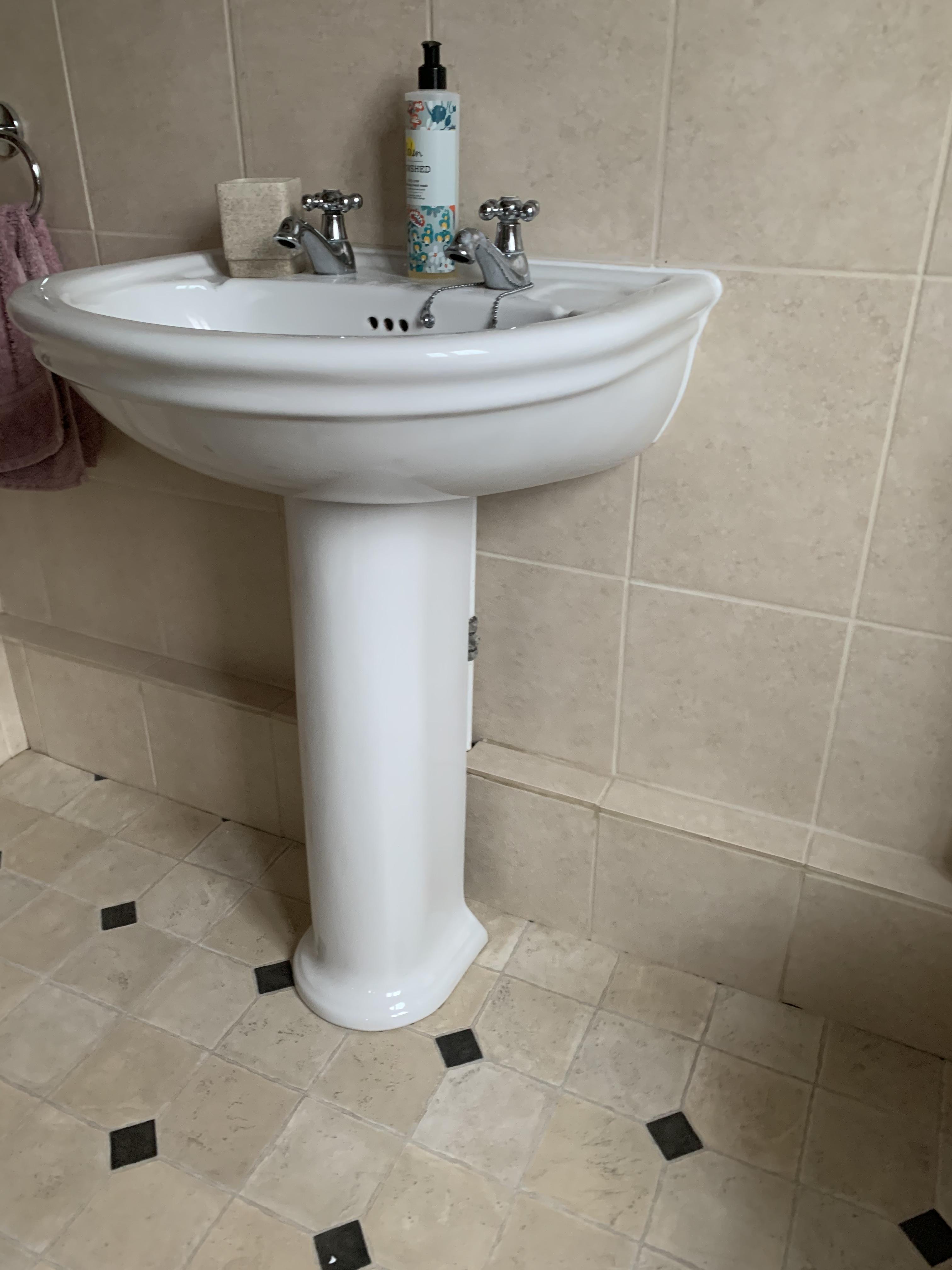

Robert Clark Posted July 7, 2020 Author Posted July 7, 2020 Thanks for all your comments looks like we’ll be going for a full pedestal

bassanclan Posted July 7, 2020 Posted July 7, 2020 It would look dodgy with pipes going in through the bottom of the semi pedestal. Roca do some open bottom semi pedestals 2
Robert Clark Posted July 7, 2020 Author Posted July 7, 2020 Does a full pedestal support the weight of the sink? Just thinking that fixing to our stud wall could be simpler than a wall mounted sink
Onoff Posted July 7, 2020 Posted July 7, 2020 3 minutes ago, Robert Clark said: Does a full pedestal support the weight of the sink? Just thinking that fixing to our stud wall could be simpler than a wall mounted sink Full, to the floor, pedestal is a pita to clean around...apparently. 1
Onoff Posted July 7, 2020 Posted July 7, 2020 With hindsight I'd have gone for a half or no pedestal. ...and maybe paid a tiler! ? 1 1
ProDave Posted July 7, 2020 Posted July 7, 2020 49 minutes ago, Robert Clark said: Does a full pedestal support the weight of the sink? Just thinking that fixing to our stud wall could be simpler than a wall mounted sink They usually take some of the weight. And they will hide the pipes, which is what they were designed to do, 1

Robert Clark Posted July 8, 2020 Author Posted July 8, 2020 For clarity If we were to use a semi pedestal there would only be a short length of pipe between the boxed in pipes below and the bottom of the pedestal Could make a narrow box from tiles ?
dpmiller Posted July 8, 2020 Posted July 8, 2020 why not box and tile the whole thing then if it's just for appearance-?
Robert Clark Posted July 8, 2020 Author Posted July 8, 2020 Just now, dpmiller said: why not box and tile the whole thing then if it's just for appearance-? The semi pedestal would hide the trap and tap connection better I think

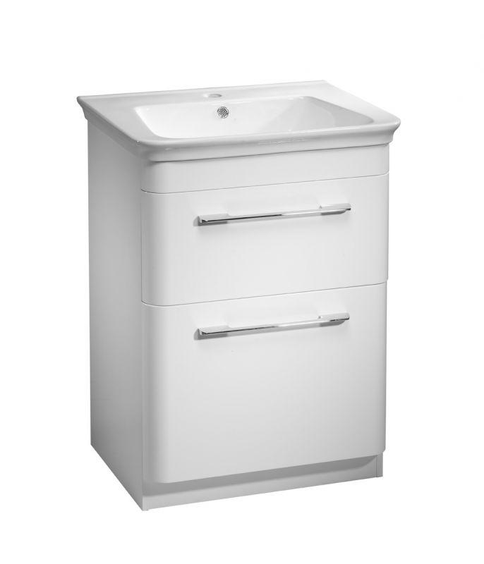

Russell griffiths Posted July 8, 2020 Posted July 8, 2020 I will say what @Nickfromwales is thinking, nope don’t do it it will look poo ??. How about a vanity unit. 1
