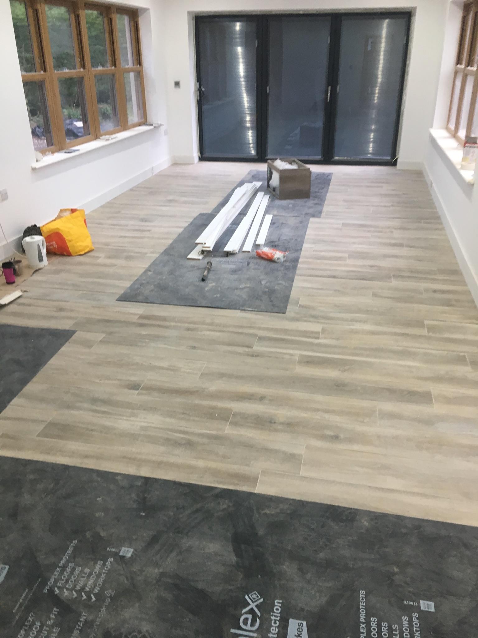

Dan F Posted October 17, 2020 Posted October 17, 2020 We were recommended Domus; fairly big London based setup that markets to architects and interior designers. Prices are in the £95-100/m2 range for a very good quality 14mm limestone effect tile in 1200x600mm. Bit of googling later and becomes obvious that all Domus do is resell Italian tiles under their own brand for a profit. Google image search is great for working out who the actual manufacturer of products marketed in the U.K. actually is! Now I know the original brand, I'm able to find other resellers both here and in Europe and find the best price. Not ordered anything yet, but down to closer to £40-50 already, before requesting any discounts. 1
