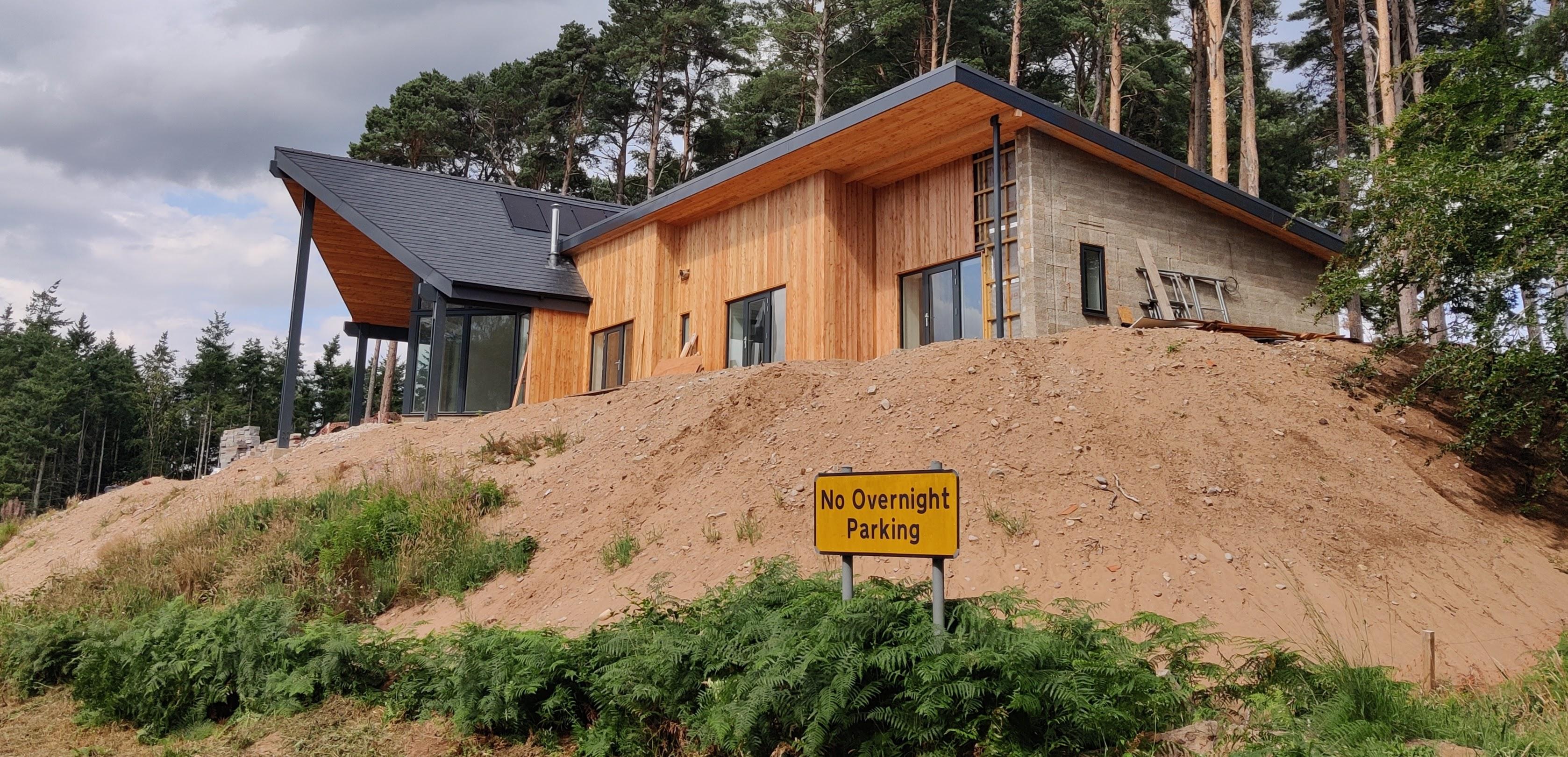

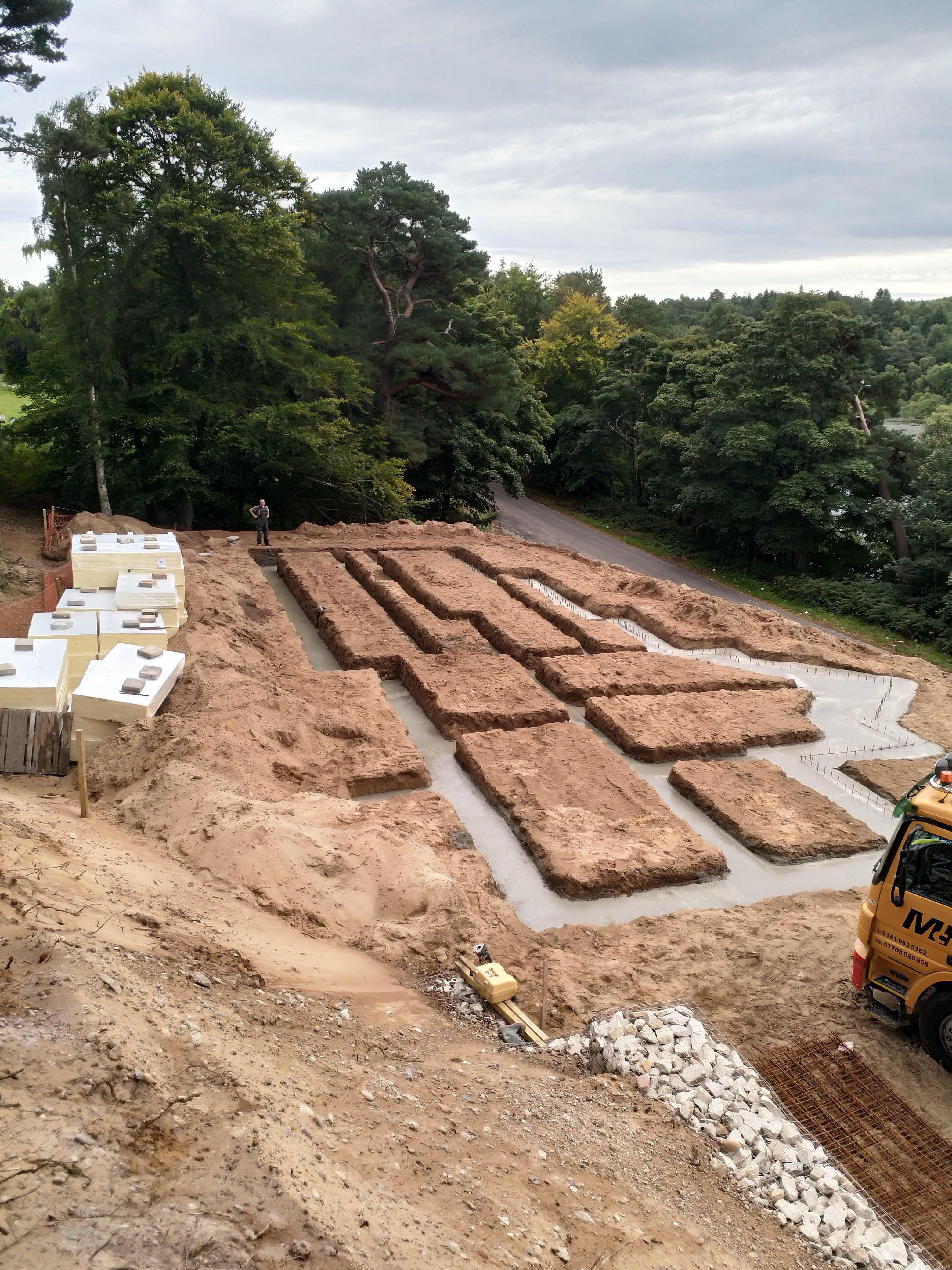

JohnMo Posted October 20, 2021 Author Posted October 20, 2021 Hi update, house now built, just some cladding and slips to do outside - waiting on material. Ended up with triple glazing as suggested, made and installed by Wood Kraft in Elgin. Once the foundations were completed it took another 11 months before we were in. Spec Private water with our own borehole, mains gas, septic treatment plant. Triple glazed throughout MVHR Durisol walls, parge coated internally (sand, cement and lime mix) for airtightness, floor to wall junction with liquid airtightness paint, battons and plasterboard. External a mix of stone slips and Scottish larch. Posi rafter roof structure, battoned and counter battoned 100mm to give 350mm insulation space and then spray foam insulation. Passive House systems Reflective vapour airtightness layer, further battoned and plasterboard. Roof finished in slates and sarnafil EPDM standing seam and 3.1kw PV. Floor slab buildup, strip foundations with 100 to 150mm reinforced C34 concreted slab, 200mm of PIR insulation, UFH pipes throughout, at 300mm spacing, finished 100mm concrete with 70mm insulated perimeter. Work completed by myself Floor insulation UFH All plumbing except gas Durisol block work All battons to wall and roof Internal stud walls Parge coat Vapour control on roof internals (all ceilings match roof line) PV install, except electrical hook up Installed all bathroom s (x3) External cladding and currently doing stone slips. MVHR install Project managing and organising sub contractors who completed - ground work, roof structure, sarnafil and slates, electrical, windows, joiner for plasterboard and second fix joinery, taper for plasterboard. Images are a before and after 2
ProDave Posted October 20, 2021 Posted October 20, 2021 That looked an interesting build, I would liked to have seen more as it progressed. Given the hillside location was that piled foundations?
JohnMo Posted October 20, 2021 Author Posted October 20, 2021 No just strip foundations, but prity big
Tennentslager Posted October 20, 2021 Posted October 20, 2021 First prize to @JohnMo for the most concise thread ever... Fantastic looking house, love that no parking sign or context. Go on now and send some pictures of your view from the house. Smashing!!

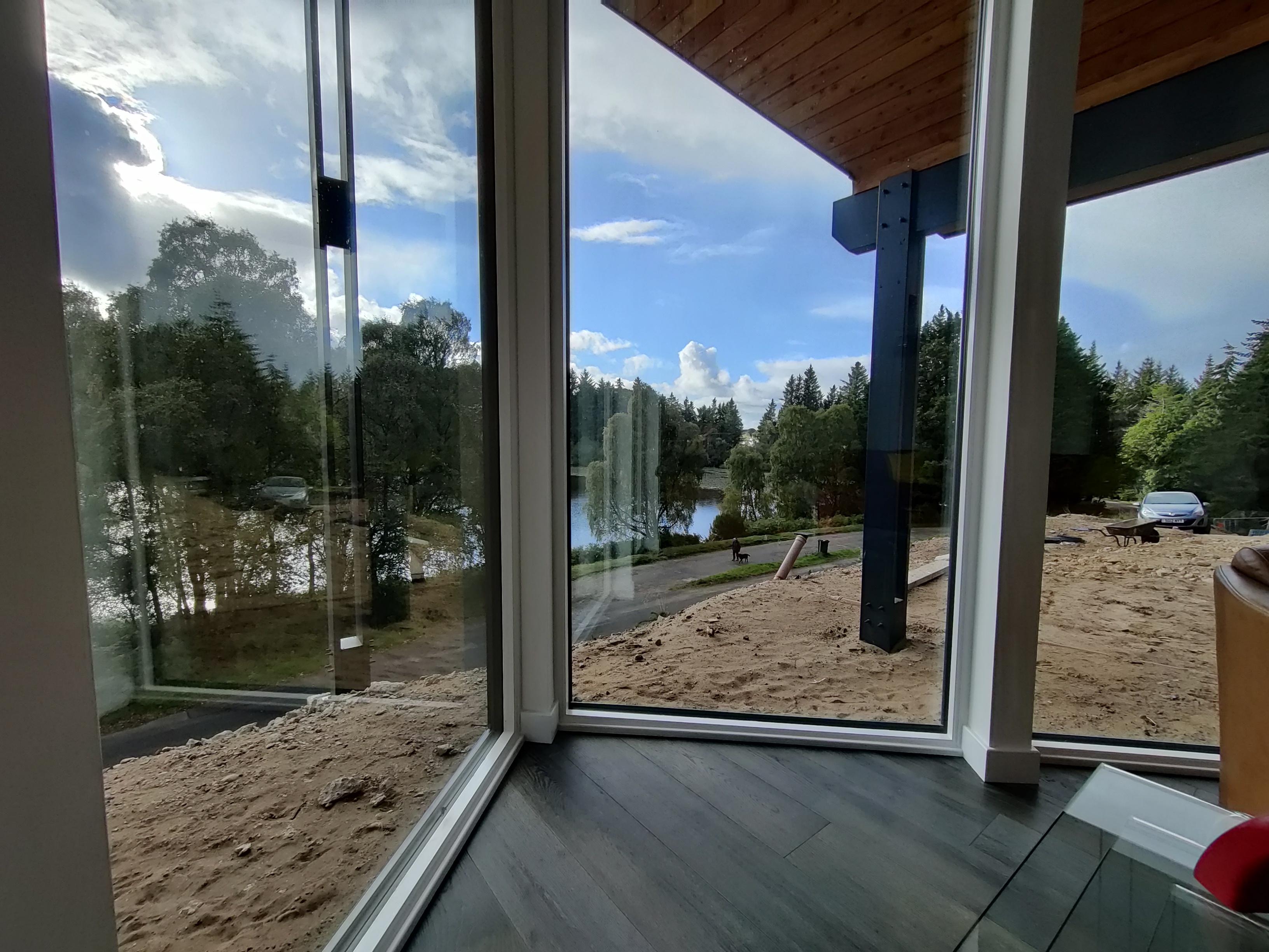

JohnMo Posted October 20, 2021 Author Posted October 20, 2021 View from lounge window, still need decking to be completed 3
Redoctober Posted October 20, 2021 Posted October 20, 2021 3 hours ago, Tennentslager said: First prize to @JohnMo for the most concise thread ever... I have to agree with @Tennentslager but can't help thinking it was a missed opportunity. The build looks impressive and not without its challenges. The amount of work undertaken by @JohnMo himself, is commendable but here's the rub. Whether or not it all went without a hitch, I'm sure the experiences, progress, decision making and supply issues would been useful to the collective also undertaking such a project. In addition, it would also have been useful to know what if any knowledge / advice / tips, one may have picked up from the forum during any given project. Having been one of many who have benefited from the knowledge, skill and advice shared on this forum, I would urge others to do as I did, and that is to share your experiences - This forum should be treated as a "two way street." I'll get my coat!! 1

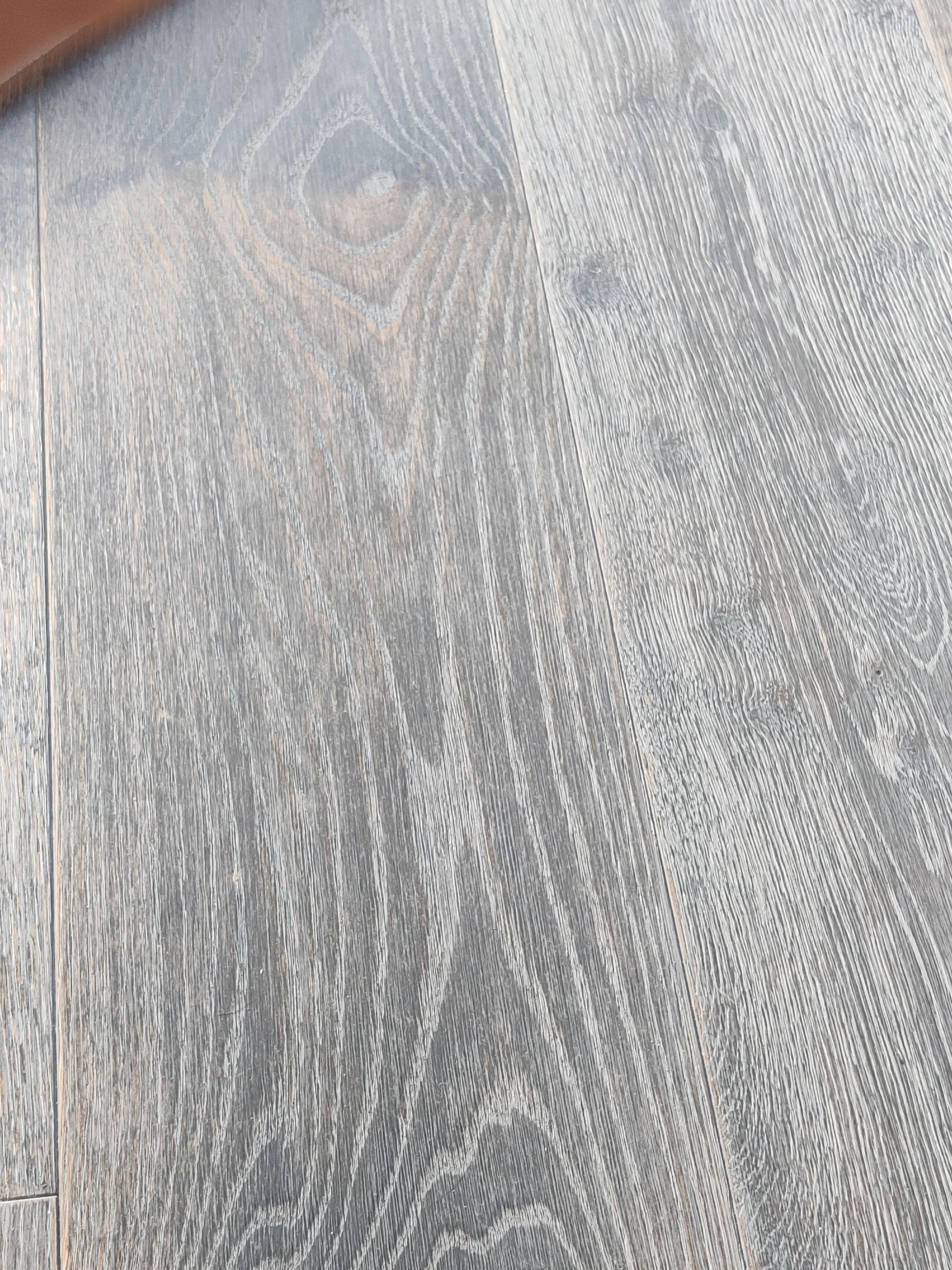

Gone West Posted October 21, 2021 Posted October 21, 2021 18 hours ago, JohnMo said: View from lounge window, still need decking to be completed Well done, great looking house. Do you mind me asking what the grey flooring is in the picture.

JohnMo Posted October 21, 2021 Author Posted October 21, 2021 Gone west, the floor is engineered oak, thát is finished in grey wax. Close image attached. Things I would have done different 1. The walls from strip foundations to DPC, are done in cement blocks, I would do them in durisol blocks - not reliant on someone else and would have had a easier transition to the main walls. 2. Had the roof structure designed around Pozi rafters from day one. 3. We have electric towel rails, would chosen them, before the electrical contractors arrived, as two sockets ended up in the wrong place. 4. Simplified the front wall as all the corners were a real pain to build as just every block has to be cut. 5. I would get the architect to detail door and window thresholds. As this was a steep learning curve. 6. I changed the build method to Durisol block part way through the warrant process, this gave us a 4 month delay. Things I wouldn't change 1. Shopping around for materials, local building merchants are super expensive. Contractors don't really care how much they pay, as they passing the cost to you, plus a percentage. Most contractors had the material free issued from me. 2. Planning well ahead, purchasing PV, Boiler, thermal store, MVHR, at start of first lockdown in clearance sales Things I learned The house ends bigger than you think. Things take longer to do than you think. Be flexible with material and design choices 2 1
