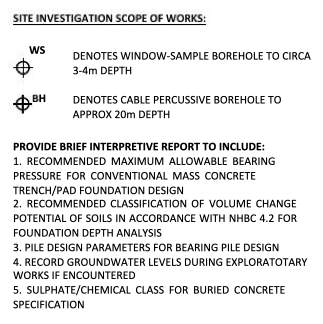

Hilldes Posted May 15, 2020 Posted May 15, 2020 Background is the site has clay of some form and Oak tress in close proximity, so we need a soil investigation. The SE has given this spec to two soil investigation contractors: 4 No. WS. 1 No. BH. One company came in £2K cheaper originally. Until I told the SE that a piling company had mentioned to me that NHBC would require soil investigation for piles to be "around 20m deep". Hence I now have two quotes at £4K+ ☹️ Any views on how I can get what I need from the soil investigation at a reasonable cost?

Hilldes Posted May 15, 2020 Author Posted May 15, 2020 22 minutes ago, Field_of_Dreams said: I have spoken to a pile company and they too were not interested in a report. They said they would just go as deep as they had too. Here is what one of the piling contractors stated: " we require a geotechnical bore hole investigation report for all piled projects to provide factual data of the soil strata to depths exceeding the deepest pile toe depth. The bore hole investigation report will provide the design line criteria for our engineers to correctly design the piles based on the loads required for your project. Our offer is based upon information taken from The British Geological Survey website and our local knowledge of the ground conditions. " Maybe I have the Rolls Royce contractors where I just need a Ford? Will PM you for the piling contractor - thanks.

Declan52 Posted May 16, 2020 Posted May 16, 2020 If your SE will accept the results from dynamic probing then you could do away with the 20m hole and this means the site investigation company could use a much smaller rig which in turn reduces your costs. The smaller rig will easily get to 6-8m giving you samples of what type of clay your sitting on down to this depth. Once that's done they use 1m length rods and basically drive the rod down to whatever depth you need. Unless it's soft clay they won't get to 20m anyway. They count the number of blows it takes for each rod and from this can then work out the what size and depth of piles you would need. But if they require samples of the type of clay at 10/12/15m etc then there ain't any other options. At most a 20t digger isn't going to get you more than 7m and that's going to be a massive hole.
Mr Punter Posted May 16, 2020 Posted May 16, 2020 It may be worth talking to Building Control as they will probably be familiar with the soil type and typical pile type in your area. A Mackintosh type probe would probably reveal if the clay continues to full depth. It is a manual device and would be far cheaper to do. You can use the NHBC depth calculator to work out strip footing depth or whether a specialist foundation is required.

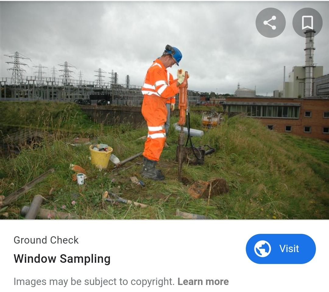

Hilldes Posted May 16, 2020 Author Posted May 16, 2020 (edited) 2 hours ago, Declan52 said: If your SE will accept the results from dynamic probing then you could do away with the 20m hole and this means the site investigation company could use a much smaller rig which in turn reduces your costs. The smaller rig will easily get to 6-8m giving you samples of what type of clay your sitting on down to this depth. Once that's done they use 1m length rods and basically drive the rod down to whatever depth you need. Unless it's soft clay they won't get to 20m anyway. They count the number of blows it takes for each rod and from this can then work out the what size and depth of piles you would need. But if they require samples of the type of clay at 10/12/15m etc then there ain't any other options. At most a 20t digger isn't going to get you more than 7m and that's going to be a massive hole. This was what the £2K (Inc VAT) quote included: "Drilling of 1No. Windowess Sampler Borehole to 10.00m bgl at front of property and 4No. Hand- Held Window Sampler Boreholes to 4.00m bgl across other areas of site. SPTs at 1.00m intervals, SHDP to depth if refused. Geotechnical testing to determine volume change potential and concrete class." ...but that was before I spooked the SE with the alleged NHBC requirement for 20m depth. I'm going to go back to the SE and say forget the warranty provider requirement for 20m as we have no evidence this will be a constraint. The mind boggles at what a "Hand- Held Window Sampler Boreholes to 4.00m bgl" might be. Got this picture of a man with an SDS drill and a 4m long drill bit ? Edited May 16, 2020 by Hilldes
Declan52 Posted May 16, 2020 Posted May 16, 2020 It's a big Jack hammer that drives the hollow tube into the ground using a hydraulic pump. You then take off the hammer and attach a lift and clamp it onto the rods and pull it up 800mm at a time. Pretty standard operation.
Declan52 Posted May 16, 2020 Posted May 16, 2020 If you Google hand held window sampler you get a pic of me having a fun day at a power station in Derry. 1

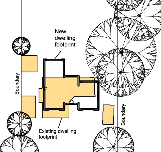

PeterW Posted May 16, 2020 Posted May 16, 2020 Seriously consider an insulated raft at this point. You would need to do some ground investigation but not to the depths you’re talking here. Also, a 20m Oak will have a canopy diameter of about 15m or so - are you building under the edge of the canopy or are you measuring from some other point ..??
Hilldes Posted May 16, 2020 Author Posted May 16, 2020 (edited) 2 hours ago, PeterW said: Seriously consider an insulated raft at this point. You would need to do some ground investigation but not to the depths you’re talking here. Also, a 20m Oak will have a canopy diameter of about 15m or so - are you building under the edge of the canopy or are you measuring from some other point ..?? Thanks @PeterW Here is a plan showing proximity of trees.. Most of the larger trees are 20m high. Canopy diameter is approx 18m for the larger tree shown to the right who's canopy extends to the existing house corner. Would an insulated raft be an option even with the 'worst' type of clay? Edited May 16, 2020 by Hilldes
Hilldes Posted May 16, 2020 Author Posted May 16, 2020 Thanks @Herbie costs look similar. Thanks for the image @Declan52 - just how I pictured it.
PeterW Posted May 16, 2020 Posted May 16, 2020 Sorry but that makes your trees 9m from the foundation not 6m..?? And yes, insulated raft can be used on lots of different surfaces.
Hilldes Posted May 17, 2020 Author Posted May 17, 2020 13 hours ago, PeterW said: Sorry but that makes your trees 9m from the foundation not 6m..?? @PeterW Smaller Oak tree is 6m for corner of new wall, larger Oak tree is 10m from same corner. Thanks, I'll do some more reading on insulated rafts.

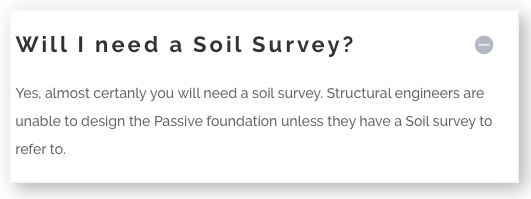

Hilldes Posted May 17, 2020 Author Posted May 17, 2020 @PeterW From Touchwood website, pros and cons of insulated rafts: "Not suitable for certain ground types – shrinkable clay for example" I can see no mention of such limitations on other sites. MBC state this, so looks like the soil investigation will be required for all foundation types...
Dreadnaught Posted May 17, 2020 Posted May 17, 2020 (edited) 8 minutes ago, Hilldes said: "Not suitable for certain ground types – shrinkable clay for example" I am having an insulated raft over shrinkable clay, albeit with screw piles. It is currently being designed for me by a specialist engineer in Ireland. Edited to add: oh, and I inherited a soil survey from the seller of the plot, and everyone concerned with the foundations has asked to see it. Edited May 17, 2020 by Dreadnaught
Hilldes Posted May 17, 2020 Author Posted May 17, 2020 From the Kore Design guide: "Suitable for all ground conditions..." "Great care also needs to be taken when building on shrink- able clays (prevalent in parts of the UK). These clays also expand and shrink with changing moisture contents (not to the same extent as top soils) and are greatly influenced by the presence of trees in the vicinity of the building. Foun- dations in these clays generally need to be taken to greater depths than normal to minimise variations in moisture con- tent over time that will cause clays to shrink and expand, thus causing the foundations and building to move, possibly causing damage. In some circumstances, piled foundations may be required or be the most economical way to avoid ex- cessive movement in the foundations. Piles for lightweight structures such as houses, do not need to be large, but they transfer the superimposed loads to a much greater depth, where moisture contents are practically constant and thus shrinkage and expansion of the clays is not an issue. An al- ternative to piling that is also worth considering is the use of Vibro Stone Columns. These are columns of stone that are vibrated into the ground, consolidating the ground around them and providing columns of highly compacted stone that transfer the superimposed loads to greater depths, as with piles. Each option outlined above is compatible with the KORE Passive Slab. In shrinkable clays, a suitably qualified engineer should be consulted to advice on the most appro- priate foundation solution. Further information on shrink- able clays can be found in Building Research Establishment (BRE) Digests No’s 240, 241 and 242." 10 minutes ago, Dreadnaught said: I am having an insulated raft over shrinkable clay, albeit with screw piles. It is currently being designed for me by a specialist engineer in Ireland. Thanks @Dreadnaught I was kind of hoping that an insulated raft would remove the need for piles, but perhaps not.
