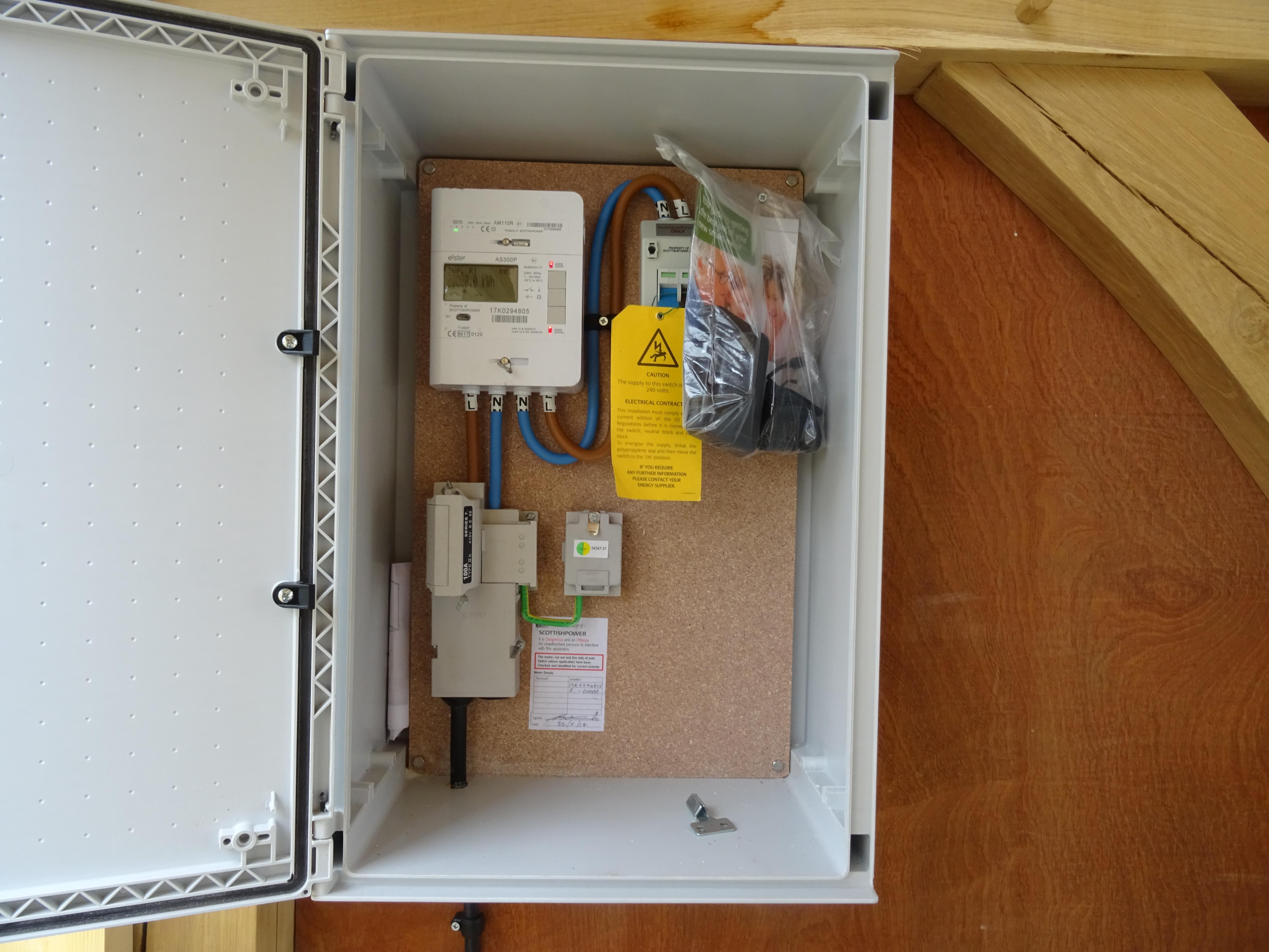

MortarThePoint Posted May 14, 2020 Author Share Posted May 14, 2020 19 minutes ago, Redoctober said: Hi - a little late to this thread but for my two pennies worth, we stuck ours in the car port / garage whatever you wish to call it. See image and or my blog for details. SP Energy supplied up to 50 metres of cable all within the connection costs they charged, which was about £900 job done. We used best part of that 50 metre run to take the cable from the pole into the carport. This was all done ahead of the TF being erected and allowed the Trades to tap into the power supply as and when. The meter is held within a proper approved box and we have had no trouble with it since. It keeps it out of the way and accessible . Looks good and certainly got your money's worth on the connection ? Link to comment Share on other sites More sharing options...

ProDave Posted July 26, 2020 Share Posted July 26, 2020 There is no rule saying your consumer unit can only be 3 metres from the supply head. What there is, is a DNO rule that you can only rely on their supply head fuse for cable protection for a run of up to 3 metres from the meter to the consumer unit. If you want your consumer unit more than 3 metres away, you fit your own switch fuse with an 80A fuse in it, in the meter box, and then your cable can be any length you want it. 2 1 Link to comment Share on other sites More sharing options...
joe90 Posted July 26, 2020 Share Posted July 26, 2020 1 hour ago, ProDave said: DNO rule that you can only rely on their supply head fuse for cable protection for a run of up to 3 metres from the meter to the consumer unit. If you want your consumer unit more than 3 metres away, you fit your own switch fuse with an 80A fuse in it, in the meter box, and then your cable can be any length you want it. They didn’t do that with mine, if I had known I would have liked the extra protection . Link to comment Share on other sites More sharing options...
Redoctober Posted July 26, 2020 Share Posted July 26, 2020 4 hours ago, ProDave said: There is no rule saying your consumer unit can only be 3 metres from the supply head. What there is, is a DNO rule that you can only rely on their supply head fuse for cable protection for a run of up to 3 metres from the meter to the consumer unit. If you want your consumer unit more than 3 metres away, you fit your own switch fuse with an 80A fuse in it, in the meter box, and then your cable can be any length you want it. Presumably, this is what I have here.? Link to comment Share on other sites More sharing options...
ProDave Posted July 26, 2020 Share Posted July 26, 2020 No, that's just an isolating switch. But you have space in the bottom right of the meter box to put one of these https://www.tlc-direct.co.uk/Products/CGMSF100.html 1 Link to comment Share on other sites More sharing options...
PeterW Posted July 26, 2020 Share Posted July 26, 2020 13 minutes ago, Redoctober said: Presumably, this is what I have here.? Can’t tell but that is just a switch behind the yellow tag not a fused switch ..? 1 Link to comment Share on other sites More sharing options...
Redoctober Posted July 26, 2020 Share Posted July 26, 2020 @PeterW and @ProDave - yes sorry guys, you can always rely on me to confuse things - The photo above was taken PRIOR to the electrician doing his fixes. The photo below shows the finished article together with whatever the fuse box that is required having been fitted. Thanks. Link to comment Share on other sites More sharing options...
ProDave Posted July 26, 2020 Share Posted July 26, 2020 Yes that's a different switch fuse in a metal box. Where do the tails go that exit the centre white cable gland in the bottom of the meter box? Link to comment Share on other sites More sharing options...
Redoctober Posted July 26, 2020 Share Posted July 26, 2020 Just now, ProDave said: Yes that's a different switch fuse in a metal box. Where do the tails go that exit the centre white cable gland in the bottom of the meter box? They feed into another similar looking box just to the outside of the meter box, which the shed power and lights also run from. For completeness her is the overall picture ! 1 Link to comment Share on other sites More sharing options...

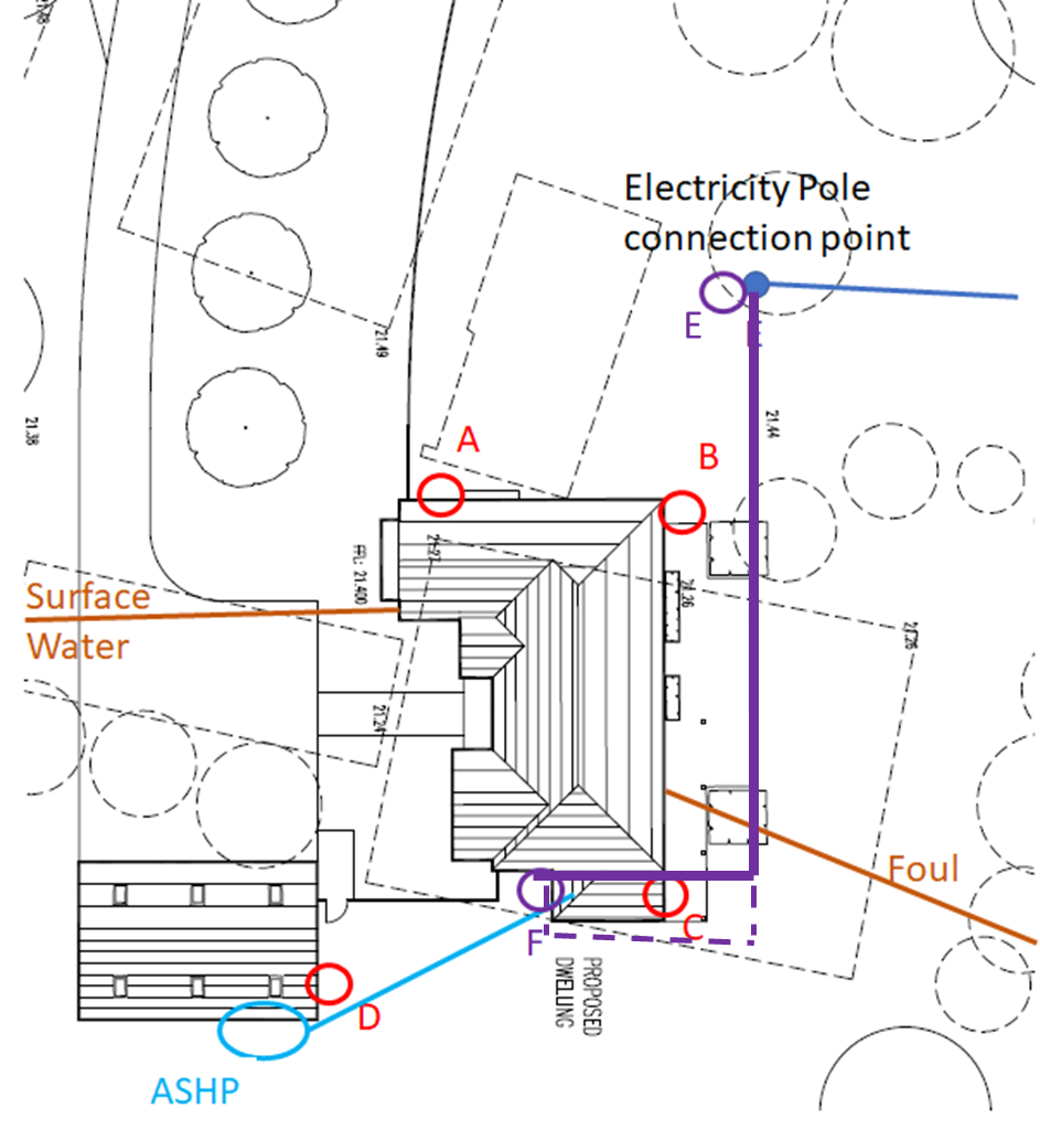

MortarThePoint Posted March 14, 2022 Author Share Posted March 14, 2022 (edited) This looks like it's going to get a bit tricky unfortunately. I decided on Plan F on the front of the house, but that's about 45m from the pole. I didn't check that with UKPN at the time D'Oh 🙄 UKPN say they have a Small Connections limit of 43m (inc. 3m for pole), so I'm too far and need t go yo the Projects Team, gulp / cha-ching! The price would be £2100 for a 3-phase connection by the Small Connections team plus £17/m for cable, so quite envious of @Redoctober's connection all for £900. Heaven knows what the Project Team cost will look like. [NB: the 3-phase side of it was only adding ~£300]. The about 45m is routing along the back of the house and then around the Utility and putting the meter box in the least impactful position and close to the CU. Not going round the Utility (Plan C) would make it around 36m but we'd walk past it every day. Kind have wish I had gone @ProDave 's route in 2019 when I had a 3-phase connection removed for demolition. One question I had on that was voltage drop. Having a log run of SWA on the customer side of the meter means the customer pays for the voltage drop doesn't it? That could put the bill up by up to 5% couldn't it (thinking main load will be ASHP). Edited March 14, 2022 by MortarThePoint Link to comment Share on other sites More sharing options...
Redoctober Posted March 15, 2022 Share Posted March 15, 2022 Hi @MortarThePoint -" , so quite envious of @Redoctober's connection all for £900." Yes it did wok out well for us as I too thought we would have to go into the "expensive area" due to the distances involved. I hope all works out for you and the increased costs are not too crippling. Link to comment Share on other sites More sharing options...
andy Posted March 15, 2022 Share Posted March 15, 2022 11 minutes ago, Redoctober said: Hi @MortarThePoint -" , so quite envious of @Redoctober's connection all for £900." Yes it did wok out well for us as I too thought we would have to go into the "expensive area" due to the distances involved. I hope all works out for you and the increased costs are not too crippling. I mustn't grumble at the £400 I was charged for a brand new 3 phase connection into my green box then really... 1 Link to comment Share on other sites More sharing options...
MortarThePoint Posted March 18, 2022 Author Share Posted March 18, 2022 The 43m limit is a real nuisance and wish I'd know it before. I've measured on site more accurately and it works out to be very close to 40m to go along the back of the house and round the end of it. That comes right up against the 43m limit allowing 3m for the pole. I'm wondering about drilling a hole into the sub floor void to route the cable under the end of the house and save about 6m of length. It will be tough to get the height just right and also to feed it through. Any advice? I've shown this adapted route in solid purple below. Would have been easy to have built a 6m length of soil pipe in when the foundation blockwork was being done but that ship has sailed. The ground under the void is 675mm below DPC, so 525mm below ground level. I'll check, but think 450mm would be deep enough below the patio, so 500mm below ground level would be fine. I'd be OK with location C if I can have an internal meter, so I might try my luck there. Link to comment Share on other sites More sharing options...
PeterW Posted March 18, 2022 Share Posted March 18, 2022 Build a kiosk 3m from the pole, get the meter terminated there and then run your own 25mm armoured as you’re not limited to 43m. Link to comment Share on other sites More sharing options...
dpmiller Posted March 19, 2022 Share Posted March 19, 2022 Some DNOs (NIE) prefer a front corner position for the meter to assist the readers, you'd have to fight pretty hard to get anything other than A unless you go for a kiosk. Link to comment Share on other sites More sharing options...
PeterW Posted March 19, 2022 Share Posted March 19, 2022 11 hours ago, MortarThePoint said: I'm wondering about drilling a hole into the sub floor void to route the cable under the end of the house and save about 6m of length. Unlikely any DNO will let you do this as the cable would be unprotected and they need access to their assets without having to cause undue damage to a property. As previous - kiosk and then it’s your sparkies issues to resolve. Link to comment Share on other sites More sharing options...
