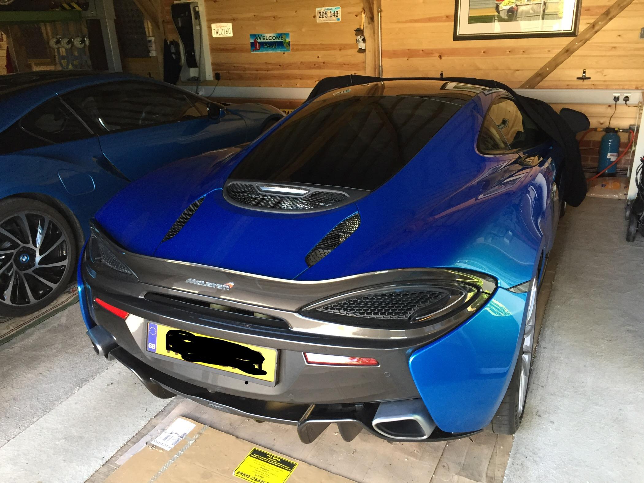

I popped round my friends house today to borrow a block and tackle to drag my heavy bath up the stairs. This was in his garage, that’s my fantasy!

@dpmiller No, its sat where his old mini used to be I think, that's been relegated to the other, less posh, garage. That's a 4 bay garage with a fifth car up on the lift (left of the picture). I think he's got 8 cars altogether, all of them a bit special and worth a bob or two.
That garage is cleaner and more inviting than many of the houses I work in.
