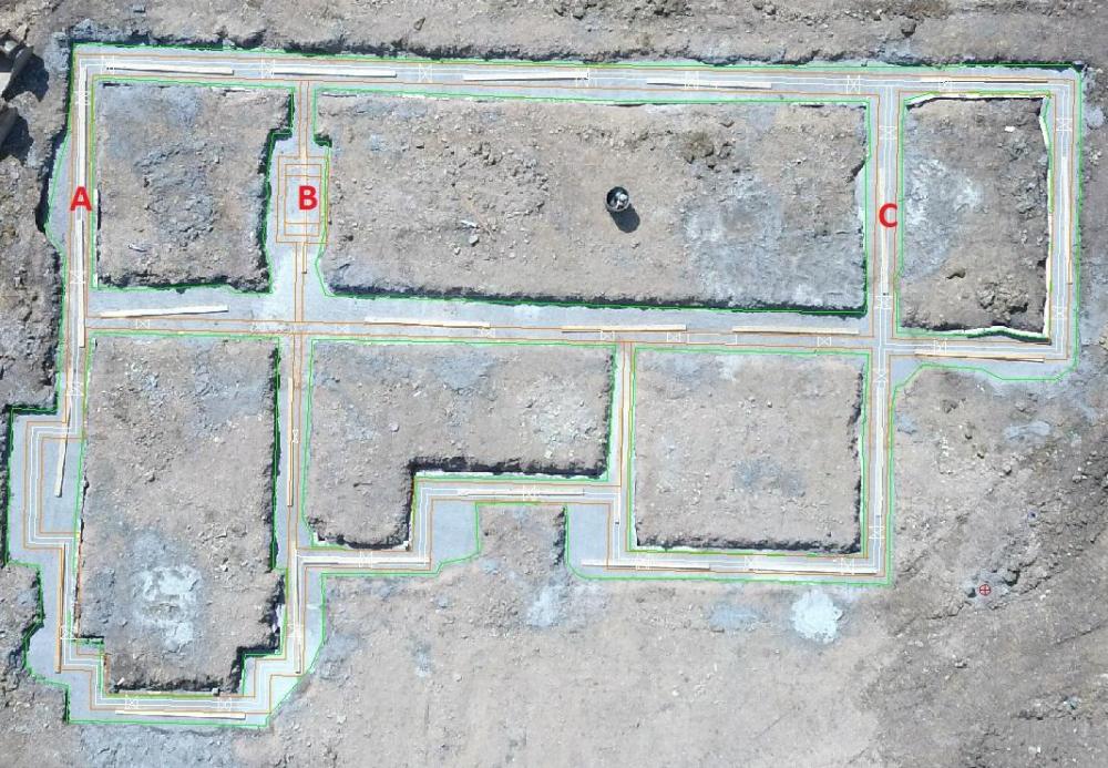

MortarThePoint Posted May 9, 2020 Share Posted May 9, 2020 Separate to a discussion on tolerances, I wanted to start a new thread focused on a possible issue with how my foundations have been positioned. I used a tape measure to measure lines the groundworks team had sprayed out lines that represented middle of the trenches and they agreed with the drawings to within what I thought was an acceptable amount typically less 30mm difference. Since the trenches have been dug and poured it is hard to measure dimensions, but I am sure that one of the easiest to measure dimensions is out by 200mm. The wife's face was a picture when I explained to her that the kitchen had just shrunk by 200mm though it's actually the whole of one side of the house. Worse, we are preordering precast flooring that needs to fit. This is a bit of a worry. I measured centre of trench to centre of trench using a tape measure in the three positions (along A, B and C) and all three were under by ~200mm. I sent the drone up and I think this image captures the problem. The orange lines superimposed are the walls construction drawing. I laid some timber in the trenches to have reference dimensions. Now I'm hoping the bottom left hand corner is due to lens distortion so let's not go there yet. I don't have an EDM or anything to do better 2D measurements, but those three 1D measurements have me worried enough. With the rear wall (top of frame) centred on its trench the wall going left to right along the centre line is off centre of its trench. It just seems like that whole trench is out of place. That trench is specified to be 850mm wide and have a very structural wall on it which is 215mm wide. If the blockwork was laid out ignoring the trench misplacement it would look like the image below, 200mm off centre (blockwork in blue on top of foundation concrete in grey). That level of off centre looks alarming to me. What do people think? Am I rightly worried or does everyone have walls well of foundation centre? Some comfort and cold beer required. Link to comment Share on other sites More sharing options...

ProDave Posted May 9, 2020 Share Posted May 9, 2020 But how did you get 200mm out if both you and the builder measured the ground marks? As well as marking the centres of each trench, did you not also set up profiles that mark the inner and outer edge of each wall? These are used as a sanity check for digging the trenches and for setting out when you start building the walls. Link to comment Share on other sites More sharing options...

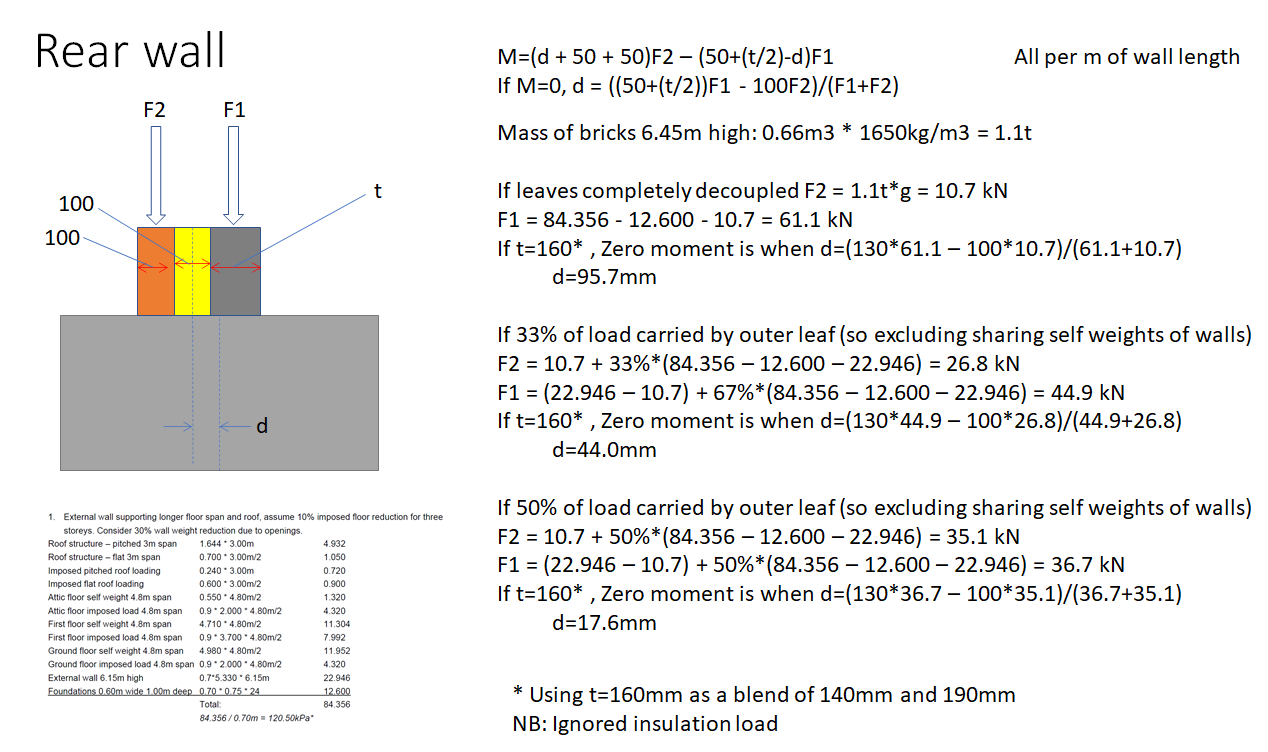

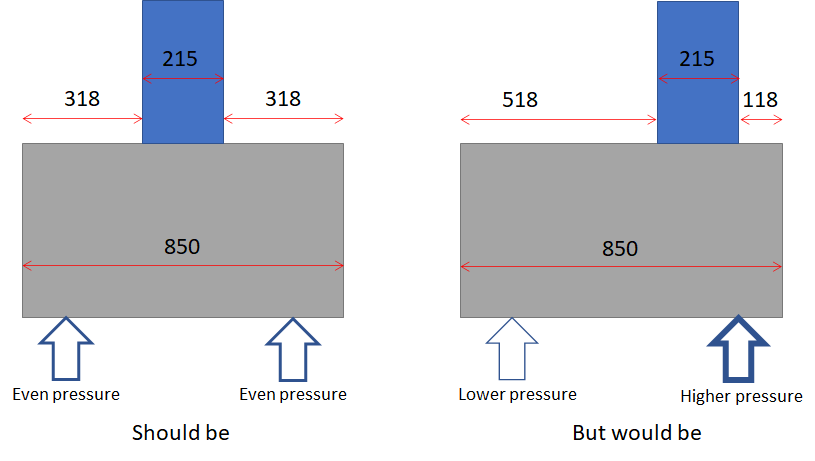

MortarThePoint Posted May 9, 2020 Author Share Posted May 9, 2020 3 minutes ago, Declan52 said: Won't matter any difference. Built walls right out to the edge before. That's why you build on a wide Foundation as it so easy to dig slightly off line. Thanks, this is good to hear. I worry about it being off centre putting a moment on that part of the foundation that effectively increases the pressure below one side of the foundation section. I expect I'll need to check with the Structural Engineer. Link to comment Share on other sites More sharing options...
MortarThePoint Posted May 9, 2020 Author Share Posted May 9, 2020 (edited) 11 minutes ago, ProDave said: But how did you get 200mm out if both you and the builder measured the ground marks? As well as marking the centres of each trench, did you not also set up profiles that mark the inner and outer edge of each wall? These are used as a sanity check for digging the trenches and for setting out when you start building the walls. They clearly didn't dig centred on the line. They used a 600mm bucket and I guess they may have widened only on one side. That's the only way I can guess they have done it. No profiles unfortunately. Edited May 9, 2020 by MortarThePoint Link to comment Share on other sites More sharing options...
JFDIY Posted May 9, 2020 Share Posted May 9, 2020 A bit of tweaking of the position here and there should get it mostly right. i.e move the whole footprint up and rotate it clockwise slightly. At least it's off towards the stronger side where you have more walls forming buttresses to the foundation. Not worth worrying about really I'd say, at least all the walls will be on the foundation! - I've heard of people having to build right on the edge due to incorrect set-out. Link to comment Share on other sites More sharing options...
Miek Posted May 10, 2020 Share Posted May 10, 2020 If you think about the actual load on the foundation's it's very very small per unit area. The founds are massively overkill in my view, nowt to worry about, and it will all be hidden anyway. 2 Link to comment Share on other sites More sharing options...

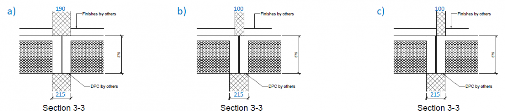

MortarThePoint Posted May 10, 2020 Author Share Posted May 10, 2020 Well I had lots of time to think of some ideas overnight: 1) It can be off foundation centre and that's fine to a limit which I'll find out from the Structural Engineer. 2) The exterior wall at the rear (top of frame) could be pushed back a bit. Currently the wall to foundation is centred on the cavity. Below DPC, the inner leaf is 190mm blockwork and the outer is 100mm blockwork. If that wall had its overall footprint centred then that is a 45mm shift. Due to the walls higher up being of thinner blockwork, the cavity side of the 190mm blockwork will be more highly loaded, but I'd hope that over the two courses below DPC that effect would disappear(?) 3) The inner leaf of a cavity wall carries most of the load. I know that the wider you go with the cavity the less structural the outer leaf becomes, but I don't have any load sharing proportions to back that up. My cavities are to be 100mm. *IF* the outer leaf is only supporting its own weight and the inner leaf is supporting its own weight plus all the floors and roof then you could arguably centre the load on that basis and it yields 95mm. If the outer leaf takes 1/3 and the inner leaf 2/3 then its about 45mm. Arguably double those shifts would yield the same moment on the foundations as was originally designed in, just in the outward rather than inward direction. 4) Use thinner stronger blocks. The spine wall running the mid-length of the house is designed as 215mm/10.4N blockwork below DPC and 190mm/10.4N above DPC (a). If that 190mm/10.4N was thinned to 100mm/21N, but still centred on the lower blockwork, it would yield half the change in block width, so 45mm (b). They would be special order blocks and the wall would be more vulnerable to lateral loads, but there may be something there. Even 140mm/15N blocks offcentre from the lower blockwork could give 40mm or more. Thinner blockwork doesn't help the first floor as that's already 100mm, but could help on the ground floor. Could go as far as 100mm/21N shifted over 100mm (c) but that feels iffy. 5) Get the groundworks guys to dig and fill next to the misplaced section of foundation, or at least some piers at right angles. I can only imagine their reaction but it is their mistake. I'll see how they navigate it when they measure up for the below DPC blockwork as they are doing that too. I haven't discussed the misplaced foundation section with them yet and want them to kind of work it out for themselves rather than have me point it out. Hopefully some mixture of the first 4 will get things back on track. Link to comment Share on other sites More sharing options...

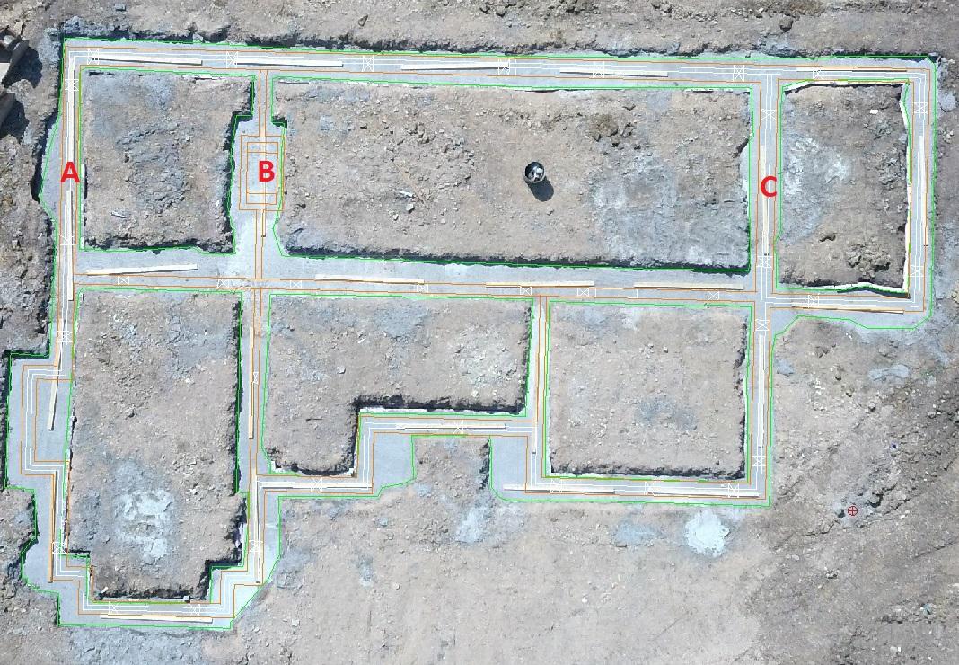

MortarThePoint Posted May 19, 2020 Author Share Posted May 19, 2020 Well a bit of an update here. The Structural Engineer has said he isn't happy about the central wall misalignment but has kept me waiting for about a week now to do calculations as to how much offset is OK. The groundworks guys did day 2 of blockwork yesterday and that looked to be fitting nicely by eye. I went out this morning and they have taken it back down. They checked yesterday's work with the total station and realised they had made a mistake with a mark that meant a wall went 40mm off target (OK one end, straight, but 90 degrees 13 minutes to the other wall). They have now identified that the front area of foundation is out of shape and they are talking about digging next to it and pouring more foundation. 450mm width if just butting up or 600mm if doweled. I prefer the sound of doweled. To their credit they have worked all this out themselves and corrected their work, rather than coming to me and asking if it is OK, which gives me some confidence. 1 Link to comment Share on other sites More sharing options...
