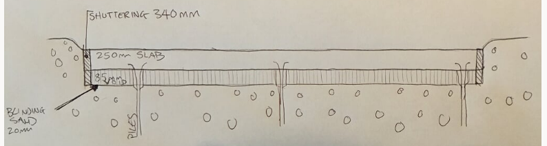

Hi All,
Leaving aside the footings themselves (which might be piles, steel screws or concrete trenches), I need to construct two 5m x13m raft slabs as shown in this sketch:
From the top down it is:
250mm poured concrete slab with A393 mesh top and bottom, and rebar to SEs design.
85mm clayboard, which will collapse leaving 75mm void.
20mm blinding sand used just to ensure a level base to lay the clayboard on.
I will be need shuttering / formwork to create the edges as shown.
I have fallen out of love with local groundworks firms who, based on their inability to even quote for work when they say they will, I am not thrilled about employing for anything that matters. Like this.
Question is, can an amateur like me create the above? I'm already excavating the area. How difficult is....
Creating level formwork to the edges. What would I use? Timber? Hired road planes?
Getting the sand base level?
Installing the clayboard?
Placing the mesh and rebar in?
Accepting the concrete when it arrives?
Cheers
It's all do-able, depends on how much you want to take on.
Main thing you'll need is a decent laser level and receiver to save time getting everything level. Straight timbers and stakes work fine for forming the edges, as will hired steel forms. Benefit of timber is you can do it at your own pace and not be on the hook for weekly costs.
If you use a mix on site concrete firm you can dictate the pace and you only pay for what you actually use.

if You are supposed to have a 20mm layer of sand is you excavated area that good or will you need something else to get the levels right.
It is all very doable on your own except laying the concrete, you will need lots of help for this, moving the sheets will be very awkward on your own they are very heavy.

All good and valid statements made by others.
I would however say that the bearing integrity from (as you say) concrete trenches, screw piles or concrete piles will add complexity each in their own right and how you integrate in to your raft slab. So it’s critical you review and understand each option and who’s going to do what.
piles will in my experience need specific rebar tied into your raft and not just placing standard mesh alone.
if you go for concrete trenches, they are likely to be 1m deep for BCO and if the conc strip is say 350 thick you’ll need trench blocks or other method to reach up to and integrate your raft.
a raft as you refer is rather basic and doable if your hands on and have done some research on principals of how to do it.  However, ordinarily a basic thing like mesh panels might be bigger and heavier than you might expect.
Btw, I would doubt that 20mm sand would level out a reduced dig of 13m or so and you ought to be considering a compacted hardcore base and DPM over your levelling sand.  Hopefully your SE is doing a detailed design for you.  Get that right and then analyse how you are going to undertake each element.
Cheers. What sort of depth would you advise?

@Tony Kan insulated raft can easily be done pretty much solo. Areas where a bit of help is good are setting your profiles out - using a tape measure solo is a long and tricky process, much easier with two. The concrete - I had 3 blokes turn up to do mine, after watching them I am glad I didn't try it myself. The finish wasnt laser flat but flat enough that laying floor finishes should be fine.
I had a mix of A393 and A292 mesh in mine. Thankfully the widest A393 strip was 600mm so I could move it myself - a full sheet is 70kg, not too heavy but the shear size makes it extremely difficult to move solo. A292 is about 40kg so even full sheets can be moved solo (it does get snagged etc but doable).
If you can use an insulated raft rather than piles it should be doable. Piles I have no experience of, but if you have a good set of drawings showing how all the steel ties together I'm not sure why you couldn't tackle it. Cutting steel and placing it is easy - just keep checking the drawing. Another mistake i made between layers was to plough on to the top layer assuming A393 was top and bottom in the thickened strips - it was actually A292, by the time i paused to check I'd cut all my A292!! A lot of unnecessary work created having to lap and tie them all back together.
I just used a 9" grinder to cut the steel and a potato stack tie twist to do the ties. Dont follow this approach, there are thousands of ties and it takes ages, hire one if those hand held tie twist machines, I wish I had - it can be used to tie the UFH pipe too.
