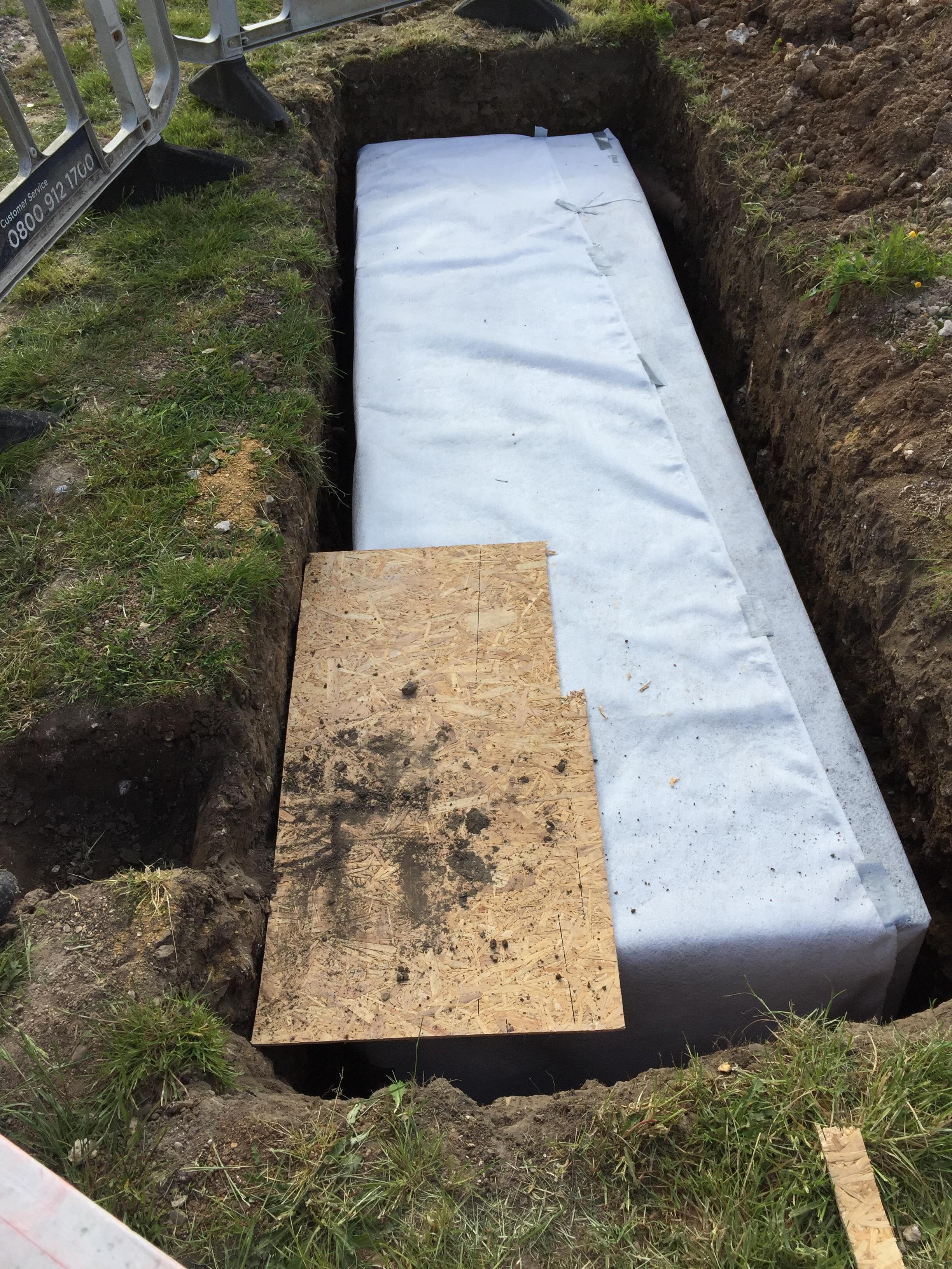

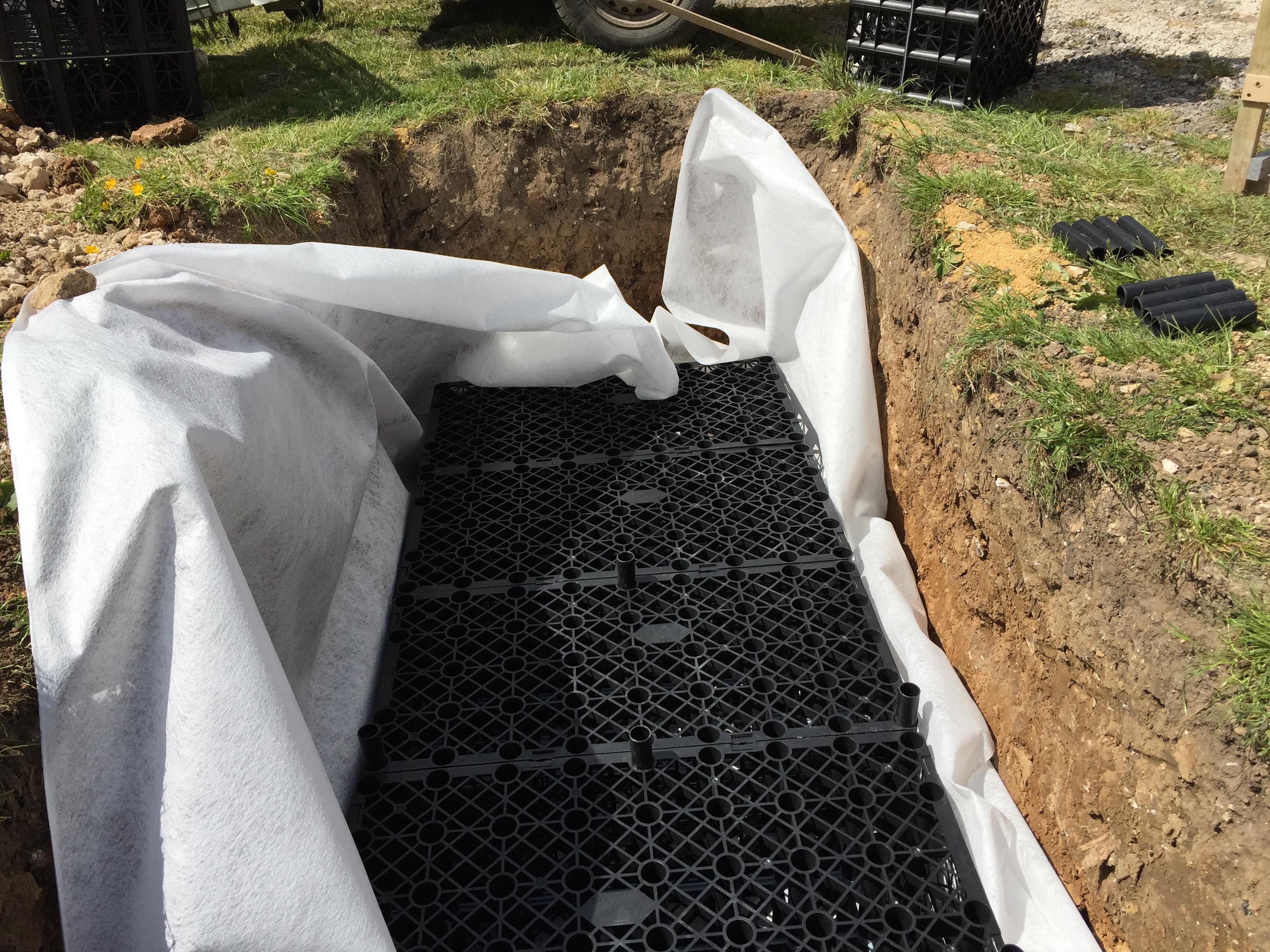

Russdl Posted May 14, 2020 Author Posted May 14, 2020 (edited) So I dug a big hole (well, my grave digger mate did) and dropped in 14 crates which equated to 2.8m3. The invert level into these crates is about 150mm below the top of the crates, maybe a bit more, so that removes .5 - .75m3 of storage so I've effectively got around 2.2m3 of soakaway. The BCO just wanted to see photos but at the last minute changed his mind and wanted to see the crates in situ. I was mildly concerned that he was going to change his mind and say it needed to be bigger so awaited his visit with a bit of apprehension. He turned up yesterday. He liked the cladding on our house and took some photos. He liked the (maybe) temporary name I'd given to our slightly contentious house and took a photo. He had quick look in the hole, took a photo of the membrane wrapped soakaway crates and drove off. Perfect. Edited May 15, 2020 by Russdl Pictures added 2

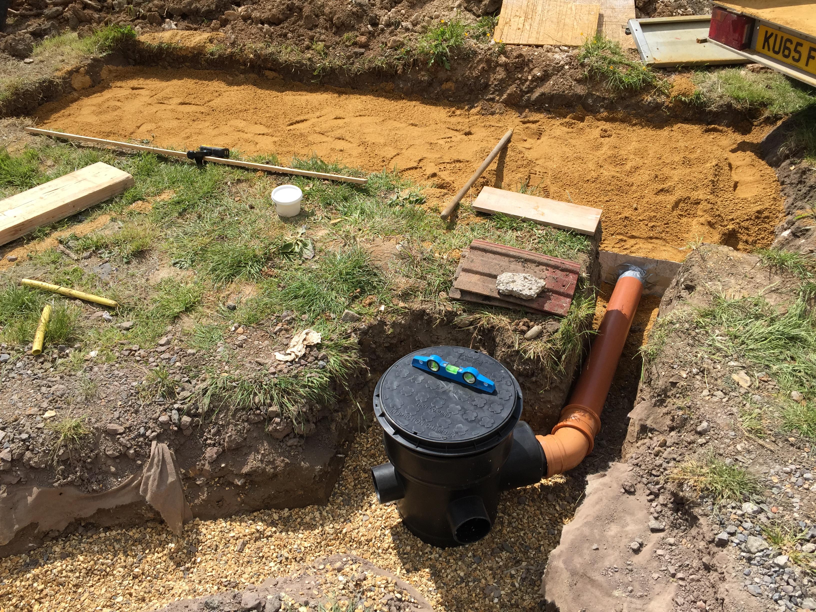

Russdl Posted May 23, 2020 Author Posted May 23, 2020 It seems that I have a ‘little mind’ because this ‘little thing’ pleased me no end! I’ve been itching for it to rain since I put the silt trap in, surely there are better things for me to be getting on with! C1C99E6F-B98A-45DF-9887-6046077BD851.MOV 2
