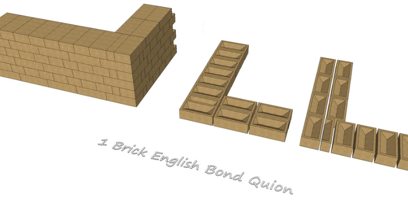

epsilonGreedy Posted April 28, 2020 Share Posted April 28, 2020 One extra aesthetic tip which applies to English Bond but not sure about Flemish. At the corners of English ( + Garden Wall ) the pseudo headers should step up or down a course as would happen in a genuine double brick wall. Link to comment Share on other sites More sharing options...

MortarThePoint Posted April 28, 2020 Author Share Posted April 28, 2020 6 minutes ago, epsilonGreedy said: One extra aesthetic tip which applies to English Bond but not sure about Flemish. At the corners of English ( + Garden Wall ) the pseudo headers should step up or down a course as would happen in a genuine double brick wall. I don't understand this, are you able to share a picture? Link to comment Share on other sites More sharing options...

Russell griffiths Posted April 28, 2020 Share Posted April 28, 2020 40 minutes ago, epsilonGreedy said: One extra aesthetic tip which applies to English Bond but not sure about Flemish. At the corners of English ( + Garden Wall ) the pseudo headers should step up or down a course as would happen in a genuine double brick wall. That would happen whether it be double brick or single they change course as they go around the corner. Link to comment Share on other sites More sharing options...

MortarThePoint Posted April 28, 2020 Author Share Posted April 28, 2020 8 minutes ago, Russell griffiths said: That would happen whether it be double brick or single they change course as they go around the corner. I follow you, like this: With Flemish you put a stretcher next to the queen closer. Face 1 Corner Face 2 [Stretcher-][Head][Stretcher-][Q][Head] | [Stretcher-][Head][Stretcher-][Head] [Head][Stretcher-][Head][Stretcher-] | [Head][Q][Stretcher-][Head][Stretcher-] [Stretcher-][Head][Stretcher-][Q][Head] | [Stretcher-][Head][Stretcher-][Head] Where's my daughter's Lego when I need it? Link to comment Share on other sites More sharing options...
Brickie Posted April 28, 2020 Share Posted April 28, 2020 1 hour ago, epsilonGreedy said: One extra aesthetic tip which applies to English Bond but not sure about Flemish. At the corners of English ( + Garden Wall ) the pseudo headers should step up or down a course as would happen in a genuine double brick wall. Known as ‘change direction,change bond.’ Applies to the garden wall variety as well-the header courses should be equidistant to each other on adjacent planes. Link to comment Share on other sites More sharing options...
epsilonGreedy Posted April 28, 2020 Share Posted April 28, 2020 1 hour ago, Russell griffiths said: That would happen whether it be double brick or single they change course as they go around the corner. Not necessarily, my brickie team overlooked this at their first two corners as they were so heads down. I noticed the error after a couple of hours but did not have the heart to order them to take down the first 300 bricks laid. The error only affects a single story utility wing and the other 4 main 2-story corners are correct, so the error will just be a talking point in the future and I will challenge technically minded visitors to spot the error. When my self build neighbour saw the change of course at a corner on his own house (i.e. his brickie team got it right from the outset) he thought they had made a mistake and was annoyed for a coupled of minutes until I put him right. Link to comment Share on other sites More sharing options...
