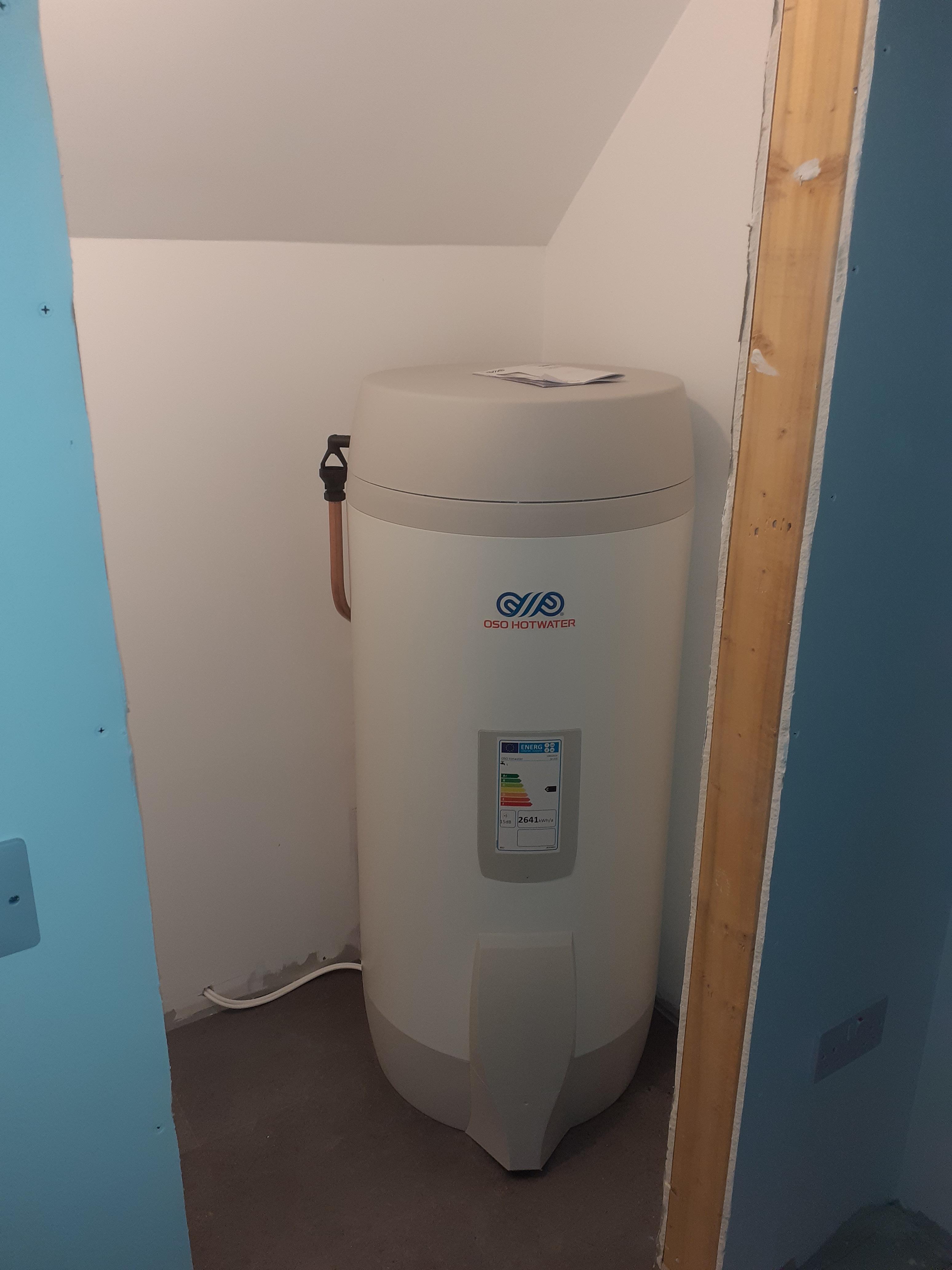

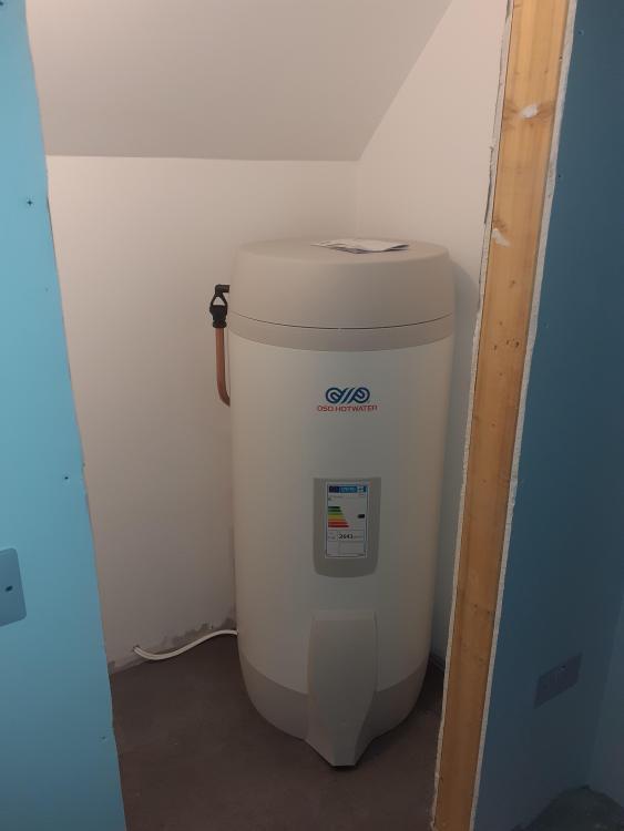

jamieled Posted July 5, 2020 Posted July 5, 2020 2 hours ago, ProDave said: My Telford does not lose enough heat to cause an over heating issue, even in summer. At only 48 degrees water temperature, I suspect the real heat loss is less than 2.3kWh in 24 hours. And remember for half the year, that "heat loss" is just helping to heat the house and we don't have much in the way of actual heating upstairs so is quite probably beneficial. I suspect a lot more heat loss is caused in many cases by poorly lagged pipes connected to the cylinder. Note the pictures of my cylinder in the other thread are before all the pipe insulation got fitted. I would agree with this. We have just installed an oso cylinder and the only bit of it that feels warm (with water at 65) is the hot water pipe coming out the back. The cylinder itself doesn't feel much above room temp. 1
