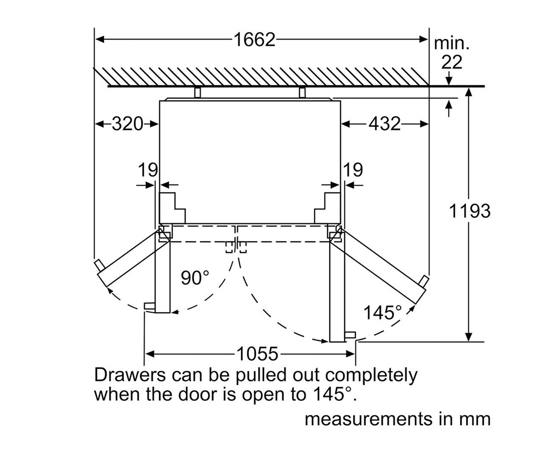

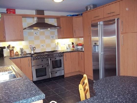

ProDave Posted April 21, 2020 Posted April 21, 2020 The American style FF's are not usually "built in" in the sense that they don't have cupboard dooors stuck to them to pretend to be cupboards. They merely slide into a recess. The water supply is often via a small 6mm diameter nylon hose so the tap can be some distance away as long as there is a route e.g under the units behind the kickboard to get to say the sink unit and the plumbing. We found the freezer capacity disappoionting in ours, so much space was taken up by the ice making gubbins and cold water dispensing mechanism. So much so that we kept a separate old under unit freezer in the utility room. It sounds like you need to take out some units to make space, slot in an American FF and fill in the resulting gaps with bridging units above and some form of side infill. How hard that is depends how old your kitchen is and whether you can get more units to match. Agree a picture and dimensions of what you have in mind would help.. Not the best picture, but this is the FF we had in the last house.
wozza Posted April 21, 2020 Posted April 21, 2020 The biggest issue you will find with American style FFs is the way that the doors open. The FF needs to stick out further into the room to allow the doors to open.
Dan F Posted April 21, 2020 Posted April 21, 2020 (edited) Amercican style are deeper than standard built-in cupboards. You can get a "built-in" kit for some FF's, but it won't be truely built in and will stick out. If you really want a more american style largish built-in FF then one of the few options avaiable is Fisher & Paykel which are 900mm wide, 610mm deep and have american style double doors + water/ice while still being built-in flush. At their prices though, you might be best to buy two standard FF's next to each other though! 800mm built in: https://www.fisherpaykel.com/uk/kitchen/fridge-freezers/french-door/integrated-french-door-ice-water-refrigerator-800mm.RS80AU1.html 900mm built in: https://www.fisherpaykel.com/uk/kitchen/fridge-freezers/french-door/activesmart-fridge-900mm-french-door-built-in-with-ice-water.RS90AU1.html 900mm (build in kit available, but sticks out 100mm and needs more than 900 width.) https://www.fisherpaykel.com/uk/kitchen/fridge-freezers/french-door/activesmart-fridge-900mm-french-door-with-ice-water-541l.RF540ADUX4.html Edited April 21, 2020 by Dan Feist
ProDave Posted April 21, 2020 Posted April 21, 2020 As above, the reason "American" FF's are so much better than a fully integrated one, is they are much deeper. But beware never trust the dimensions given. Look again at my picture. That FF was advertised as "fits standard 600mm deep units" That turned out to be untrue. The FF we had was about 700mm deep PLUS the doors. To make it work, we had to bring the cupboards either side of it and the bridging cupboards out further, adding two large gable end panels to do so.

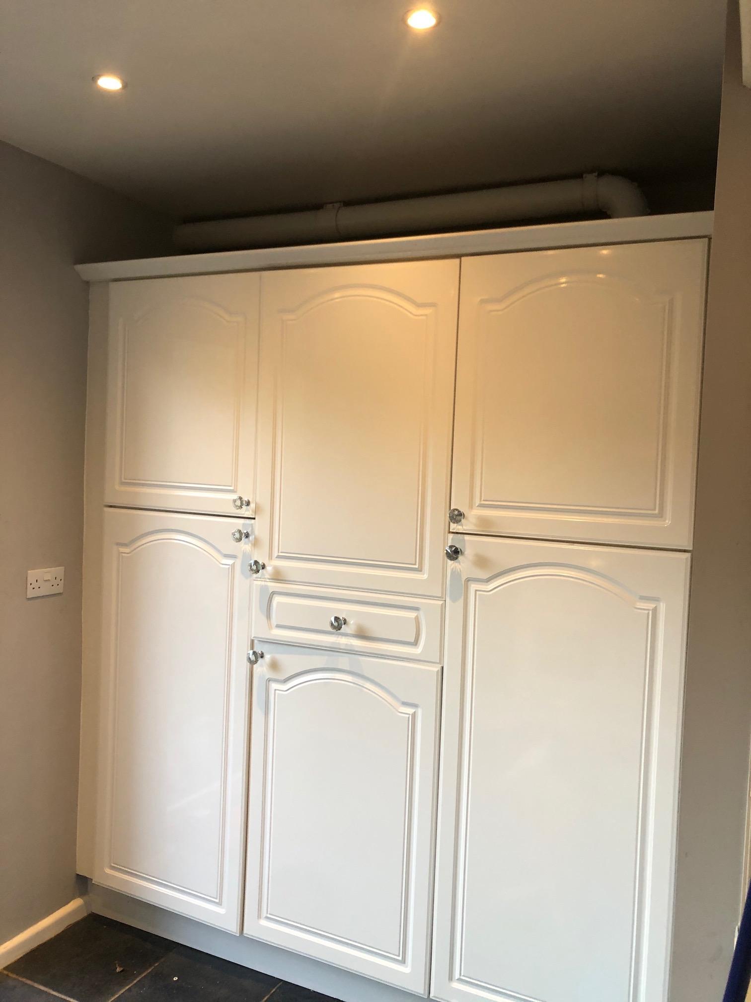

lib8899 Posted April 21, 2020 Author Posted April 21, 2020 i have attached a picture of the kitchen im talking about the 2 bottom cupboards 1,bottom left is fridge ,next to it is freezer the end cupboard has boiler in it and below a cupboard. Thank you
Russell griffiths Posted April 21, 2020 Posted April 21, 2020 57 minutes ago, lib8899 said: i have attached a picture of the kitchen im talking about the 2 bottom cupboards 1,bottom left is fridge ,next to it is freezer the end cupboard has boiler in it and below a cupboard. Thank you If you want to put it in there I think 99% of what you have will need throwing away, it will be far easier for the guys to install the fridge and you will need to buy some bridging units to go over the top of the fridge with a couple of new decor end panels. Trying to hack that lot about will cost more in labour than it is worth.
wozza Posted April 21, 2020 Posted April 21, 2020 (edited) I doubt if you would get a full size free standing American FF in that space and be able to open the left door fully (Assuming the boiler will be staying) You may get a 700mm wide one (or slightly bigger) in if you had a 400mm cupboard on the left (assuming the current cupboards are 600 wide and the boiler needs to stay) Edited April 21, 2020 by wozza
PeterW Posted April 21, 2020 Posted April 21, 2020 2 hours ago, lib8899 said: i have attached a picture of the kitchen im talking about the 2 bottom cupboards 1,bottom left is fridge ,next to it is freezer the end cupboard has boiler in it and below a cupboard. Thank you You couldn’t get an American fridge freezer in there but you could reuse the doors as they are, fit some steel joiners over the gaps and fit a side by side larder fridge and larder freezer. May potentially look better if you used the doors from the end unit, you’d have to rework a bit of the middle section for the boiler cupboard but it would be fine.
Ferdinand Posted April 22, 2020 Posted April 22, 2020 (edited) Really not sure what to suggest here. You are going to compromise on something here. It is an important one since a definition of house is "a group of rooms arranged around a fridge", I think I would look into redoing the whole thing, and looking carefully at what the different elements cost. Cupboard doors and cupboards are not expensive. Fridges are, depending on the fridge. My 'American Style Fridge" is actually German and 610mm deep, and the thickness of the doors need to stand proud, but they open to 170 degrees on stand-forward hinges - not sure if they are all like that. But a new one (actually a fridge freezer pair in a frame, so that only half of it loses power if a motor dies) is nearly as much as the one mentioned above. Personally I went for a model without gadgets for low maintenance and long life, and my watercooler is a carafe in the door. But that is personal taste. There is the option of choosing the ff your really want and building custom around it; but unlike slab doors, those cannot be butchered and look OK easily. You also need to allow enough space to the wall in case your fridge doors do not open fully and you can't get your shelves out. That may argue freezer on left as they have thicker walls and narrower shelves and are more tolerant in this respect. Ferdinand Edited April 22, 2020 by Ferdinand
