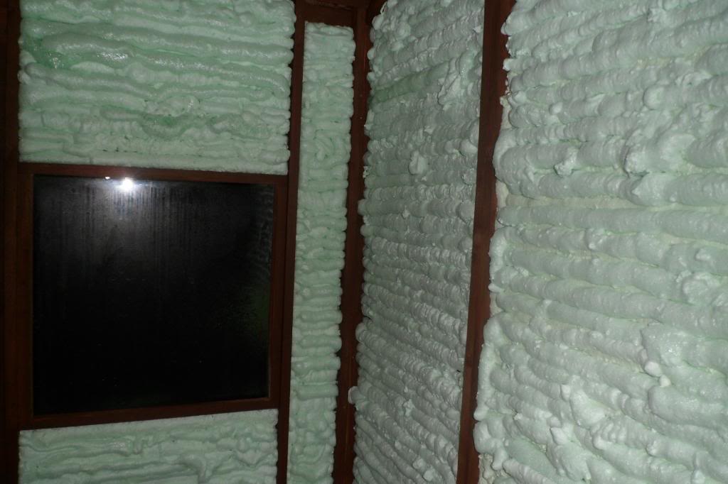

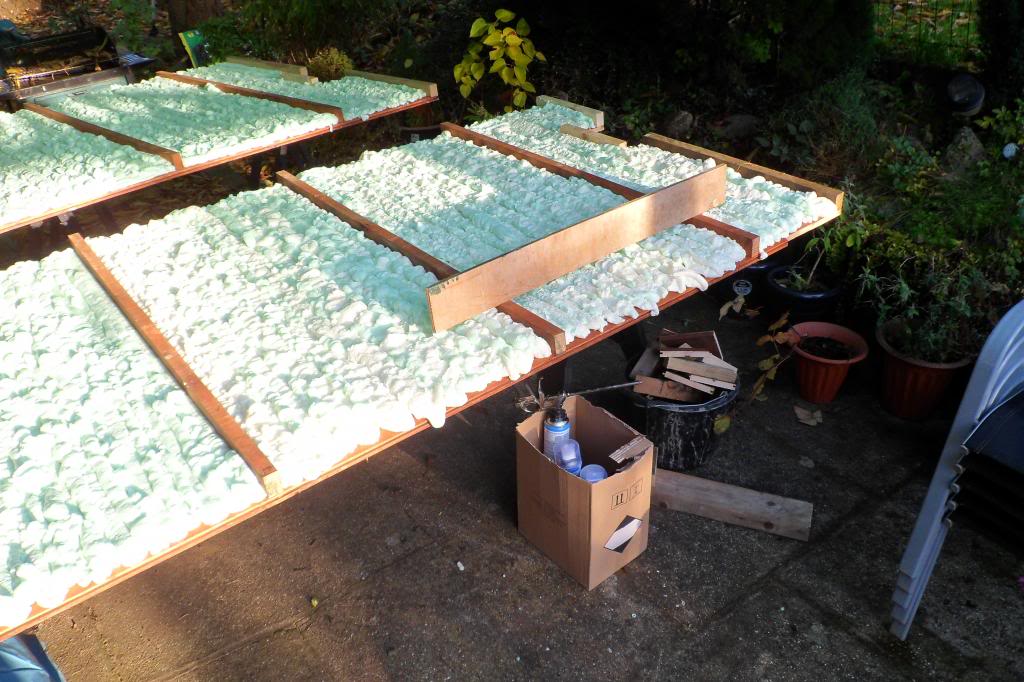

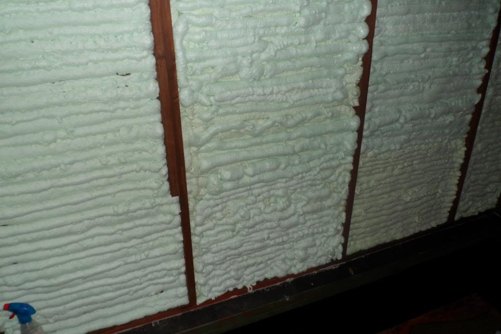

Onoff Posted November 21, 2016 Posted November 21, 2016 I had a crack at something like this on an old shed.....with CANS. Did the walls and floor: The floor: One of the STUPIDEST things I've ever done by far. 4
readiescards Posted November 21, 2016 Author Posted November 21, 2016 Had to admit to expecting to use a professional company but very impressed with your perseverance!

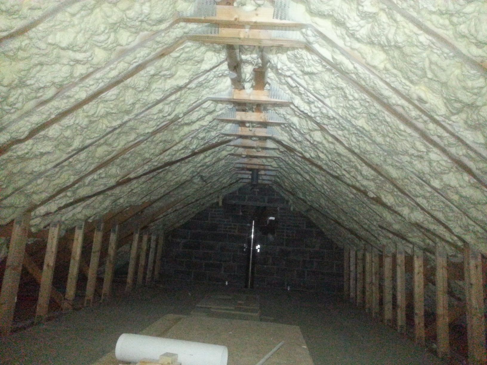

readiescards Posted March 2, 2017 Author Posted March 2, 2017 Installed today, pretty pleased with the result. 1
Dudda Posted March 2, 2017 Posted March 2, 2017 What's the minimum thickness of that foam or as I can still see the rafters what thickness are they? I'd be worried about foam expanding upwards and the felt held tight against the tile battens. Really you should have counter battens outside or good spray foam companies put in trays first which maintains a ventilation gap between the felt and the foam.
Gone West Posted March 3, 2017 Posted March 3, 2017 @readiescards Looks like a neat job. Did you get much overspray?

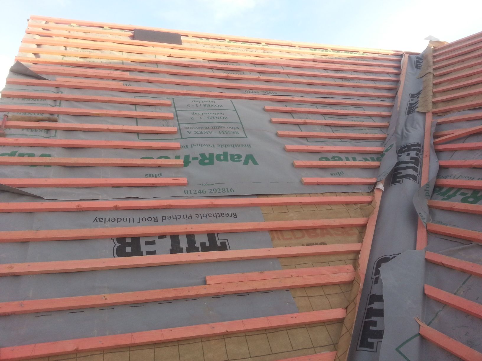

readiescards Posted March 3, 2017 Author Posted March 3, 2017 Minimal overspray, got some cutting back in the garage but over all not bad - given it is a pretty uncontrollable process! And due to an issue with my roofer (currently inspecting Her Majesty's prison roofs - from the inside) this is what the felt looks like with the foam applied underneath - the window space is bulging just because of the wind
Cpd Posted March 3, 2017 Posted March 3, 2017 Looks grand, however i am intrested that you can still see the inside of the rafters,( how deep are they ?) is this a cold bridge and will it have an effect on potential condensation problems ? Do you need to put extra insulation over the rafter faces to mitigate this ? i am not an expert and i am just intrested as i have a project where i am thinking about insulating the inside of a cold roof with calotex ( slate, breather membrane, 22mm sarking, 50mm air gap, 50mm calotex, fomed and taped, 120mm calotex, foamed and taped to the inside of the rafters face) , i was then going to add a further 25mm of calotex to mitigate the cold bridge. Just asking out of interest and not looking to hijack the this thread.
