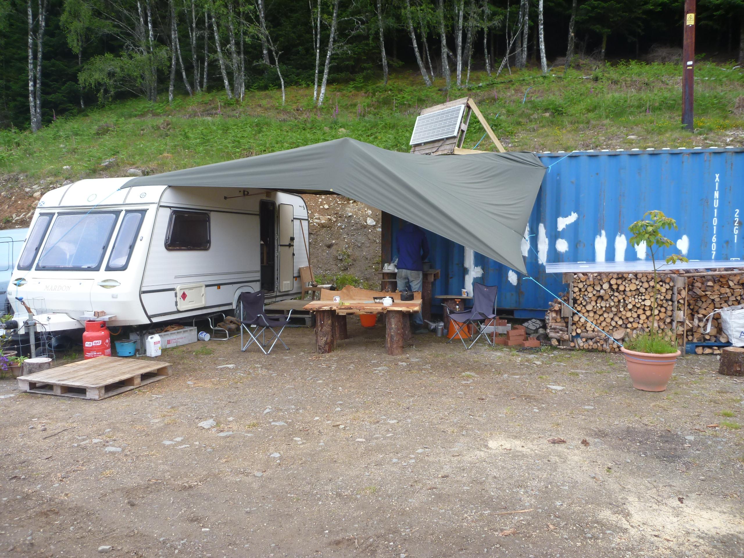

jamieled Posted March 12, 2020 Posted March 12, 2020 We used a couple of pallets, with a bit of 4 by inch to join them. They are the heavy type pallets. Tied to the edges of the container (the lifting holes) with some blue rope. Haven't moved an inch in the last year or so.

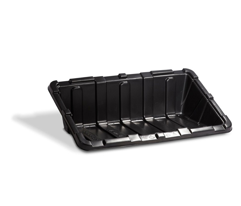

Russell griffiths Posted March 12, 2020 Posted March 12, 2020 Don’t they do a plastic box thing that is angled, so you mount the panel on the angled bit and put either concrete blocks or gravel on the flat bit to anchor it down.
Jeremy Harris Posted March 12, 2020 Posted March 12, 2020 47 minutes ago, Russell griffiths said: Don’t they do a plastic box thing that is angled, so you mount the panel on the angled bit and put either concrete blocks or gravel on the flat bit to anchor it down. Yes, like these (they are filled with ballast to hold them in place):
NWGEAR Posted March 12, 2020 Author Posted March 12, 2020 Thanks all. Will try the adhesive option then ballast if they end up in the next field @jfb no welding gear nor the experience and wouldn't want to wreck the water tightness
