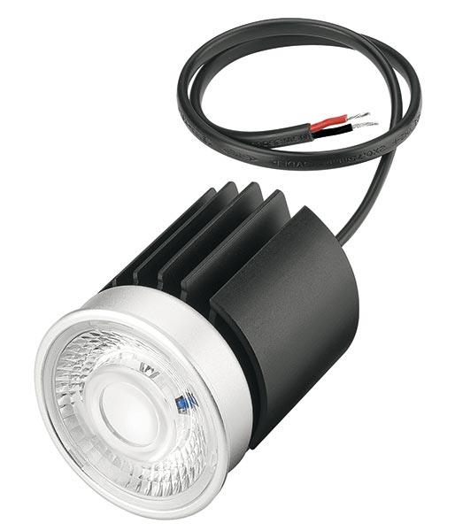

Carrerahill Posted March 6, 2020 Posted March 6, 2020 (edited) 20 hours ago, Nick1c said: We are getting to the point where we will be speccing the lighting. The two biggest questions are is it worth investing in a smart (probably Casambi based) system and should we go for integral light engines or GU10 lamps. Until yesterday I had come down on the side of the integral option - initially more expensive, but better value in the longer term, Aurora seems to be a popular choice. However a conversation with a wholesaler (who sells both types) has made me uncertain again. Apparently led’s tend to dim over time rather than suffer catastrophic failure, an arbitrary reduction in output of 30% is the point at which they are considered ripe for replacement - this is the lamp lumen maintenance factor LLMF. As I understand it the potential problem occurs if one light on a circuit fails, once it is replaced (assuming spares are available), it will be generating the original levels of light, which will be greater than the older lights on that circuit, meaning that all the units may need replacing to make it even once again. Another benefit of the GU10 option is that dim to warm is available. The wholesaler was talking about the ease of upgrading the lights should better technology become available with GU10. As someone who is new to, & relatively ignorant of, LED technology I would like to hear the opinions & experiences of those on here who are better informed - GU10 or integral lamps & why... What your wholesaler has tried to explain to you is true but the GU10 will cause more grief over time and also suffers lumen loss. A domestic downlight will probably average about 300-500Lm - so say a reduction of 30% (L70 I'd suggest if after 50,000hrs) so 150Lm loss, at that you would be hard pushed to actually see a difference albeit yes it would be there. The fact your wholesaler seems to well versed in this suggests that the integrated products they are selling are not very good and thus this issue is rearing it's ugly head too soon. I was on a site that had been handed over to the client 2 weeks ago, reception staff complained their desk was too bright, we had run the calcs and inline with CIBSE guides had designed the reception to 300Lux Avg with uniformity greater than 0.6. So in we went one evening with a light meter (only way to measure light in rooms with natural daylight penetration) and took a reading, on the desk we got readings of 250-350lux - fine, CIBSE LG07 would recommend 300-500lux for office spaces depending on use, so even allowing for the peak area of 350lux it was still well within spec, what I suggested the problem really was was the high gloss white reception desk reflecting light into her eyes! We rolled out a piece of cardboard immediately the issue was gone! However, on the lead up to this I advised the electrician to go into the fitting, and turn down the drive current from 1050mA to 750mA - now I didn't have the current/lumen curve so I don't know what lumen reduction that would have resulted in but at a 300mA drop we couldn't "see" any light drop - we eventually dropped it to 500mA and we began to notice it if we looked, others still could not see a drop - the humen eye is actually not that good at these relatively small light changes. The issue I have with GU10 is the little "driver" it is often no more than a cap and a resistor and some other bits, prone to being inefficient, getting hot and potentially being a big of a weakspot as the "driver" circuit usually fails before the LED. Aurora, JCC, Enlite etc. are "popular" among contractors as they are cheap and cheerful, you will generally not find Aurora speced on a job unless it was D&B or contractor lead - do not get me wrong I think they do fine, but as I see it they are really only suitable for the domestic market and often the optics and distribution is a bit rough. So most LED products that we would spec would be L90 - 100,000 - very basically it means that the LED will output 90% of it's initial lumens for 100,000hrs. L90 industry standard was always 50,000 - so if someone quotes L90 with no figure after it then it is only 50,000. You will also get L80, L70... Now even at 50,000hrs that is 11.41 years at 12 hours a day! So if the wholesaler is telling you about 30% lumen loss, then just how soon are they expecting this drop that you would start to individually replace lights? If I got say 15 years out a set I would probably be happy to replace it with the 2035 version which is 0.5W for 500Lm! Something to bear in mind is that all light sources degrade with time, florescents were terrible for it, people just saw they lit up and assumed they were fine but in fact they were well beyond their service life and could be as low as 50% of original lamp lumens. The high quality range of LED downlights use an LED engine/module which can be changed out, the Aurora units are largely all glued up and sealed - once dead, you bin them. A nice option for dometic installs is to buy a nice GU10 downlight and then buy the likes of a Tridonic LED engine and driver. You end up with a cost effective product with the light output and quality of for example a Flos or Erco down light which can cost £200 each! Like this: Note it has a decent heat-sink on it and optic etc. all built in. You can get a nice downlight for about £12.00-£15.00 and the Tridonic module and driver is about £15.00-£20.00 depending on lumen output - also, try and stick to around 3000K unless you want a white commercial feel. Edited March 6, 2020 by Carrerahill 2
joth Posted March 6, 2020 Posted March 6, 2020 6 hours ago, Carrerahill said: then buy the likes of a Tridonic LED engine and driver. Excuse the ignorant question, but is the driver built into the unit pictured or is it a separate? Afaict the tridonic LEDs take 220V in so not sure what sort of driver you'd add. (Dimmer aside)
Nick1c Posted March 7, 2020 Author Posted March 7, 2020 Thank you @Carrerahill, that is very helpful. Having read this I reconsidered one of the first manufacturers I came across (Chiara) as they use that modular design. Unfortunately the model I had been considering requires a depth of 125mm, & I will have a maximum of 112mm available. This made two things come to mind: - The tridonic unit you have shown is, I think, the one they use & has the electronics & light generator in the same unit, I have seen some where the two elements are separate, allowing the electronics to sit off to the side. This arrangement allows for less headroom, are there any downsides to these units? - Glare. Is this principally managed via the reflector in the lamp or the position of the lamp in the fitting? The higher the light generator sits in the fitting the narrower the cone of direct light, but there is the possibility of it bouncing off the internal walls of the luminaire to create a more diffused light? I believe the bathrooms need IP65 lights, which I assume require more headroom..... There seems to be a wide variation in quality (not necessarily related to price) & a paralysing range of choice in lights. Any pointers as to where to start looking would be useful!

Carrerahill Posted February 6, 2023 Posted February 6, 2023 On 03/02/2023 at 22:27, Mike said: Hi @Carrerahill - I'm reawakening this thread as I like the idea! Do the Tridonic modules clip in place using a standard spring clip (similar to the type normally used to retain GU10 bulbs)? Or at least can they be changed from below without disturbing the fitting? I ask because I'm planning to use some plaster-in downlighters, so removing them to fit or change a light engine would be... very problematic. Yes they do. However, there are some brands which are plaster in, but still have a retaining ring which permits removal of the LED engine & driver from beneath. I'll find out who they were as I spec'ed them on a hotel project last year.
Carrerahill Posted February 6, 2023 Posted February 6, 2023 (edited) On 03/02/2023 at 22:27, Mike said: Hi @Carrerahill - I'm reawakening this thread as I like the idea! Do the Tridonic modules clip in place using a standard spring clip (similar to the type normally used to retain GU10 bulbs)? Or at least can they be changed from below without disturbing the fitting? I ask because I'm planning to use some plaster-in downlighters, so removing them to fit or change a light engine would be... very problematic. https://ledsc4.com/en/collection/play-0 LEDS C4 Play - all accessible from below. Proper LED engine version available. Edited February 6, 2023 by Carrerahill 2
