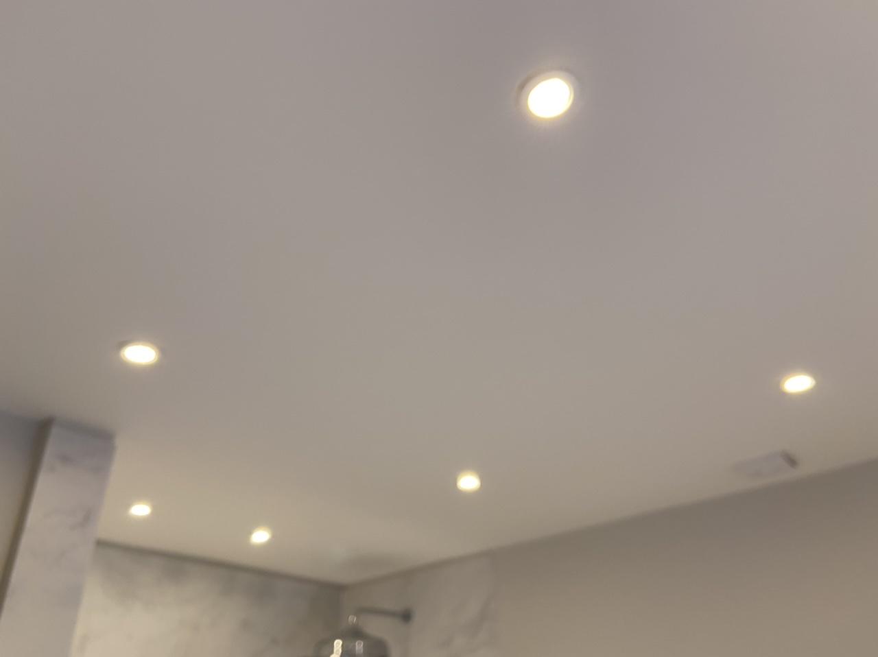

We have six downlights in our bathroom on a dimmer switch. When we turn the dimmer switch down making the room darker they start to flicker. They don’t settle. They just keep flickering. When we make them shine brighter they are better and don’t flicker.
Any advice.

1 hour ago, ProDave said:
Not all LED lights are dimmable. You may just have the wrong lamps in them.
Or you may have the wrong sort of dimmer switch designed for filament lamps.
Thanks Dave - I can verify that all the LED lights we have fitted are dimmable. I've checked that.
There's a strong possibility that the previous owners used the wrong dimmer - they really were morons. How can I check this?
Cheapest way would be to unscrew it from the wall - there may be some identifying information on the back to enable you to check out the spec.

9 hours ago, Home Farm said:
When we increase the load, by turning the extractor fan on which is on the same switch, we don’t get any flickering.
Some dimmers have a minimum load specified. When incandescent bulbs are replaced with LED the load is reduced and can fall below the minimum specified for the dimmer. Adding the fan takes the load back above the minimum specified but is not an acceptable solution.
Use a proper LED dimmer for the lights and move the fan to another switch. This might be possible using a modular/Grid faceplate (eg dimmer and switch on one face plate) but depends where the fan is connected to the lighting circuit.
or just replace the dimmer with a switch as others have suggested.

3 hours ago, Home Farm said:
 For my own knowledge building, why shouldn’t they be on the same switch?
Shouldn't really be on the same dimmer. Light dimmers aren't rated for driving motors although they may do so.
The motor in the fan is an inductive load and liable to damage a dimmer that is only designed for resistive or LED loads.
In more practical terms, matching dimmers and LEDs is enough of a pain without making life harder adding more variables to the mix.
