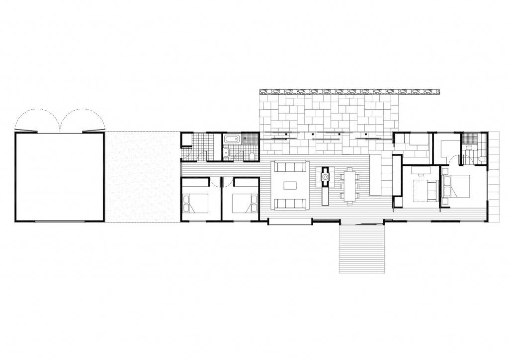

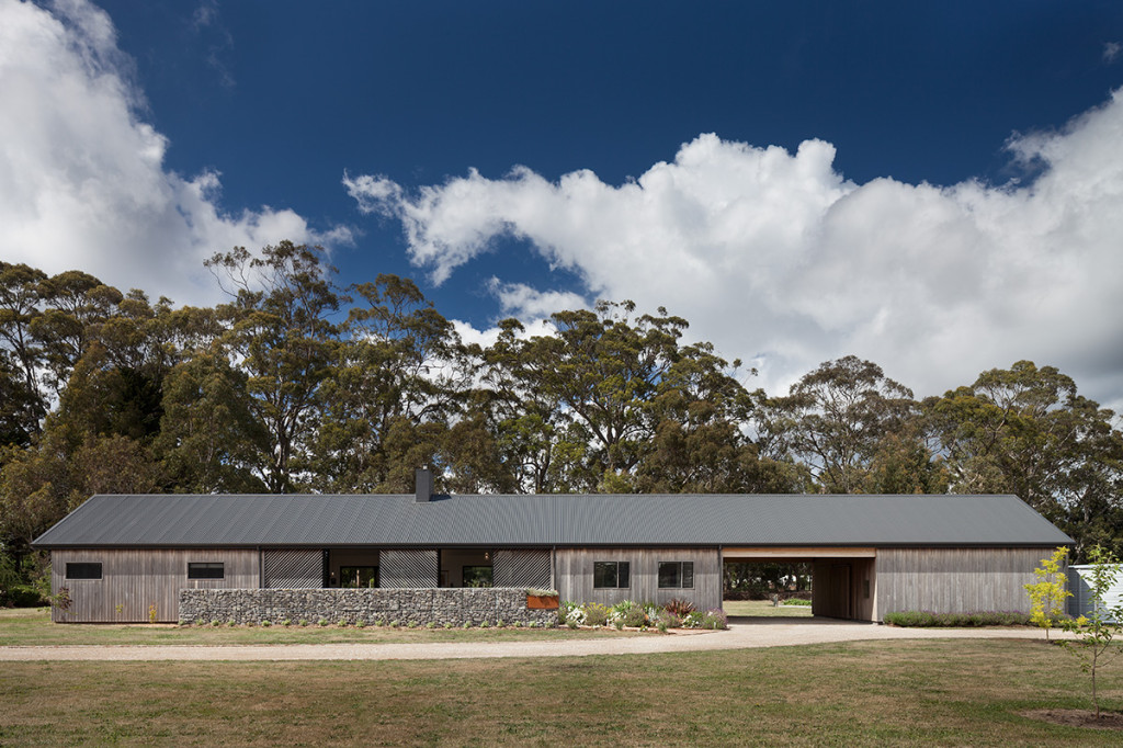

gavztheouch Posted November 16, 2016 Posted November 16, 2016 Hello, I am hoping to build a new farm house on a 14 hectare farm. I have been running the farm for 3 years now and have proven I can make a living and ready to expand. I have been designing houses in my head and on paper for most of my life dreaming of one day actually building one. Building bases or den was my favorite thing to do in my youth. Now that I have the chance to design my own home I have gone a little strange and fixated on a house design I like in Australia and can't seem to see any way of changing it to make it my own. I have swung from oak framed homes to modern long houses like this and favor the simplicity of construction and design. A simple pitched roof and rectangular single story main body should be much easier to build. I plan on using ICF for the walls with a polished concrete slab floor with underfloor heating to again simplify construction. I have had experience building similar shaped buildings in block and brick but this will be my first house build if I get planning. What would you change to make this home your own. Should I be worried about being sued for copyright if I built a similar house.
ProDave Posted November 16, 2016 Posted November 16, 2016 Hi and welcome to the forum. That looks like an efficient use of space and quite simple. Why not build in Timber frame which is so popular up here?

Redoctober Posted November 16, 2016 Posted November 16, 2016 Welcome to the forum - the proposed building looks absolutely great. Lets hope you are able to realise your dreams. Keep your progress, experiences and questions coming. PW.

Ferdinand Posted November 17, 2016 Posted November 17, 2016 (edited) Looks nice and simple. I would say that shelterbelts etc need very careful handling as there is little shelter in the inherent design. Also doesn't the sun come from the North in Australia (doesn't it?) . So your sheltered entrance and terrace may need to be on the other side. Or I ma be wibbling. I think I would want a potential second living space for privacy, and perhaps make use of doors straight from bedroom to the terrace. Ferdinand Edited November 17, 2016 by Ferdinand
Barney12 Posted November 17, 2016 Posted November 17, 2016 (edited) @gavztheouch question re copyright of design is an interesting one. I don't know the legalities but I guess if you were to copy it exactly then you most certainly would be vulnerable if the architect firm was to find out (I.e by reading about it on a public forum. Oooooops!!) However, i can't see it would be that hard to change a design sufficiently for it to be questionable if it was copied. We certaintly took inspiration from a large number of designs in the local area, that's one part of the online planning system that is rather useful! Edited November 17, 2016 by Barney12
Dudda Posted November 17, 2016 Posted November 17, 2016 You really need to keep in mind your site when designing a house and not just copy one directly. You have to consider views, orientation and sunlight, location of entrance, slope and topography, etc. You might have to flip, mirror, etc the house or parts of it to align with any views you have. eg you don't want the large glazed area facing to the north where you have no view but you'd also need to consider if it was facing south would it overheat that room. If you're on an elevated unsheltered site you'd want to consider the prevailing wind direction and ensure that the carport between the garage and house doesn't end up a wind tunnel. By all means use the house as a starting base or precedent to inform your design but take careful consideration of your own site and requirements. 2
