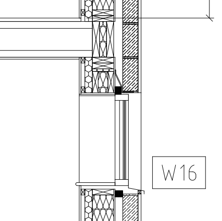

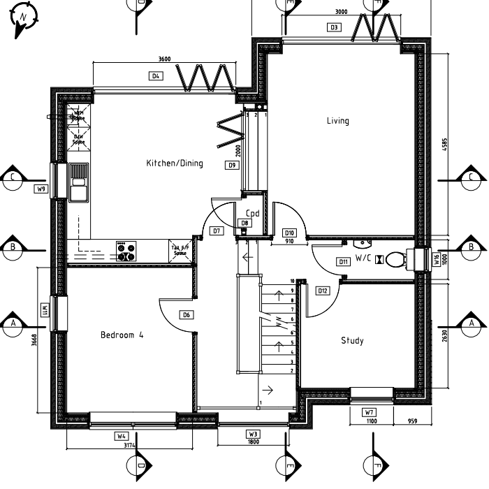

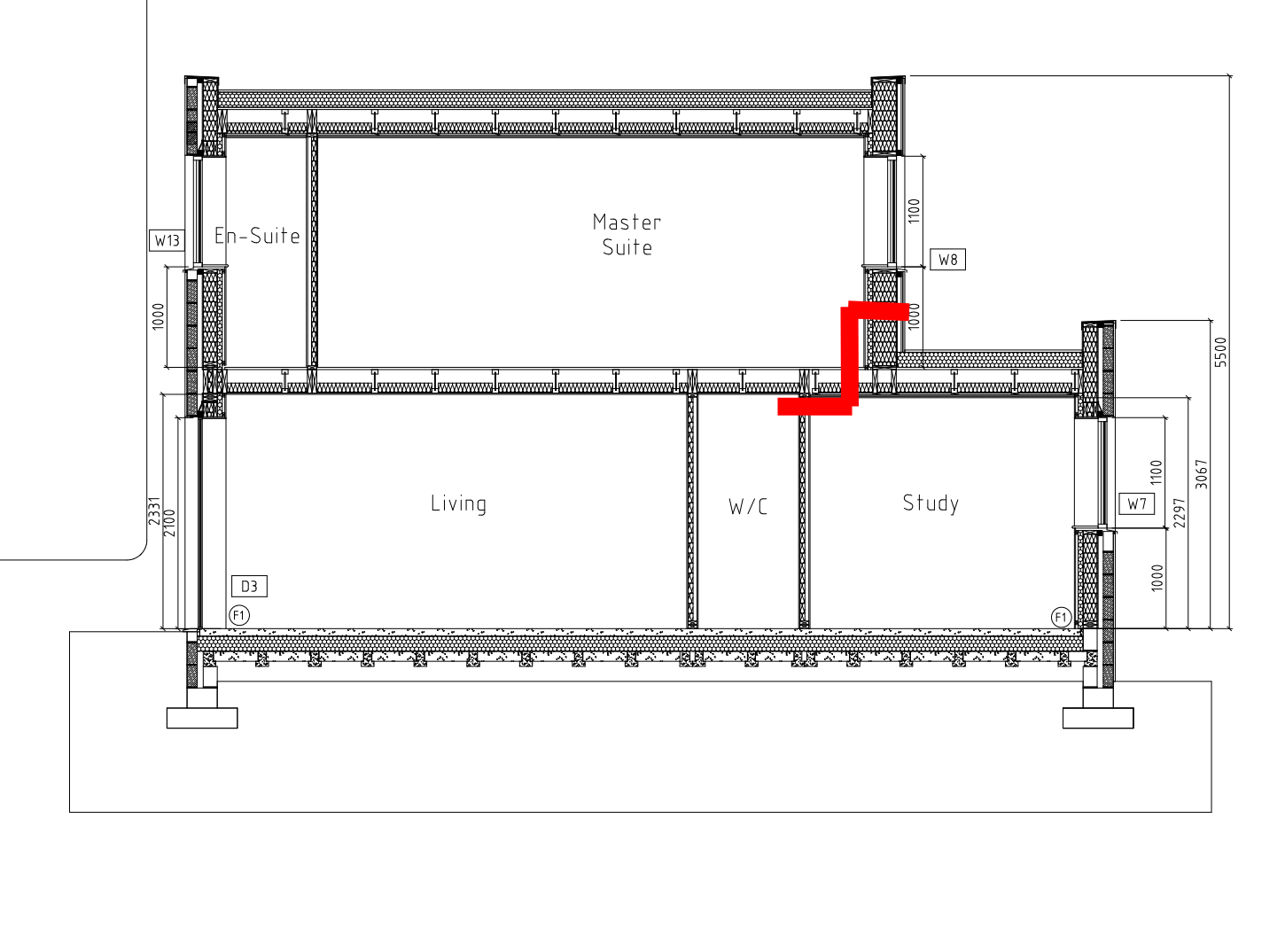

Moonshine Posted February 21, 2020 Share Posted February 21, 2020 A puzzling conundrum for a Friday morning, how to ventilate a land locked WC as below The issue is that ventilation straight through the external wall is on to someones else's land, as the external wall is the boundary, i guess this is out, also the space above the window is limited (240mm from top of window to ceiling level), as below, and there would be issues with the window lintel / cavity tray. Space to both sides of the window are limited to about 200mm. In these areas and side of the house the joists are going to run along the lines of sections A-A, B-B, and C-C, so if it was going in the floor joists there will be a lot of joists to go through to get it out of either the study or the living, and tbh i don't really want to go through the study as that it to the front of the house. It could go below ceiling level, but would have to go in some horrible boxed in section. I am just wondering if could go through some S bend of vents in smaller boxed in section in the study and master suite above, exiting to the front of the house. but at a low level. It all seems very convoluted and i seem to be missing some simple solution. Link to comment Share on other sites More sharing options...

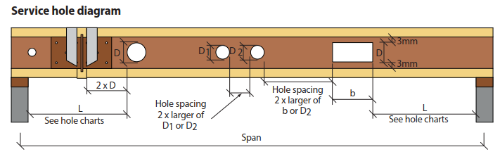

joe90 Posted February 21, 2020 Share Posted February 21, 2020 1 minute ago, Moonshine said: I suppose this could be floor void above and you would only have to take the vent through one or two joists before it exits with the run of the joists. ha, I was about to post about the floor void!. If using i joists there IS a limit on hole size and location near the ends. 1 Link to comment Share on other sites More sharing options...
Moonshine Posted February 21, 2020 Author Share Posted February 21, 2020 3 minutes ago, joe90 said: If using i joists there IS a limit on hole size and location near the ends. Good shout, the JJI joist technical manual has this (L) at about 1000mm for a 100mm diameter hole (4m span / 325mm joist). Looks like if the vent can go out on to someone else property this will be the simplest solution, to go though the joists and vent offset from the WC wall itself Link to comment Share on other sites More sharing options...

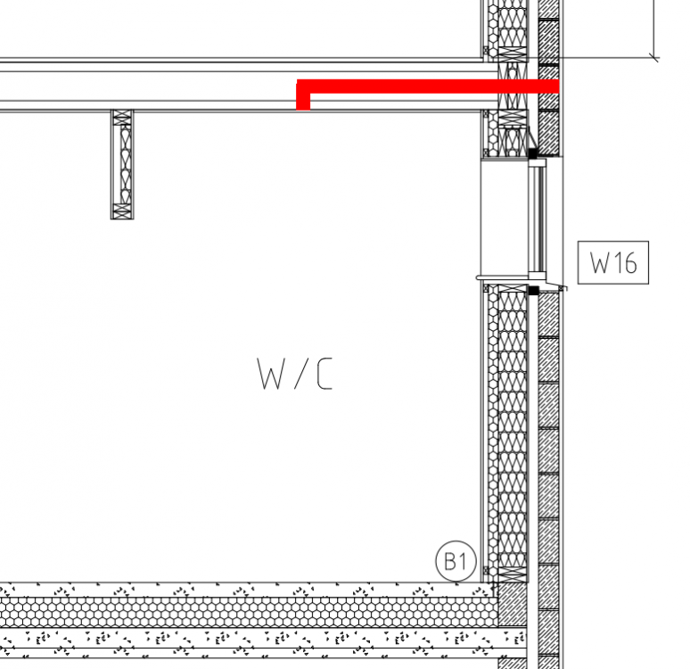

joe90 Posted February 21, 2020 Share Posted February 21, 2020 Can you not just ring your BCO and ask him?, the fan would protrude less than 30mm, less than your roof overhang/facia/guttering (I guess?). This would be the simplest solution. If you have to go through ceiling void, fan set 1m from wall in ceiling (over toilet) and run flexi through joists to outside (more work than solution 1). 1 Link to comment Share on other sites More sharing options...

Moonshine Posted February 21, 2020 Author Share Posted February 21, 2020 (edited) 39 minutes ago, joe90 said: Can you not just ring your BCO and ask him?, the fan would protrude less than 30mm, less than your roof overhang/facia/guttering (I guess?). This would be the simplest solution. If you have to go through ceiling void, fan set 1m from wall in ceiling (over toilet) and run flexi through joists to outside (more work than solution 1). Spoken with them and from a building regs point of view they would be o.k with it, but they did point out that i maybe more of a civil issue later on, and that the area around the vent would have to be kept free. In this case i am the neighbour, so i would be fine with it, but would have to get things in place legally for an subsequent owner of the house(s), same with any foundation footings that were over the boundary line. I it looks like the simplest way to go out of the WC wall can happen but in the joist void. Edited February 21, 2020 by Moonshine Link to comment Share on other sites More sharing options...

MJNewton Posted February 21, 2020 Share Posted February 21, 2020 11 hours ago, Moonshine said: Good shout, the JJI joist technical manual has this (L) at about 1000mm for a 100mm diameter hole (4m span / 325mm joist). Looks like if the vent can go out on to someone else property this will be the simplest solution, to go though the joists and vent offset from the WC wall itself It sounds like you've got a solution now but for future reference the Simpson Strong-Tie I-Joist Hole Support can be used to allow huge holes (250mm width x full web height) to be cut to within 50mm of the joist support: They're around £25/pr (you need one for each side) so whilst not cheap they can be extremely handy if you don't have alternative options. 1 Link to comment Share on other sites More sharing options...
