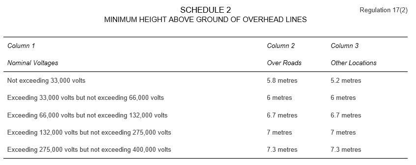

Temp Posted February 13, 2020 Share Posted February 13, 2020 (edited) 1 hour ago, Ants said: the lorry delivering the wood chip will pose a danger to the HV lines if it comes of the track (which is highly possible ) and therefore will not pass the HSE requirements. How high are the lines and what voltage? I thought minimum cable heights took into account vehicles passing underneath? I'm no expert but had a look at the legislation here... http://www.legislation.gov.uk/uksi/2002/2665/schedule/2/made It appears the min heights over roads and other locations are the same except for <33,000V cables. So I'm guessing "your" cable is less than 33,000V? Perhaps try safely measuring the exact height of the cables. eg using trigonometry not a long pole! If they are over 5.8m high you might not need to do anything? If they are lower how much lower? If they are below 5.2m could you argue they don't meet legislation and need to be raised? How about putting up barriers to prevent the lorry coming off the track or excavating the land 0.6m to artificially raise the height of the cable? How about barriers at the start and end of the track to limit vehicle height? Edited February 13, 2020 by Temp Link to comment Share on other sites More sharing options...

Randomiser Posted February 13, 2020 Share Posted February 13, 2020 52 minutes ago, Temp said: How high are the lines and what voltage? I thought minimum cable heights took into account vehicles passing underneath? I'm no expert but had a look at the legislation here... http://www.legislation.gov.uk/uksi/2002/2665/schedule/2/made It appears the min heights over roads and other locations are the same except for <33,000V cables. So I'm guessing "your" cable is less than 33,000V? Perhaps try safely measuring the exact height of the cables. eg using trigonometry not a long pole! If they are over 5.8m high you might not need to do anything? If they are lower how much lower? If they are below 5.2m could you argue they don't meet legislation and need to be raised? How about putting up barriers to prevent the lorry coming off the track or excavating the land 0.6m to artificially raise the height of the cable? How about barriers at the start and end of the track to limit vehicle height? Presumably the poles they attach the cables to are in excess of the minimum required height. If that is right I guess the only way they will below the required height is due to excessive sagging or topology, i.e. the two poles the cable runs between being in dips with the land in between being higher. Does that make sense? Link to comment Share on other sites More sharing options...

Ants Posted February 14, 2020 Author Share Posted February 14, 2020 14 hours ago, Temp said: How high are the lines and what voltage? I thought minimum cable heights took into account vehicles passing underneath? I'm no expert but had a look at the legislation here... http://www.legislation.gov.uk/uksi/2002/2665/schedule/2/made It appears the min heights over roads and other locations are the same except for <33,000V cables. So I'm guessing "your" cable is less than 33,000 KV? Perhaps try safely measuring the exact height of the cables. eg using trigonometry not a long pole! If they are over 5.8m high you might not need to do anything? If they are lower how much lower? If they are below 5.2m could you argue they don't meet legislation and need to be raised? How about putting up barriers to prevent the lorry coming off the track or excavating the land 0.6m to artificially raise the height of the cable? Link to comment Share on other sites More sharing options...
