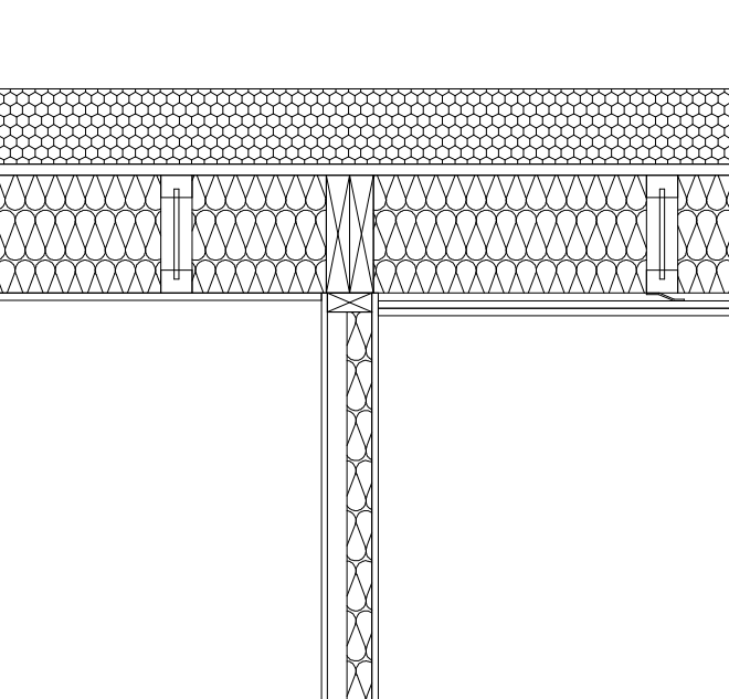

Moonshine Posted February 12, 2020 Posted February 12, 2020 (edited) 1 hour ago, pocster said: I was going to use standard plasterboard for this . But I’d like additional sound proofing ( not worried about insulation as warm roof above ) is this noise from the outside breaking in, or noise from rooms above? look below as some of the different densities of plasterboard. If its external in, this is what i am doing for reduce noise in bedrooms from aircraft noise 100-150mm PIR 22mm roof board 200-250mm I-Joists min 200mm porous insulation within the cavity. 2 x 15mm Soundbloc (or similar) of resilient bars Edited February 12, 2020 by Moonshine 1
Pocster Posted February 12, 2020 Author Posted February 12, 2020 5 minutes ago, Moonshine said: is this noise from the outside breaking in, or noise from rooms above? I'm not looking for 100% noise reduction. More interested in stopping noise transferring from neighbouring rooms such as music/tv etc.
Moonshine Posted February 12, 2020 Posted February 12, 2020 1 minute ago, pocster said: I'm not looking for 100% noise reduction. More interested in stopping noise transferring from neighbouring rooms such as music/tv etc. so its the sound insulation of walls you want? O.k, min 50mm fluffy stuff (porous insulation) in the cavity, and 2 layers of 15mm dense board (min 12 kg/m2) either side, and if you want more, mount this board on resilient bars. If you want event more acoustic performance, ditch the single stud and use a staggered stud
Pocster Posted February 12, 2020 Author Posted February 12, 2020 Just now, Moonshine said: so its the sound insulation of walls you want? O.k, min 50mm fluffy stuff (porous insulation) in the cavity, and 2 layers of 15mm dense board (min 12 kg/m2) either side, and if you want more, mount this board on resilient bars. If you want event more acoustic performance, ditch the single stud and use a staggered stud Yeah I've done that for the walls. I just *assume* to insulate the ceiling from noise would be worth the effort and cost....
Moonshine Posted February 12, 2020 Posted February 12, 2020 Just now, pocster said: I just *assume* to insulate the ceiling from noise would be worth the effort and cost.... to reduce it from the rooms above? or due to flanking noise via ceiling void from the room to the side?
Pocster Posted February 12, 2020 Author Posted February 12, 2020 5 minutes ago, Moonshine said: to reduce it from the rooms above? or due to flanking noise via ceiling void from the room to the side? No rooms above just next to each other ; so flanking
Moonshine Posted February 12, 2020 Posted February 12, 2020 Just now, pocster said: No rooms above just next to each other ; so flanking If the separating wall between the two goes up to roof level / joist, then it will be o.k. as below, However if the wall runs perpendicular to the direction of the joists then you will have potential flanking over the top of the wall. Do you know what arrangement you have?
Pocster Posted February 12, 2020 Author Posted February 12, 2020 Just now, Moonshine said: If the separating wall between the two goes up to roof level / joist, then it will be o.k. as below, However if the wall runs perpendicular to the direction of the joists then you will have potential flanking over the top of the wall. Do you know what arrangement you have? Perpendicular ?
Moonshine Posted February 12, 2020 Posted February 12, 2020 Just now, pocster said: Perpendicular ? No biggie, at the head of the wall just fill the gaps between the joists full with porous insulation, and use the same plasterboard arrangement for the ceilings as you did for the walls.
