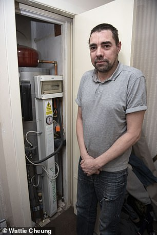

I didn't realise that these houses don't have gas.
The boilers are advertised as saving money compared to LPG, oil and storage heaters by using the economy10 wet electric tariff. This could well be true.
The website suggests they should cost £1300/year to run, but that is based on a 2 bed house and 11,000kWh per year(2012 tariffs are used). For hot water and heating you are probably looking at 20000kWh. After all that would only be £5-600 a year in gas including the standing charge.
People may indeed be using them incorrectly if they are running them all the time and not mainly at night on the economy tariff. Looking at the spec they can hold around 400l of hot water. I guess that the idea is that you heat this up on the economy tariff at night then use it to provide heating and hot water during the day. I am not sure how this would work in practice as once people had a couple of showers the water would need reheated to be hot enough to warm your house. 400l of hot water would store around 30kWh of energy. If you use half of this for hot water, you only have 15kWh left for heating. This is nowhere near enough to heat a poorly insulated house.
I think these people are indeed complaining about expecting bills of £3000 because they have always had expensive electric heating and getting bills of £5000. The problem may indeed be that people have not signed up to new lower priced tariffs.
I am gobsmacked tbh, it just shows how tough things can be for people if they don't have good technical knowledge. That kind of bill would be crippling to someone on an average income.

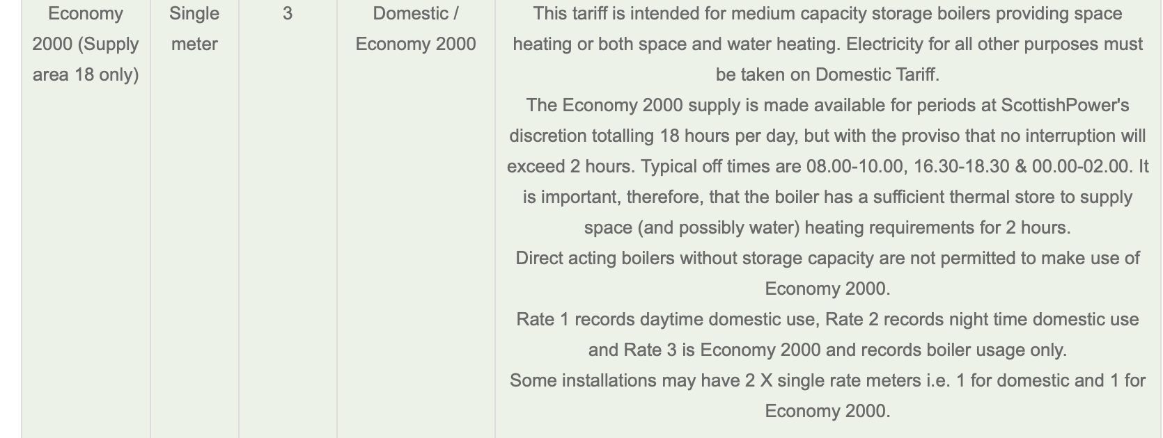

Thanks @TempI had just assumed it was an economy 10 tariff, there are so many tariff names. It is similar but not the same as economy 10 and therefore it seems that ScottishPower are the only people to offer it and there is no way to shop around.

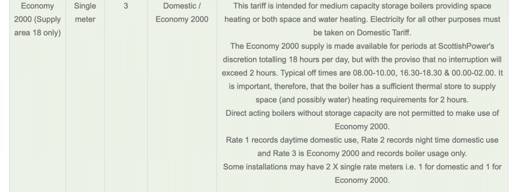

I found this explanation at ScottishPower
It does indeed seem that when these boilers were installed ScottishPower were offering the off-peak electricity at 5-7p/kWh which tbh is a fantastic price for 18 hours a day.
At some point last year they put the price up to 16/18p off peak/peak. This is much higher than normal online electricity prices.
I think these customers could probably move to a ScottishPower normal online price at 13p/kWh, a look at Scottishpower's website suggested they could just move to a normal tariff, but it is not clear at all and maybe they will say they cannot do that with their meters. The chances of getting the kind of deal they used to have seem pretty slim. So it seems to be a combination of an inherently expensive electric heating system plus ScottishPower believing they have these people over a barrel and overcharging them.
At a guess on the old tariff people probably paid an average of £2000 for electricity, the same amount of electricity would cost £4000 on the current tariff and if they moved to a single rate online tariff they could maybe get that back down to £3000ish.

I notice that talks a lot about storage so the tanks they have must be thermal stores. They don't look big enough to switch to some sort of night time rate.

The controls should have been set up so it only heats the tank on the cheap rate periods.
The big problem though is with any off peak tariff the peak rate electricity is more than most of us pay so that won't help the bills.

Looking at the picture above, I am willing to bet there was a blown air central storage heater system in that cupboard before, the old Electricair system. They were the standard heating in several of the council estates in the town around here, and quite a few are still there and working.  Parts are still available for them so they can be maintained, though it was one hell of a job stripping one down enough to change the main fan motor several years ago,  It would probably have been better for the tenants to just keep those and maintain them.

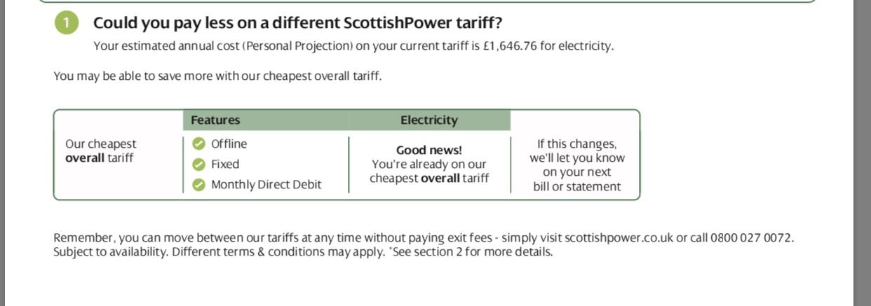

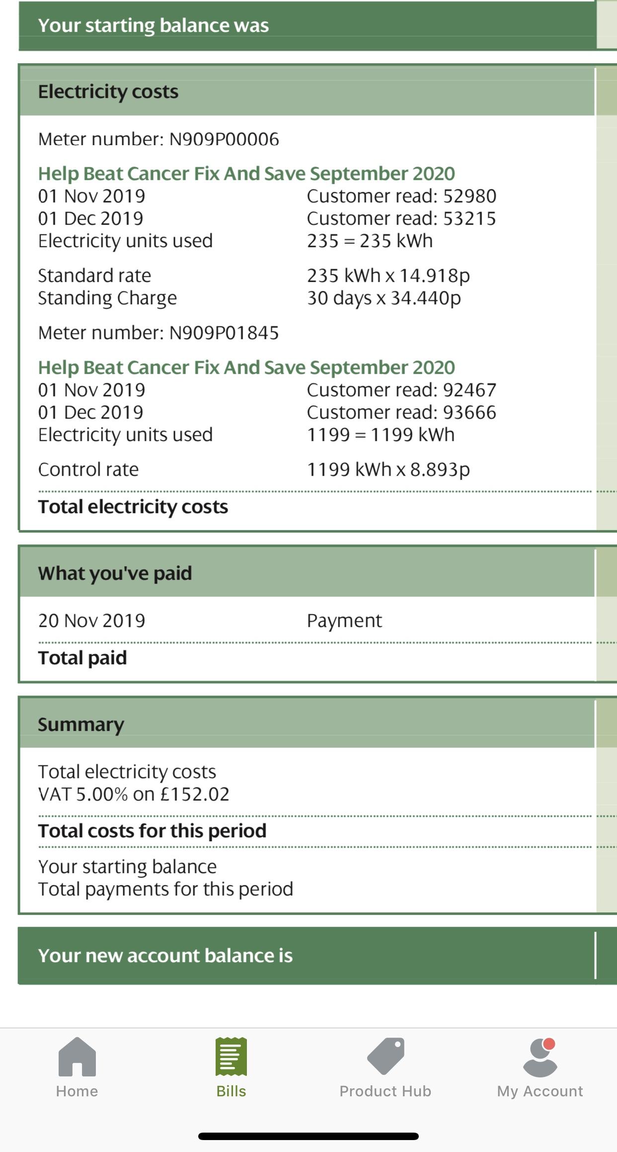

Yes that’s the tariff I’m on from Scottish Power. I still don’t pay huge amounts for heating from a tariff perspective but I have a big TS to heat (475l) so it’s not particularly efficient in summer for example when I have to heat the tank just to take a shower. In hindsight putting an electric shower somewhere would have been advantageous.
Here are the details of the tariff I’m on.
For ‘control’ read ‘heating’. I have been thinking of changing but haven’t found the right tariff yet. But a colleague has moved to Octopus Agile and apart from 3 hours where the cost is £££ the rest of the time the tariff is much cheaper. I may do some experiments and see whether heating the TS up overnight will allow me to run the UFH in the afternoon in an economical way. Almost all of the tariffs are less than my current rate, I just have to avoid running heavy usage things between the punishing hours of 4pm and 7pm. The standing charge is cheaper than mine. Apparently they let you know the tariffs 24 hours in advance so if you’re organised enough you can change the heating timings if you have a storage boiler.
Next step is to find someone decent to rewire my 2 consumer units into a single meter. I may just wait until the weather improves before I swap though as running heating at 15p instead of 8p in the interim will be ££££. I also need to work out how to charge the car overnight as currently I just plug it in when I get home. That would be in the £££ period so maybe I would need a spark to put in some sort of timer. I don’t think my unit in the garage has that although in truth I’ve never actually looked at it.

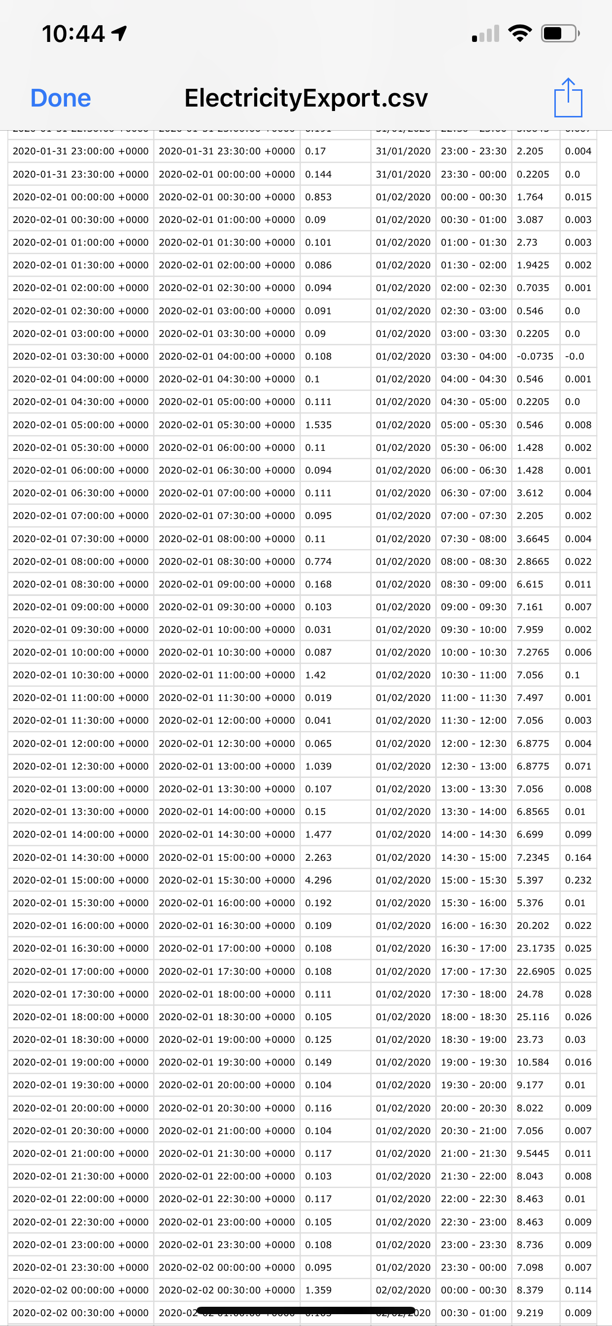

Example Octopus Agile tariffs below. On one day it even went minus!

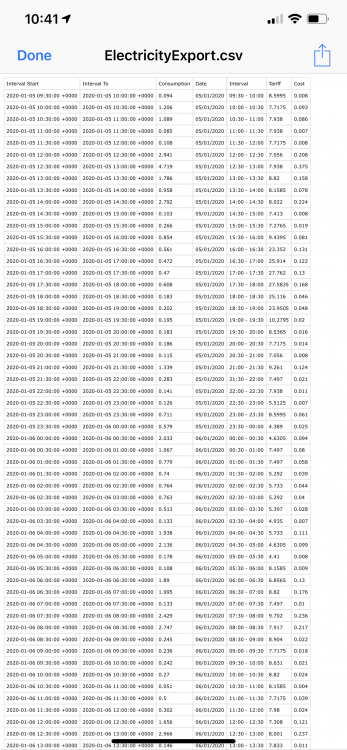

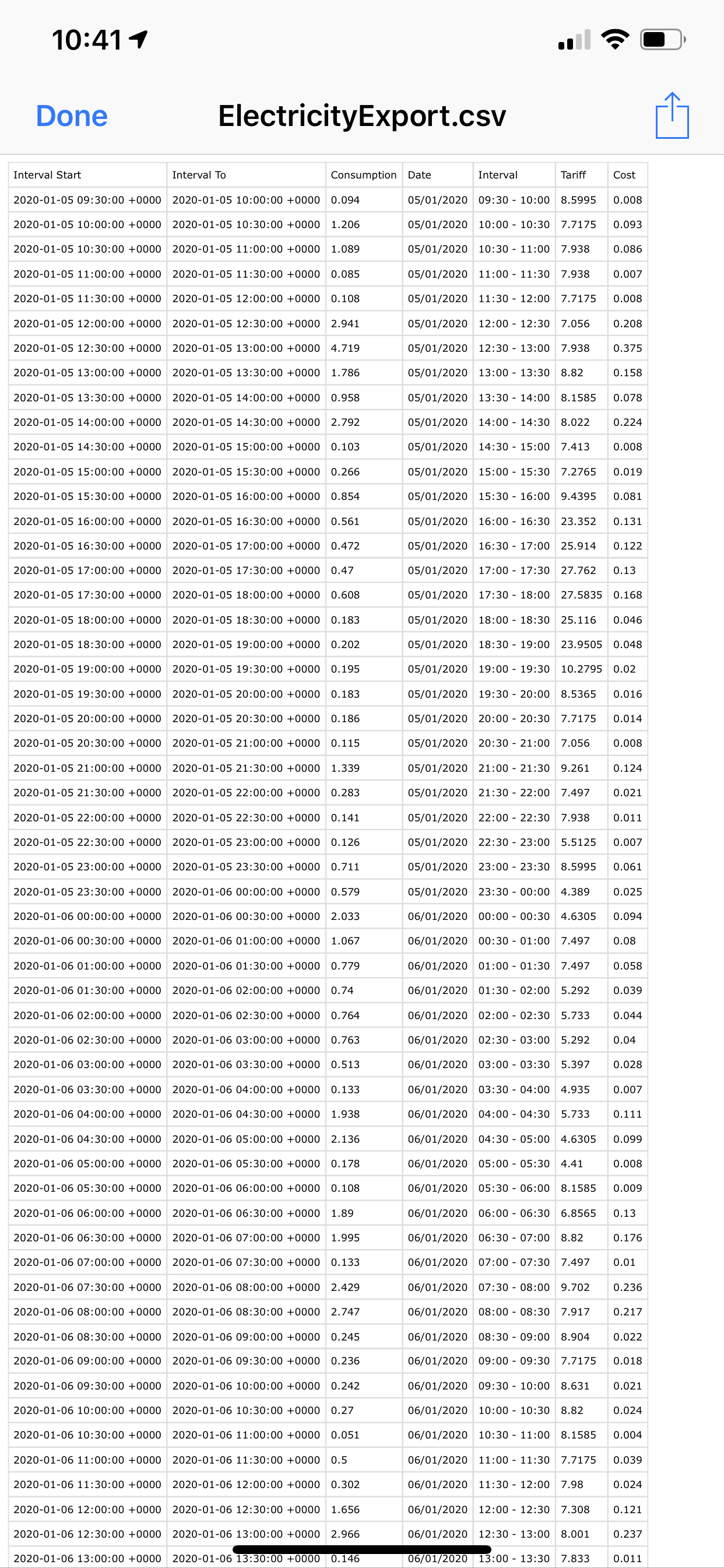

Just a slight correction - Octopus Energy API docs are here - https://developer.octopus.energy/docs/api/
Check out the fantastic https://www.energy-stats.uk/ to get a quick overview of Agile and it's pricing.
I'm just starting out on this path but have been simulating 3 tariffs over the past few weeks and Agile is coming out consistently cheaper with my particular usage profile -
Agile cost for Jan was £38.18
vs GO @ £48.56
vs SuperGreen @ £60.10
vs GO @ £48.56

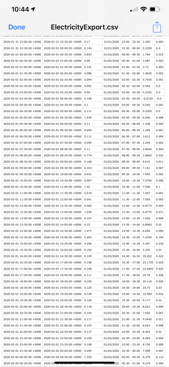

This illustrates well how an individual usage pattern can make a massive difference to the best choice.  For us, Agile would have cost £68, Go would have cost £76 and our existing E7 cost £57.
The problem for us with Go, and to a lesser extent Agile, is that we tend to need the cheap rate for the full 7 hours of the E7 period.  Car charging, in particular, doesn't fit well with either Agile or Go.  4 hours at the maximum charge rate of 7 kW is only just over 1/3rd of a charge for the car, and I can often need a bit more than that after a day out somewhere.  The UFH also needs more than 4 hours to get enough heat into the slab.  If I increase the flow temperature to reduce this time the room temperature tends to overshoot a lot the next day.
  • Like 1
