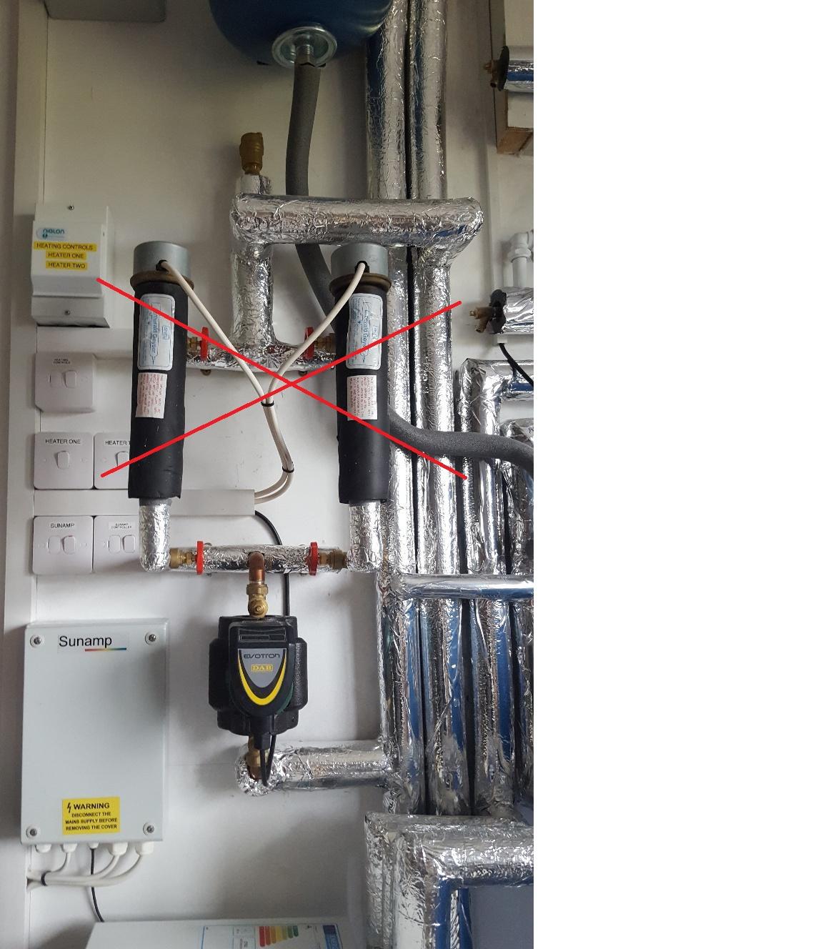

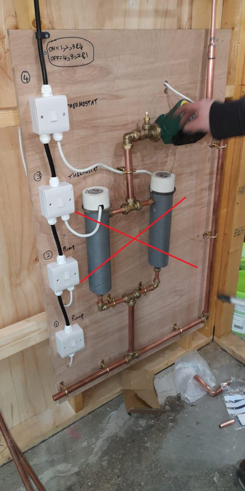

I've seen a couple of photos posted here of upside down Willis heater installations, like these two (I've added the red crosses to show that they are fitted incorrectly):
198743587_UpsidedownWillis1.thumb.jpg.69bff4ff5bb0ebe97997c21d49c13009.jpg   1014020124_UpsidedownWillis.thumb.jpg.20a72eb0e5b4e22b57cd08f1be790a6f.jpg

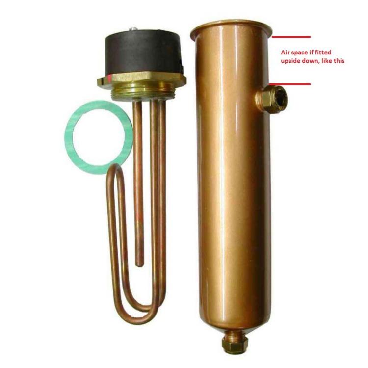

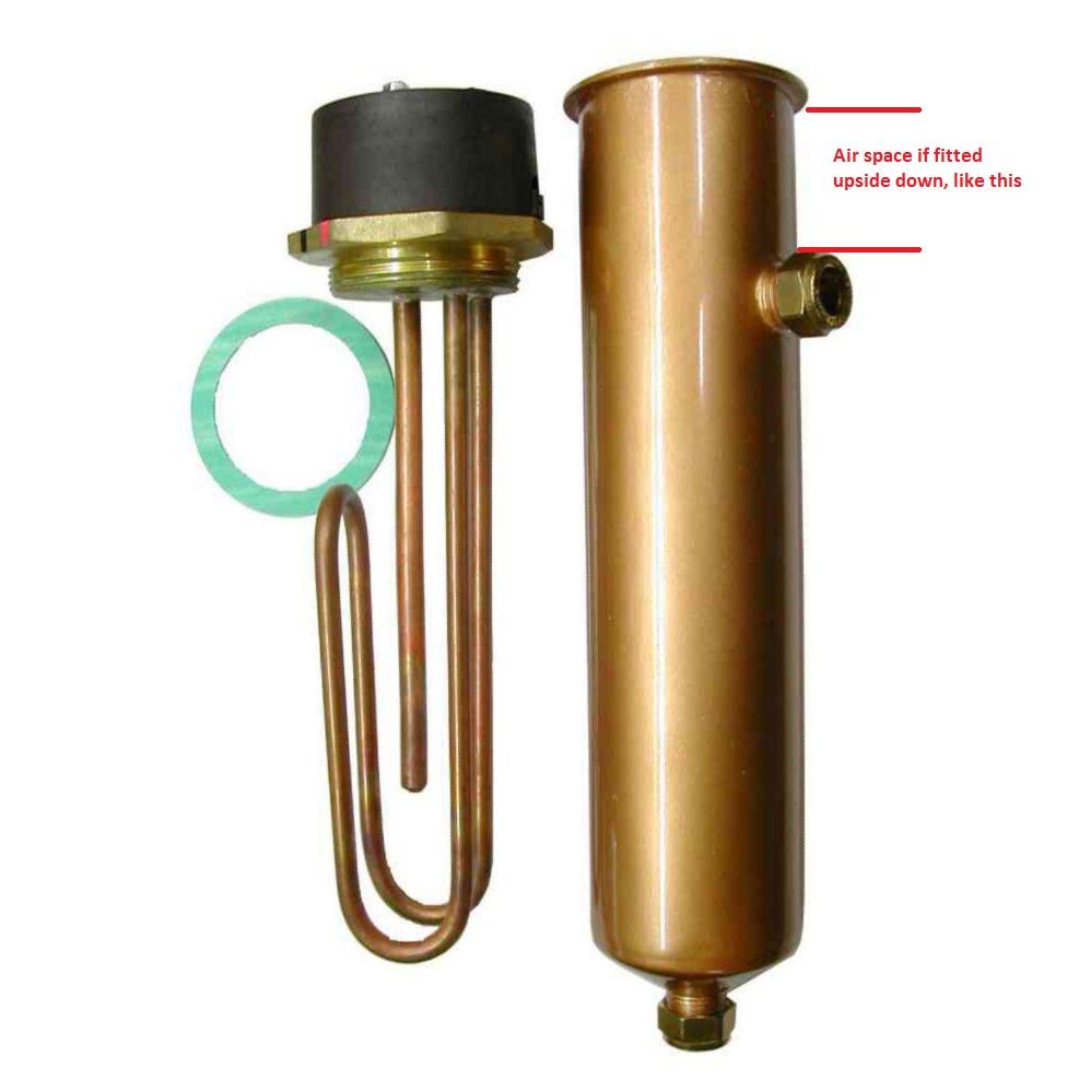

There is a problem with fitting them upside down, in that it creates an air pocket that cannot be easily bled, which then means that a part of the immersion heater element is running in air, so likely to overheat locally and probably have a shorter life than it should.  This is best illustrated by looking at a Willis heater with the insulation removed, where the problem is pretty obvious.  This is an upside down photo, annotated to show where the air pocket will be:
557572944_Willisheater-upsidedown-annotated.thumb.jpg.ed018ba450fa55c65a77f92a450c32f9.jpg

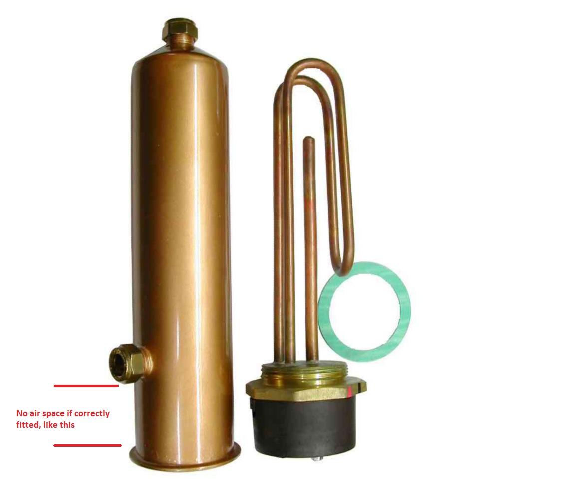

and this is the same photo, but with the Willis heater correctly oriented, so there can be no air pocket:

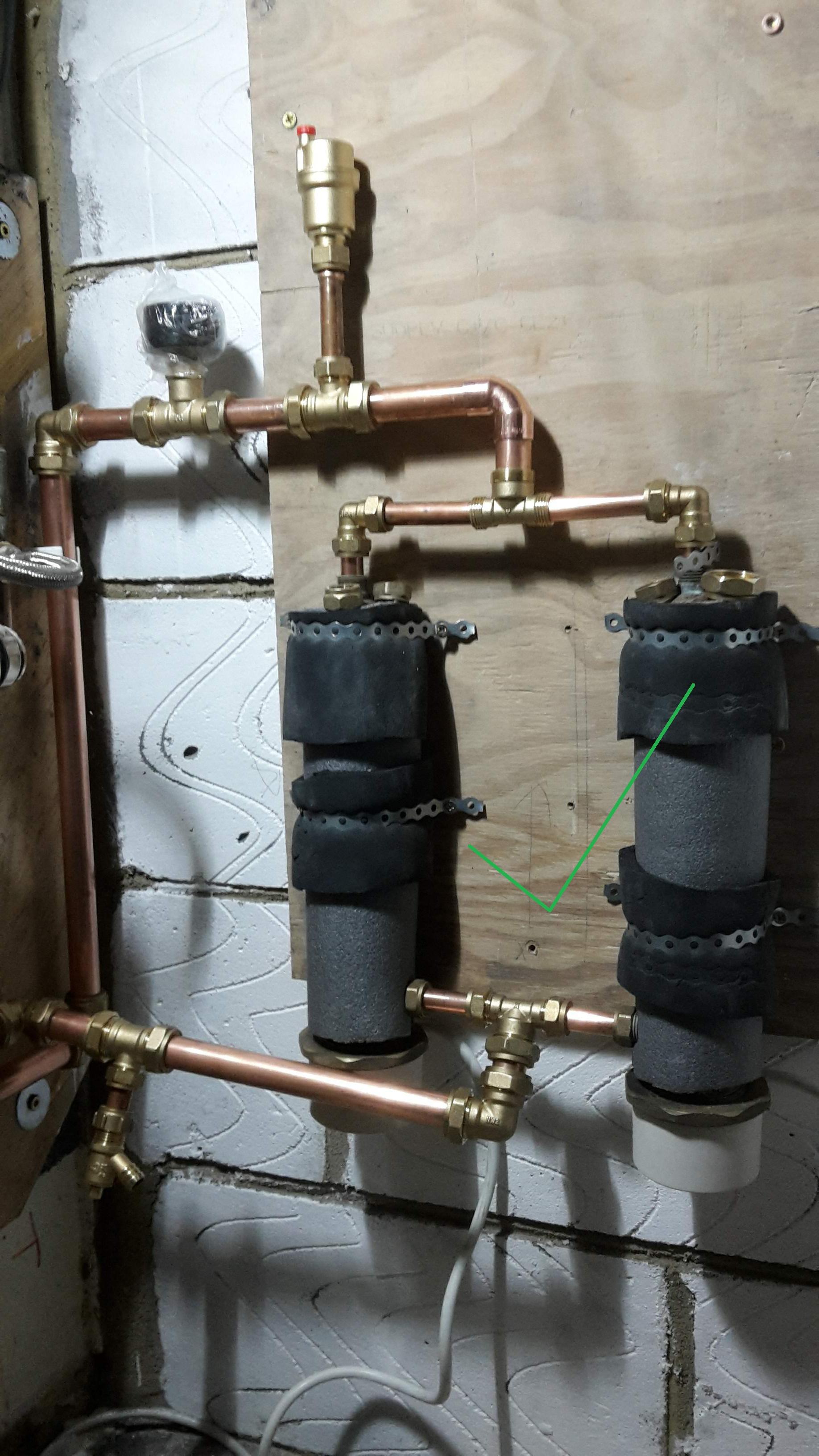

So far, the only photo I've seen on this forum with Willis heaters correctly oriented is this one (nice job @oranjeboom !):
In addition to the risk of premature failure of the element by having an air pocket when these things are fitted upside down, I suspect that the electrical connections may well run hotter than intended (no water just under where they are to keep them cooler) and there may also be an increased risk of corrosion from the air trapped in the pocket.
If anyone is using Willis heaters in an unusual configuration, given that they are ideal as a way of providing a simple heat source for low power UFH, then it's probably worth checking to make sure they are installed the correct way up.  Willis never intended them to be used for anything other than the configuration shown in the diagram at the top of this post, and so probably didn't think that anyone might consider fitting them upside down.  IMHO they could be better labelled, too, but I have a feeling that they are now made by several companies, rather than just Willis, so getting them clearly labelled etc may not be that easy.
Thanks, Jeremy, good to have this on BH.
On the other hand, looks like I need a new plumber!
