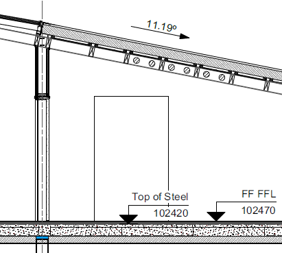

Triassic Posted January 14, 2020 Posted January 14, 2020 (edited) I'm struggling and need your input. I've rather foolishly designed and build a large volume house. The Kitchen / family room, the master and second bedrooms all have cathedral ceilings, as do two of the en-suites! I send my drawings to a number of MVHR suppliers who offer design services and got three quotes back, each one was different in what was specified and none provided technical detail around calculations. The simplest design was a single MVHR unit and at the other end of the scale, they specified two of the largest units on the market. I'm now thinking I need to do my own calculations and try and clearly identify what is required to meet Part F of Building Regulations. From what I've read in Part F, the Whole house Ventilation Rate is 25 l/s (based on 4 bedrooms), however, the minimum based on floor area is 114.58 l/s. Having done a spreadsheet (below) it would appear that I need more air extraction to meet the minimum ventilation rate? I assume the input air designed to balance the extract rate? Looking at the first of my quotes they suggest a single unit 650m3/h, the other quote suggest two units with a total 985 m3/hour. Am I on the right line here, or am I missing something? All help gratefully received!!!!!! Edited January 14, 2020 by Triassic 1

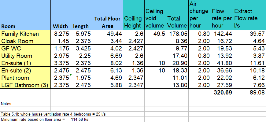

HerbJ Posted January 14, 2020 Posted January 14, 2020 See this Topic in which I give details of the way that my high volume MVHR system design was resolved. My system volume calculations, detailed by my MVHR designer, are included for reference. Looking at your volumes, I think my volumes are much higher and I have a single 450m3 MVHR which normally runs at less than 40% capacity. I hope it helps....... 1

HerbJ Posted January 14, 2020 Posted January 14, 2020 On reflection, it may have been useful to have an extract in the Dressing Room, but it is a small room after all the fittings were installed and the extract volume would have been very low. A through vent is a good idea . We also fitted an extract in the Plant Room, as an afterthought during the installation, as it was very easy. It is not in the original Design calcs but it is on the Commissioning Test Sheets.
Triassic Posted January 16, 2020 Author Posted January 16, 2020 (edited) @HerbJ thanks for the link, Sorry it’s taken me a while to get back on topic, I’ve been fixing cladding between rain clouds and airtightness membrane otherwise, Clearly I need to do some reading and more work to get to a more sensible answer. I emailed the two suppliers who quoted and asked for the rational for specifying two MVHR units, in both cases they said it was because it was a large house and needed two units! My house is around 380ms, including a large entrance hall, stairs and landings (60m2) over four floors. On first glance at your approach, am I correct in assuming you really only need to extract from those rooms listed in Part F and put fresh air into accommodation spaces such as bedrooms and lounges and things like stairwell can be discounted? Edited January 16, 2020 by Triassic

HerbJ Posted January 17, 2020 Posted January 17, 2020 (edited) On 16/01/2020 at 20:04, Triassic said: On first glance at your approach, am I correct in assuming you really only need to extract from those rooms listed in Part F and put fresh air into accommodation spaces such as bedrooms and lounges and things like stairwell can be discounted? Expand Yes, that is correct. Stairwells and corridors, etc (rooms not normally habitable are not discounted as such, but benefit (and provide the conduit)from the airflow going from living spaces (supply air) to wetrooms - kitchens, utility rooms, bathroom and toilets. That's why it's important to balance supply and extract volumes. Also , why all doors should have the ability to allow airflow bypass/transfer pat all the doors when closed, . I believe stairwells, corridors etc are characterised as" overflow" spaces" in DIN standards and on my MVHR volumetric data sheets as "Vthrough". That being said, it is not unacceptable to put a supply/extract duct in a hall. For instance, I am aware that @Jeremy Harris installed an extract grill in the his hall, outside the kitchen door to assist with minimise kitchen smells being drawn though this overflow space and into the rest of his house. I haven't found this an issue or need with my MVHR design! Edited January 17, 2020 by HerbJ

Triassic Posted January 17, 2020 Author Posted January 17, 2020 On 17/01/2020 at 13:17, HerbJ said: I believe stairwells, corridors etc are characterised as" overflow" spaces" in DIN standards and on my MVHR volumetric data sheets as "Vthrough" Expand Have you published your data sheet on here? I don’t recall seeing one that included Vthrough?
HerbJ Posted January 17, 2020 Posted January 17, 2020 Yes, it was attached to my post in the Topic started by @ProDave above that I referenced on Tuesday. To help you, I have attached again. 38167 HRV Volumetric Design 2015-4.pdfFetching info... 1
