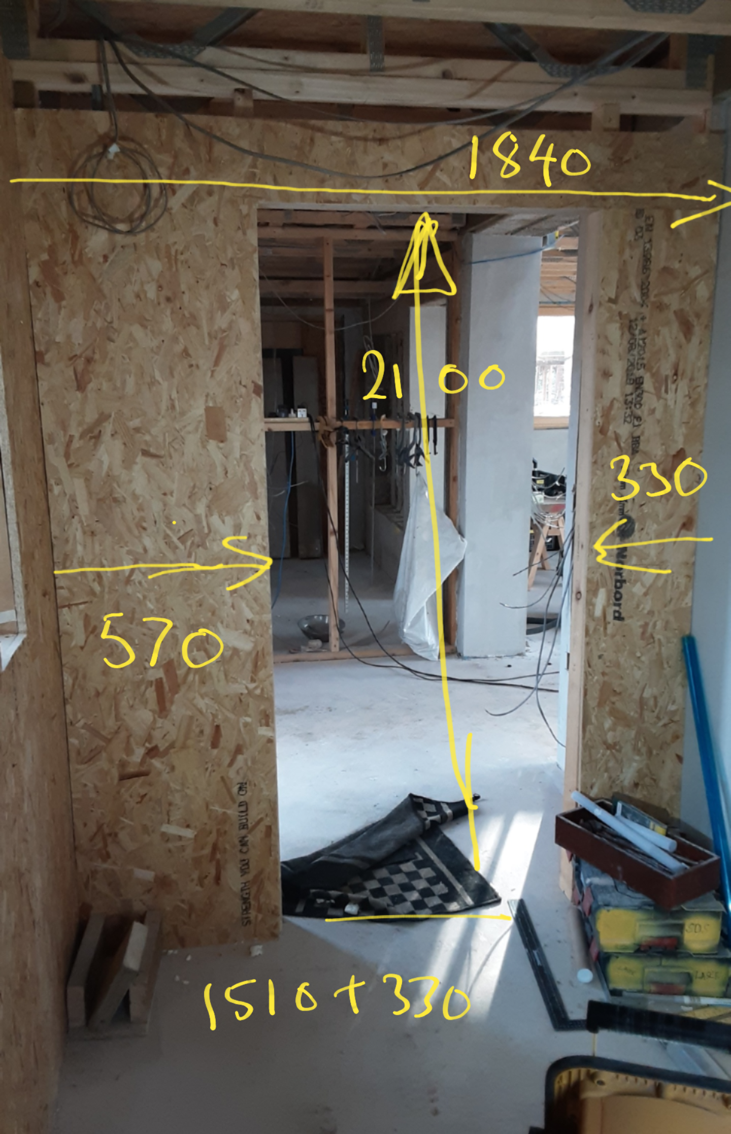

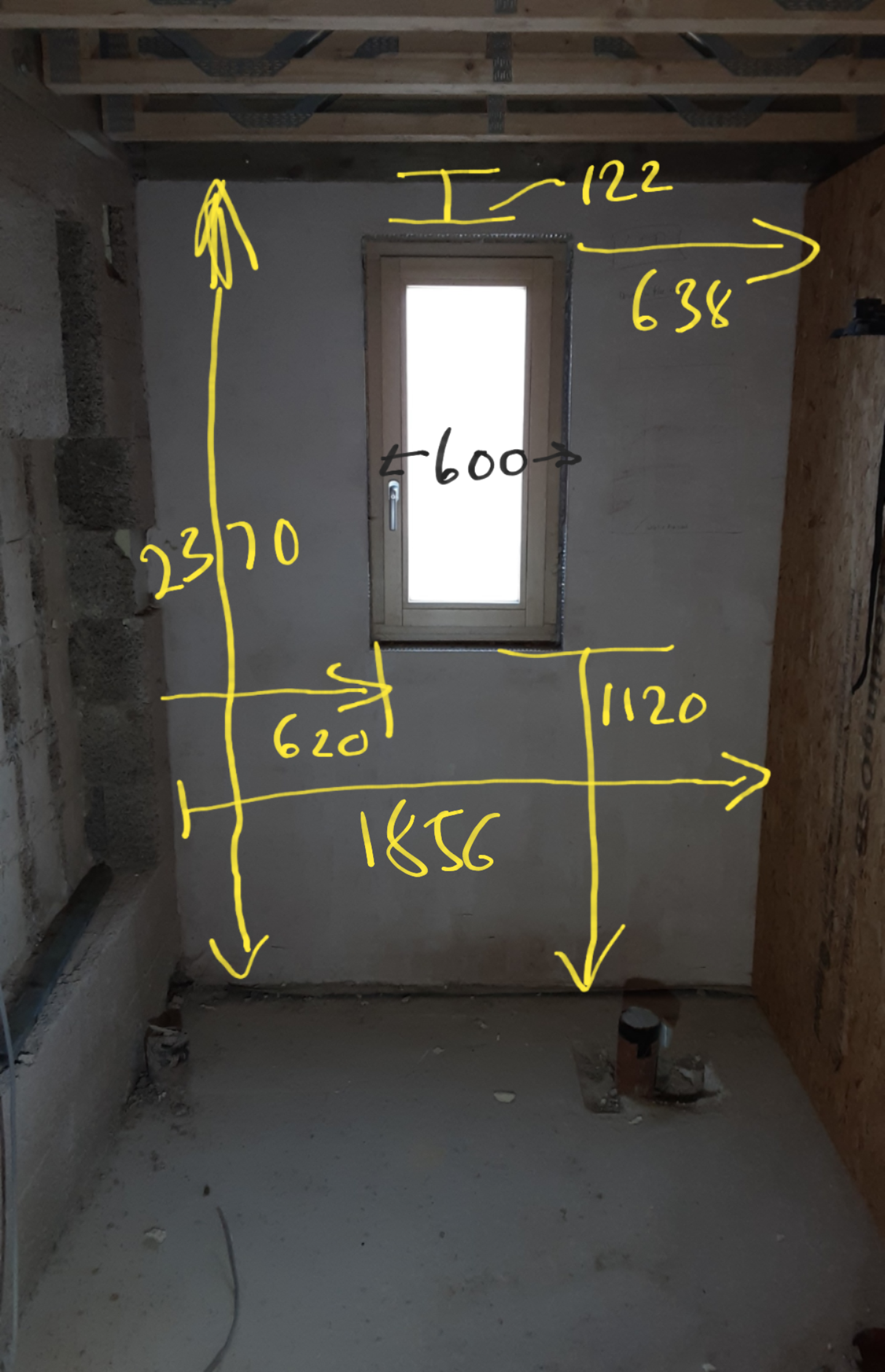

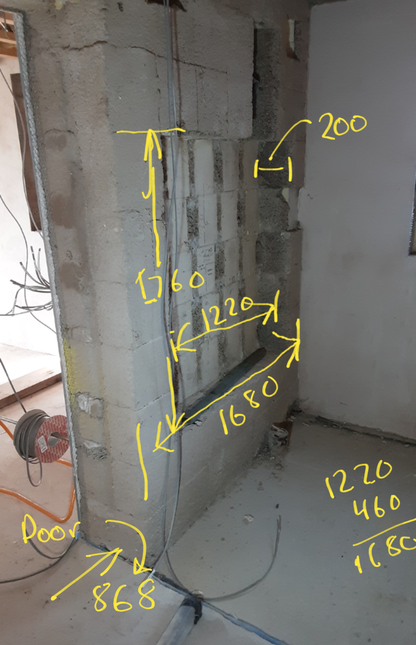

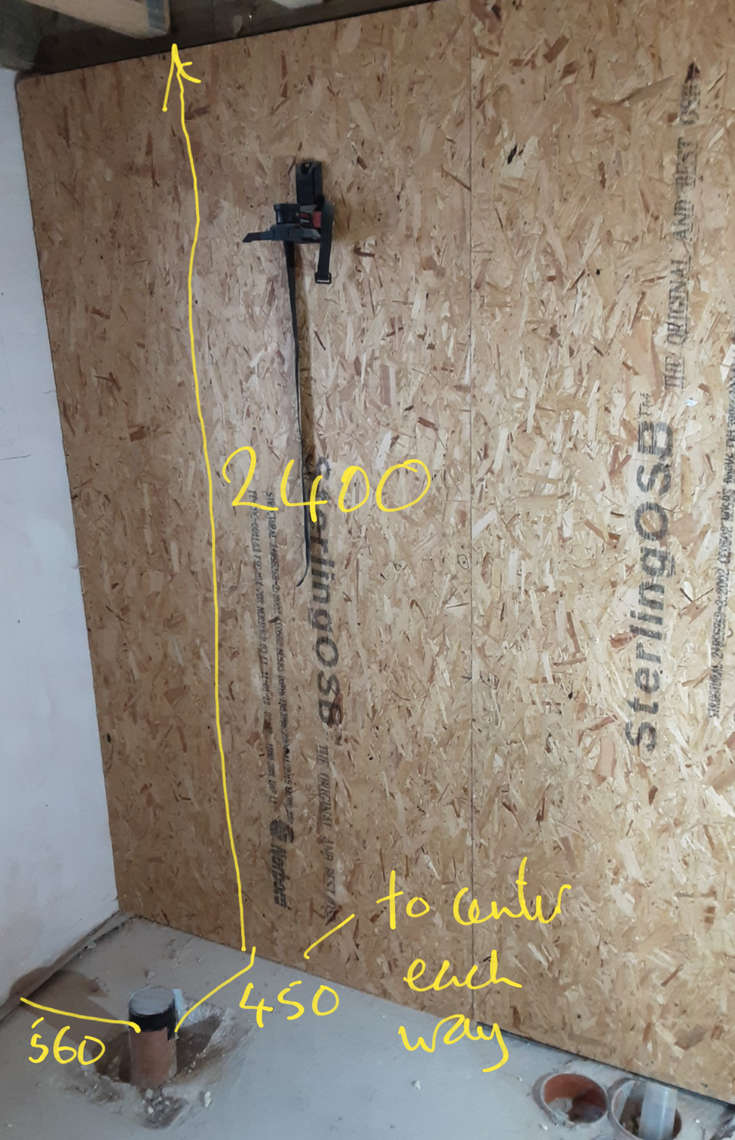

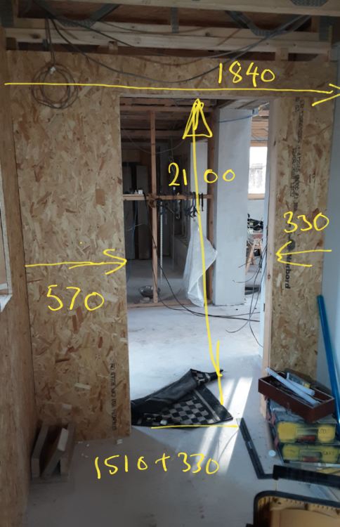

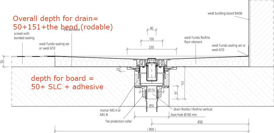

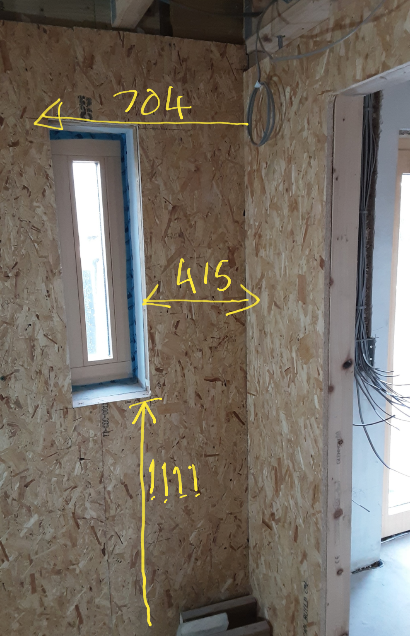

ToughButterCup Posted January 7, 2020 Share Posted January 7, 2020 Our wetroom. I feel sick. And for months I have been doing other jobs instead - not that there's any shortage of them. But this particular one fills me with dread. Here goes. What have we got? This..... The North wall The south wall The east wall The west wall ( all bar a little bit) and we'd like to use a Wedi Riofino base for the shower bit - like this I dont know how many times I have dipped my big toe into @Onoff's posts - many many times. And while its been instructive, its also itemised what I can get wrong. Geberit Sigma frame and AquaClean Tuma already bought. And a small Geberit hand wash basin. SWMBO has the tiles detail. Small area of electric underfloor heat ( a square meter or so) On the east wall, we'd like Multipanel. Elsewhere tiles. Lets start with a simple question: walls before floor or the other way round? 1 Link to comment Share on other sites More sharing options...

Oz07 Posted January 7, 2020 Share Posted January 7, 2020 Think a plan sketch be better for others to advise. Mark window door way drains etc Link to comment Share on other sites More sharing options...

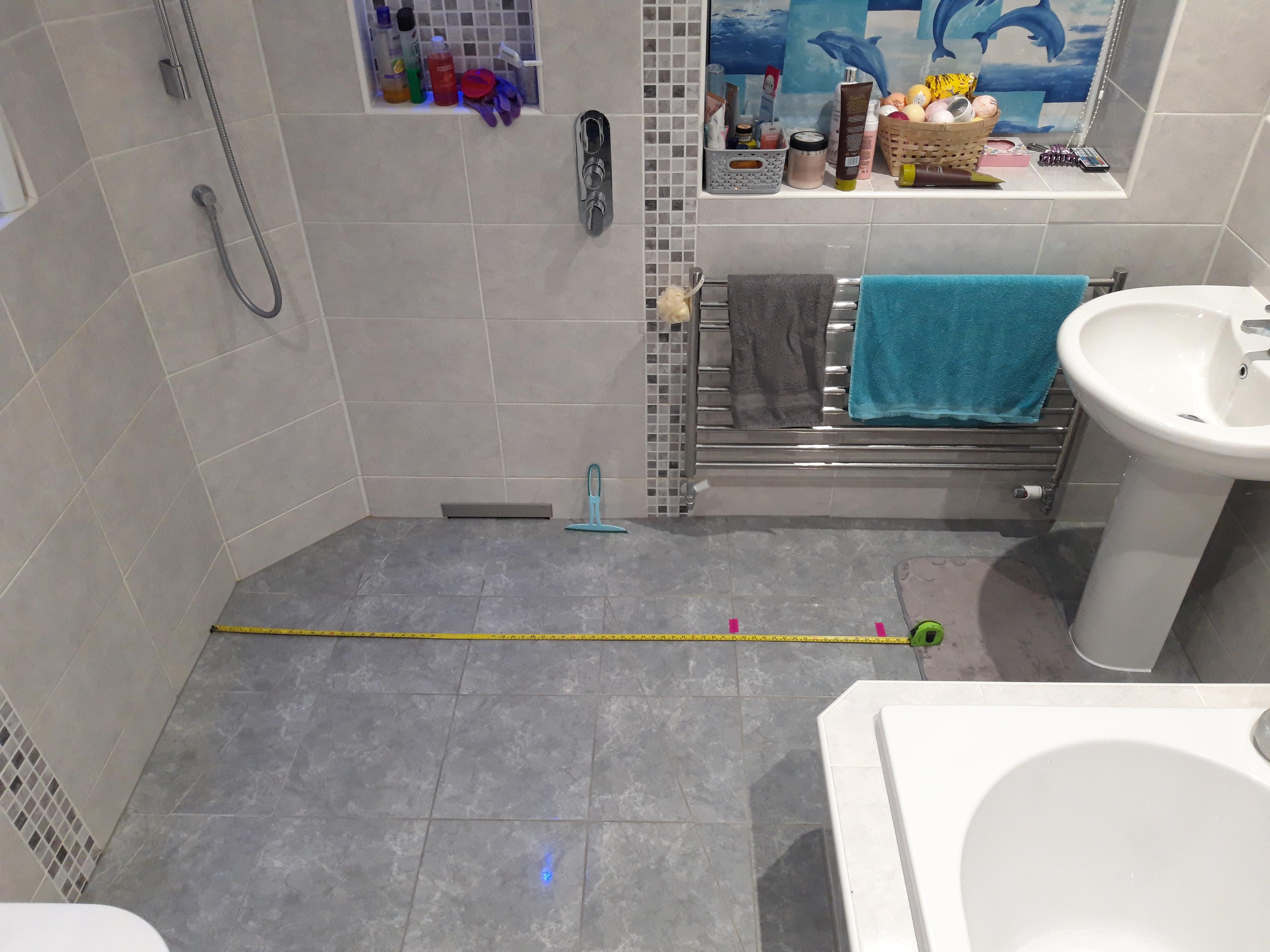

Onoff Posted January 7, 2020 Share Posted January 7, 2020 (edited) I did cut one corner... Don't underestimate how far water will spray if you're not having a screen. My wet room corner is 1.4 x 1.4. 2mx2m would have I think been just right. So glad I tanked the complete floor. Edited January 7, 2020 by Onoff Link to comment Share on other sites More sharing options...

ToughButterCup Posted January 7, 2020 Author Share Posted January 7, 2020 30 minutes ago, pocster said: Have a screen. [...] Yes, read that. But, but but. I'm living with mistakes made long ago. The configuration of both the foul wastes and the window (smack bang in the centre of the north wall) together mean that we cant have a screen. But - to get through the Regs - we will need a screen of sorts. We will erect a temporary shower curtain, wait until sign off, and then take it down. Which is why I am grateful for @Onoff's advice (and others) to tank the place to oblivion 1 Link to comment Share on other sites More sharing options...

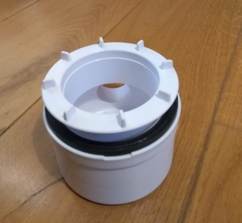

Temp Posted January 7, 2020 Share Posted January 7, 2020 I love plumbing...not... I'm currently working on an en-suite we never finished when we built the house. The pipe in the floor is Osmaweld grey but nobody seems to sell the other bits I need in grey locally. I figured white bits would be fine as it's all under the tray/floor. Wrong. It seems Osmaweld white and grey are slightly different sizes. The short length of Grey 40mm pipe I have is a bit too loose in a white 50-40mm adaptor for comfort. And yes its all same make and all solvent weld. Another 30 mile round trip tomorrow I guess Link to comment Share on other sites More sharing options...

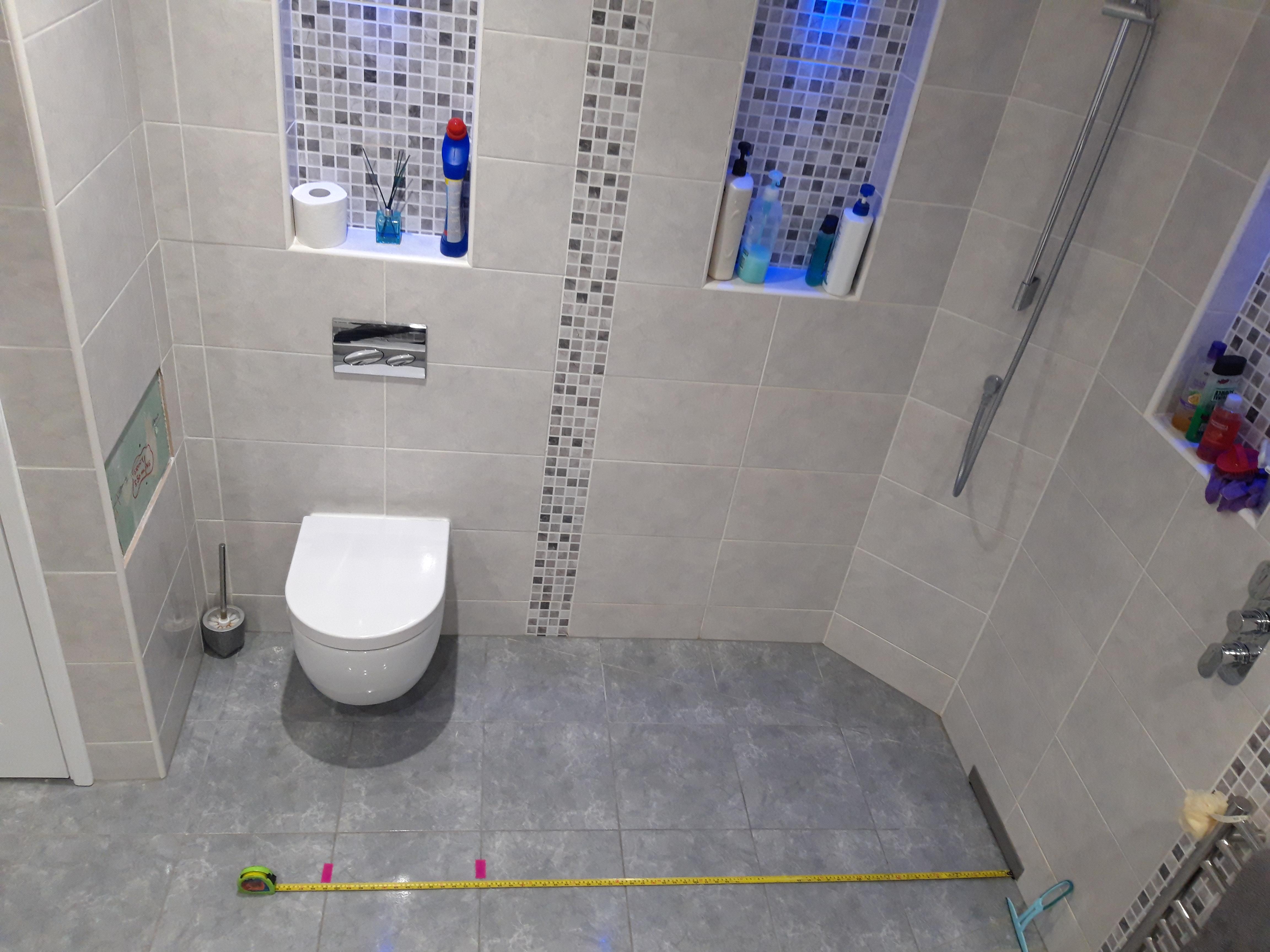

Onoff Posted January 7, 2020 Share Posted January 7, 2020 I went into this knowing nothing other than I wanted a rainfall head as well as a handset riser. The mitred corner with the handset riser came later as did the decision to go no tray. The intent has always been to put a screen or pair of folding doors on the vertical mosaic strips that are strong points if it becomes an issue. The Union Jack tiled area is 1.3 x 1.3m, the first bits of pink tape. The reality is the water splashes a bit another tile over so to about 1.7m - the second bit of pink tape. To be safe 2m x 2m would be a good area in my opinion. So the seat of the wc gets a few splashes. After a shower we'll just kick the towel around the floor. We like it and it's manageable, all the time that is we're able to bend after our shower and squeegee the floor that is! 1 Link to comment Share on other sites More sharing options...
