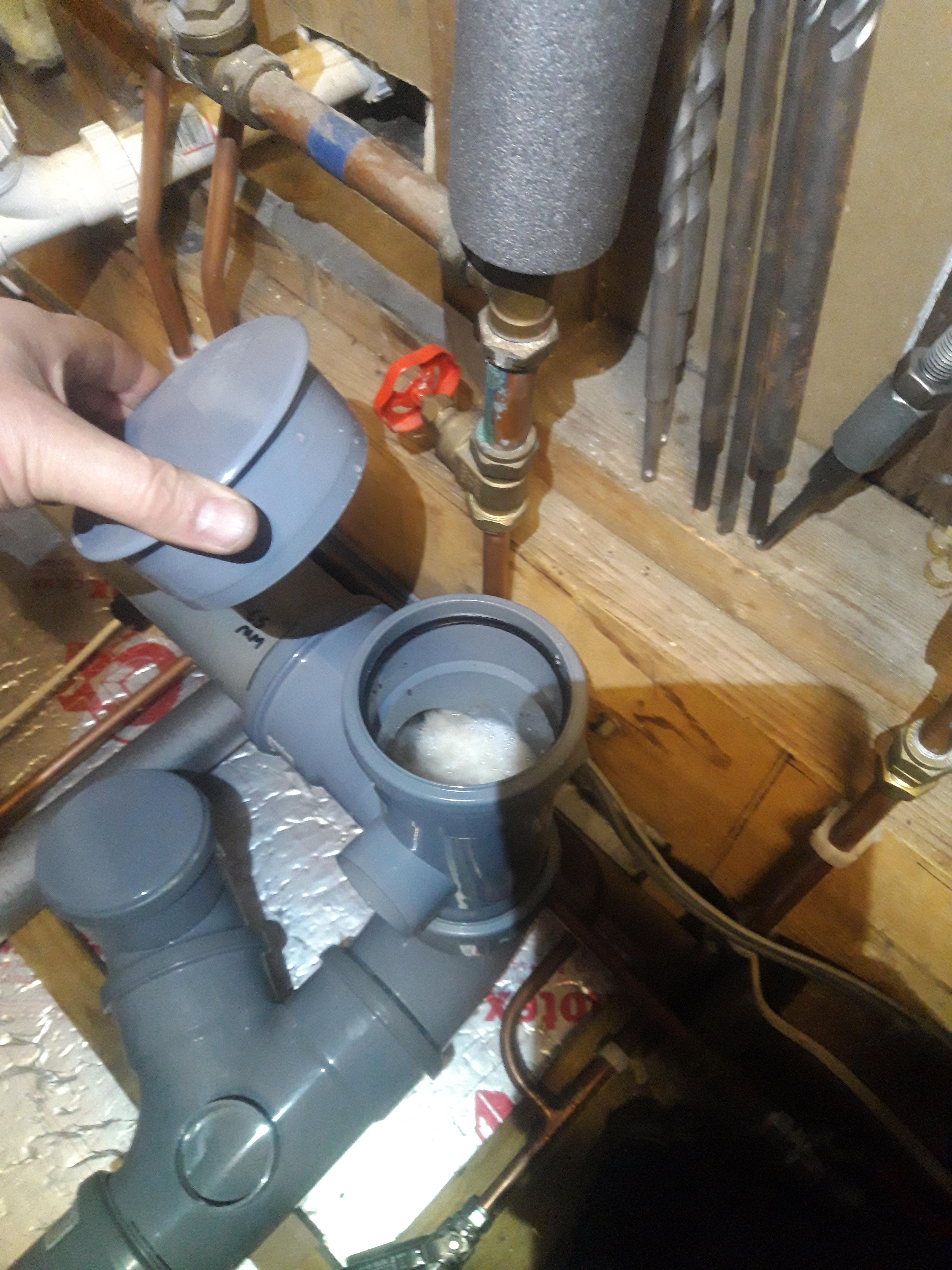

Onoff Posted January 5, 2020 Share Posted January 5, 2020 The upstairs en suite has a blockage! Not really been right since the cess pool needed emptying and backed up. Water will eventually drain but not paper. Tbh the 110 soil runs in the loft are a bit ad hoc, modded as I've been doing the new downstairs bathroom. WC waste comes straight thru from the en suite into the loft hip end on the left of the picture. Theres an AAV just out of picture. Comes across in the grey at a few degrees slope. Drops and turns thru 90deg through the two branch arrangement to the right: Then straight along at a few degrees slope again: Out the eaves at the end and straight down the wall. Pretty sure the blockage is in the near horizontal runs or that double branch arrangement. Was going to try a cup of washing up liquid down the pan first followed by a bucket of hot water down the pan. If things don't shift I've just bought a bath bomb for some fizzy, effervescent, sh!t shifting action! Was tempted to remove the AAV and drop it into the run there i.e after the wc trap. Slightly worried it might force the joints apart! Any suggestions? Ta. Link to comment Share on other sites More sharing options...

Russell griffiths Posted January 5, 2020 Share Posted January 5, 2020 You have two capped off sections there, have you not opened them up for a bit of turd watching. 1 Link to comment Share on other sites More sharing options...
Onoff Posted January 5, 2020 Author Share Posted January 5, 2020 3 minutes ago, Russell griffiths said: You have two capped off sections there, have you not opened them up for a bit of turd watching. Just done so...pictures to follow! ? 1 Link to comment Share on other sites More sharing options...

Onoff Posted January 5, 2020 Author Share Posted January 5, 2020 10 minutes ago, Declan52 said: Be better than watching dancing on Ice later on. @Onoff performing La Fontaine de Merde... Pre flushing I could take the lower cap out and see that pipe going off to the left, the lower, flatter one was blocked up. Post flushing and the level rises to as shown below. In the absence of any sodium hydroxide I've thrown a cup of car shampoo in, hopefully to soften things up a bit and maybe cut through some fats. When it goes down I'm going to drop this in and get SWMBO to tip a bucket of hot down the pan whilst I hang on for dear life to these push fit joints. SDS bits I've just noticed could come in handy! ? Gotta have date nights like this to keep the romance alive! Link to comment Share on other sites More sharing options...
Onoff Posted January 5, 2020 Author Share Posted January 5, 2020 It's now had 1 cup car shampoo, 1kg of soda crystals and a bath bomb dropped down the upper cap as above. Followed by a bucket of hot down the pan. No movement as yet. Not much fizzing either. Maybe I'll hear a big WHOOSH in the middle of the night! Interestingly and I presume its correct but as I push in / take out the cap the AAV click-clacks. Failing that I'll get some sodium hydroxide tomorrow. Link to comment Share on other sites More sharing options...
