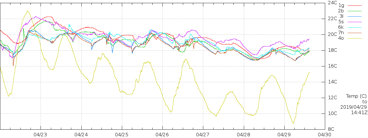

DamonHD Posted December 29, 2019 Share Posted December 29, 2019 As with @SteamyTea in the past I've played around a fair amount with some of this kit (I have a small X-10 graveyard somewhere) and lost interest. For gathering sensor data I use my OpenTRV / Radbot gear which is out of the way on each rad and does the (in this view) bonus job of saving a pile of carbon emissions. My profile pic and the attached an example of the kind of data I collect (temperature, light, RH%, occupancy, ..) up to a sample per 2 minutes. Link to comment Share on other sites More sharing options...

DamonHD Posted December 29, 2019 Share Posted December 29, 2019 2 hours ago, SteamyTea said: What do you use to collect that and is it just On or Off. Or a real unit reading. Same with occupancy. How is that done and does it record None, Some or Many. Or an actual number. Light is an uncalibrated non-linear 0 to 255 reading, but is very very roughly lux. (Radbot learns the typical patterns for its location, so absolutes are less important.) Occupancy is 'active' occupancy of the zone around it (ie someone is up and may be moving around) and is critical to OpenTRV/Radbot energy saving. We're actually pretty good (eg as an F1 score), but always working on improving the algorithm. You can see the OpenTRV reference code in GitHub. The number isn't a count, but basically a live probability from 100% humans about down to 0% probably no one home but us chickens. But OpenTRV/Radbot also uses its memory of recent behaviour to get a room warm if it thinks that you're usually around at this time, or likely to be soon. Link to comment Share on other sites More sharing options...
