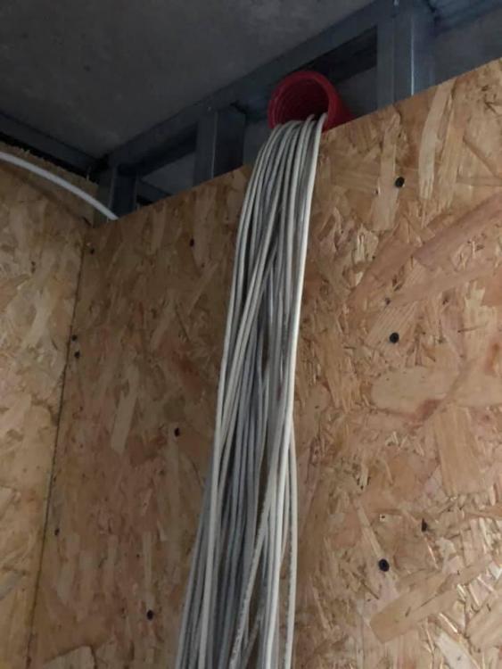

puntloos Posted December 28, 2019 Share Posted December 28, 2019 Just a bit of an errant thought, but which things feature in pretty much every room, and how do you make clever use of this 'repeating fact'? I realise this might be a bit of a 'smart home' question but there could be other things too. For example: - Networking cable, and perhaps a few "boxes in the wall" that can fit a router and allow me to open up an ethernet port here and there 'on demand'? - Ceiling speakers? (not a fan myself but you know.. resale..) - Water line? (with a small baby, can't express how useful a tap is in the baby room) - HDMI cable from one wall to another? (so one could hang a TV on one wall and 'drive it' from another device? - Switchable room power line (so you can turn an entire room off, and perhaps measure power usage - "no dad, I'm not watching TV.... - oh really?....") - Heating control? Is this even a thing with ASHP? - Window/shutter control? - Box of Sensors embedded at a strategic place? I'm thinking primarily temp and humidity, perhaps movement, not camera. I noticed that putting a temp sensor on the floor is next to useless, so this box probably needs to be at 1m50 somewhere? Link to comment Share on other sites More sharing options...
ProDave Posted December 28, 2019 Share Posted December 28, 2019 I put multiple CAT5 cables to every room, Currently only ONE is in use, to give a hard wired ethernet to the desktop pc. The rest are there for "the future"? I am not convinced ceiling speakers will please my ears, I opted for traditional proper hifi speakers in the main rooms. I have burried hdmi cables to the main tv's to put most of the "tv boxes" in the under stair cupboard. My only concern going forwards is what will be the next must have cable after hdmi? That's when I find out if my planned route to pull a new cable through works or not. Put in MORE than you think you need. Don't forget surround sound speaker cables for the main room(s) I am not a fan of a spy in the room that you talk to to do things (and listens to you all the time). I am too much of a dinosaur. We have hard wired wall thermostats in the three downstairs rooms and a simple heating programmer on the wall in the utility room. I wired a dual rate electricity meter specifically to meter electricity separately for heating and DHW use by the ASHP so I know the exact running cost of each. Link to comment Share on other sites More sharing options...
puntloos Posted December 28, 2019 Author Share Posted December 28, 2019 4 minutes ago, ProDave said: I put multiple CAT5 cables to every room, Currently only ONE is in use, to give a hard wired ethernet to the desktop pc. The rest are there for "the future"? Yeah, I don't know what physical limits I have to contend with - how many cables can you put in a wall? At *some* point there's no more space, surely? 4 minutes ago, ProDave said: I am not convinced ceiling speakers will please my ears, I opted for traditional proper hifi speakers in the main rooms. Yeah, exactly my idea.. - although it depends on how fancy ones you buy. In the main rooms 'height' speakers are actually a thing for convincing surround so I'm building those, but perhaps cables to prep for philistines in all others? 4 minutes ago, ProDave said: I have burried hdmi cables to the main tv's to put most of the "tv boxes" in the under stair cupboard. My only concern going forwards is what will be the next must have cable after hdmi? That's when I find out if my planned route to pull a new cable through works or not. Put in MORE than you think you need. Don't forget surround sound speaker cables for the main room(s) Oh don't you worry, that part I have fully specced out for 7.3.4 4 minutes ago, ProDave said: I am not a fan of a spy in the room that you talk to to do things (and listens to you all the time). I am too much of a dinosaur. Eh, funny, I actually forgot about those. Just to set the 'record' (ha) straight, they don't listen all the time, the whole reason for the 'Alexa' and 'google' words is that they have tailored hardware that exclusively listens for that word alone. If the word occurs, then and only then will the rest of the device power on, send it to the cloud for parsing etc.. 4 minutes ago, ProDave said: We have hard wired wall thermostats in the three downstairs rooms and a simple heating programmer on the wall in the utility room. I wired a dual rate electricity meter specifically to meter electricity separately for heating and DHW use by the ASHP so I know the exact running cost of each. Cool! Or hot. Link to comment Share on other sites More sharing options...

SteamyTea Posted December 28, 2019 Share Posted December 28, 2019 20 minutes ago, ProDave said: I put multiple CAT5 cables to every room Do you really need multiple cables. Surely 1 cable and a switch/router in each room. But really, why do you need everything wired up, surely a home should be, to a certain extent, a haven from the outside world. 38 minutes ago, puntloos said: Ceiling speakers? (not a fan myself but you know.. resale..) All I would see is holes that need filling. 40 minutes ago, puntloos said: Switchable room power line (so you can turn an entire room off, and perhaps measure power usage - "no dad, I'm not watching TV.... - oh really?....") Remote parenting. Not really how it is meant to work. 41 minutes ago, puntloos said: Box of Sensors embedded at a strategic place? I'm thinking primarily temp and humidity, perhaps movement, not camera. I noticed that putting a temp sensor on the floor is next to useless, so this box probably needs to be at 1m50 somewhere? It it in with the MVHR, and a light sensor may be of use. But be better off just going basic and accepting that every no wand again life is not perfect, in my opinion. Link to comment Share on other sites More sharing options...
ProDave Posted December 28, 2019 Share Posted December 28, 2019 2 minutes ago, SteamyTea said: Do you really need multiple cables. Surely 1 cable and a switch/router in each room. But really, why do you need everything wired up, surely a home should be, to a certain extent, a haven from the outside world. multiple cat 5's was an attempt at future proofing. More for non network stuff, e.g 2 cat 5's and the right adaptor at each end = an hdmi link. The spare cat 5's just might do when the next thing after hdmi comes along and I want the next tv standard linked back to my AV cupboard. Link to comment Share on other sites More sharing options...
