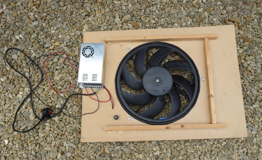

SteamyTea Posted December 22, 2019 Share Posted December 22, 2019 41 minutes ago, DavidHughes said: Have an air tightness test done How much does this cost for a 100 m^2 bungalow Probably around £250. I think that is what the guy that did @joe90 said he charged. Or make your own test rig. 1 Link to comment Share on other sites More sharing options...
Ed Davies Posted December 22, 2019 Share Posted December 22, 2019 29 minutes ago, SteamyTea said: Or make your own test rig. Making a test rig to help find leaks is pretty easy - quite a few people have done it including a few on this forum. Car fan, bit of MDF and some sticky back plastic. Some pressure measurements to compare before and after leakage is a bit harder but quite doable. Getting actual flow rate measurements to a sufficient level of calibration to be confidently comparable between houses or against standards (building regs or Passivhaus) is a bit trickier I think. 1 Link to comment Share on other sites More sharing options...
SteamyTea Posted December 22, 2019 Share Posted December 22, 2019 (edited) 22 minutes ago, Ed Davies said: Getting actual flow rate measurements to a sufficient level of calibration to be confidently comparable between houses or against standards (building regs or Passivhaus) is a bit trickier I think Isn't that when the MVHR, air flow meter comes in handy. On the rig @joe90's the guy blocked off holes, of known area, to settle the fan speed. Measuring the airflow through the holes would give the volume. A few hours testing and for any given fan speed and pressure difference, a chart could be made up. Edited December 22, 2019 by SteamyTea Link to comment Share on other sites More sharing options...
joe90 Posted December 22, 2019 Share Posted December 22, 2019 Yes my chap charged £250. Link to comment Share on other sites More sharing options...
Jeremy Harris Posted December 22, 2019 Share Posted December 22, 2019 51 minutes ago, Ed Davies said: Making a test rig to help find leaks is pretty easy - quite a few people have done it including a few on this forum. Car fan, bit of MDF and some sticky back plastic. Some pressure measurements to compare before and after leakage is a bit harder but quite doable. Getting actual flow rate measurements to a sufficient level of calibration to be confidently comparable between houses or against standards (building regs or Passivhaus) is a bit trickier I think. Spot on, this is what I made up to find air leaks in our old house: It's made up from an old car radiator fan, fitted to a bit of MDF that was cut to be a tight fit into an open window. I had to replace the motor, as the original was rusted up, so fitted a model aircraft brushless DC motor, with speed controller. This gave pretty fine control of fan speed, which turned out to be quite useful. I did try to make a differential pressure measurement unit, together with a pitot-type flow sensor, with the intention of being able to display and log leakage, but the leakage from the old house was so great, even after replacing all the doors and windows, and sealing up around all the leakage areas I could find, that I felt it just wasn't worth the effort. The unit was very useful for finding all the many leaks, though. Some made their presence felt by the noise they made, others had to be pinned down using smoke (I used some joss sticks for this). After weeks of work I never did manage to make our old early 1980's built, block and brick, bungalow very airtight, as there were just too many big, inaccessible leaks. Link to comment Share on other sites More sharing options...
ProDave Posted December 22, 2019 Share Posted December 22, 2019 And this was my effort, an old 12" desk fan, some cardboard and a roll of duct tape, It was stuck in the door between the house and the garage which is the only one that was not a proper sealed outside door. It could build up a reasonable pressure, enough to go looking for leaks (not many found) and get an idea of performance. The telling thing was if you opened a door or window with the blower running you could feel the blast of air escape and the pressure change. Link to comment Share on other sites More sharing options...
Onoff Posted December 22, 2019 Share Posted December 22, 2019 (edited) Finally, a use for this! ? Edited December 22, 2019 by Onoff Link to comment Share on other sites More sharing options...
Ed Davies Posted December 22, 2019 Share Posted December 22, 2019 @ProDave, what are the pipes taped bottom left of your cardboard? Field-expedient manometer? Link to comment Share on other sites More sharing options...
ProDave Posted December 22, 2019 Share Posted December 22, 2019 39 minutes ago, Ed Davies said: @ProDave, what are the pipes taped bottom left of your cardboard? Field-expedient manometer? Yes that's the manometer from my drain test kit. One hose inside the house, the other through the cardboard to outside to try and measure the pressure differential achieved. Link to comment Share on other sites More sharing options...
Ed Davies Posted December 22, 2019 Share Posted December 22, 2019 Did it work? 50 Pa is only a head of just under 5 mm (unless I've got the arithmetic wrong). Link to comment Share on other sites More sharing options...
