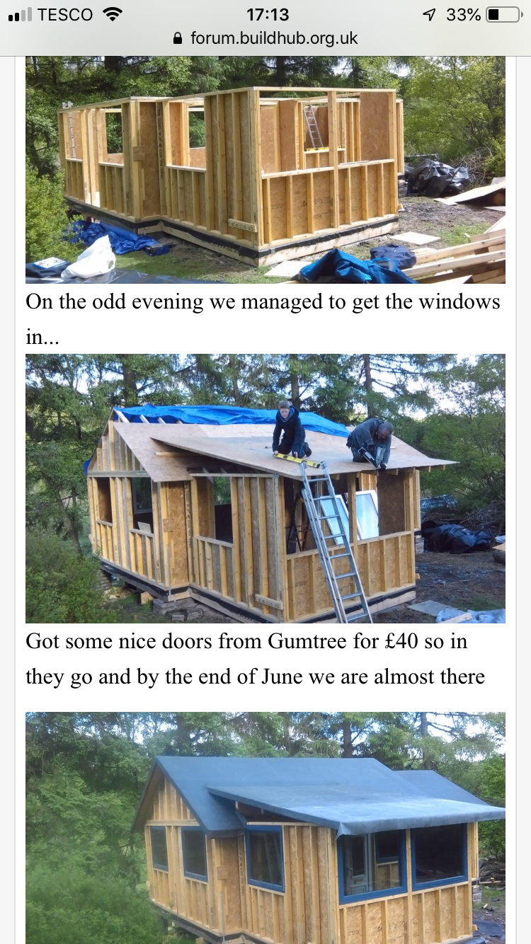

Tennentslager Posted December 7, 2019 Posted December 7, 2019 This is not a house but I kept my panels to 3m which one person can just about lift, easy with two. Blog here I did have plenty of ramblers passing by who were happy to help... the memorable ones where the three generations of Norn Irn farmers who knew masses about building, hands like shovels too! Three 90+ ladies ( I kid you not) from Palm beach, Florida dressed in pastel terry towelling jump suits and full make up (they declined to help lift OSB to the roof) but had very negative things to say about the then Republican nominee, The Donald. One lady was a retired property attorney with direct experience of him welching on a deal and not paying his debts... And finally the couple of twenty something pony tailed nurses from Sussex who did help lift a panel onto the pile but seemed fairly suspicious of the motives of the middle aged man asking for a hand, oops. They didn’t take their rucksacks off or stop for a blether either Happy days if you work in the spring/summer and even better if you have some help now and then? 1
Tennentslager Posted December 7, 2019 Posted December 7, 2019 8 minutes ago, Coops said: Thanks Hobiniho I'd most likely use a combo of glue, screws and nails, I'd need to get my SE to specify connections. In terms of building , I'd probably go with a large gazebo set up, on top of the slab. I do also have a small workshop on site. The doing bit isn't the issue for me, framing's fairly simple, what's more difficult is establishing if it's actually commercially viable to do it all myself when compared to a specialised TF company. Fleming have quoted 48k to fabricate and install based on PP sketches....Could I actually purchase the material and do it myself for that kind of money? Without the benefit of accurate MTO's from CI drawings it's impossible to cost up. Does anyone have any thoughts on what kind of a saving (if any) I could make? Cheers Joiner mate priced this sort of thing a decade ago and concluded he could not come anywhere near the TF company by doing it himself If your labour is free, that’s different
