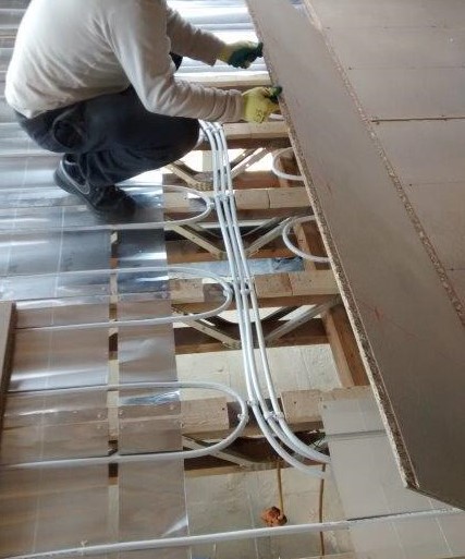

First and foremost, FIT THE UFH FIRST WHENEVER YOU CAN !
Retrofitting from underneath is simply hard work. @Bitpipe was in the same boat as you, but I managed to nudge him into 'doing the right thing' and he put his plates and pipe in as the build went up. MBC lads joined in and helped ( took over iirc ) to lay it and it saved a LOT of grief.
The ideal set of events would be to allow for your posi-joists to have an 18mm batten atop, and then plates. The batten is required to allow you to cut the end for the pipe to transverse joist space to joist space as posi-joists can't be cut. Not a problem with regular joists btw.
The main thing, either way, is to make sure the plates are fixed up nice and snug. I use an air powered stapler to fix them to the underside of the deck material so the heat transfer ( promoted by surface contact ) is as good as it can get.
The only real tip for fitting from underneath is make sure you have a pipe decoiler, make sure you have at least 3 people on it, and don't be in a rush to do it. Pulling in 100m of pipe is a pain, kinking the last 10m piece and having to pull it all out and start again would be soul destroying. ;)
Cut a few short pieces of pipe and get used to the minimum bending radius, ( before the pipe kinks ), by trying to form 180o bends in the sample pieces. That'll give you an insight into how far you can & can't 'push' the pipe.

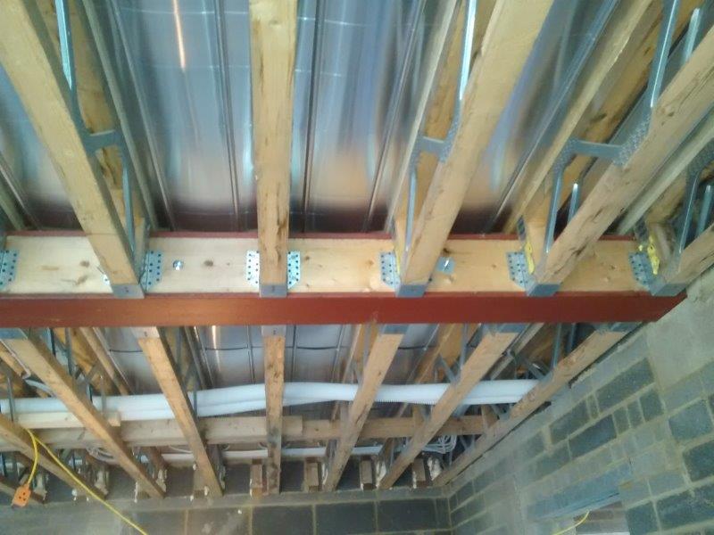

100% - we  threw down the UFH in a day and a half over our 100m2 suspended timber ground floor.
As Nick says, I looked into various options but using alu spreaders was the cheapest and the MBC lads were happy to help laying them down ahead of the floor deck - in fact they took over and put the pipe down also - I'm sure you can negotiate the cost of the pipe from MBC (same as you'd use in screed) and the plates are £3-4 each from UFH Superstore or Boulder. A few bacon sandwiches will grease the wheels here :)
100% on the de-coiler too. MBC will have one in the van usually if you don't want to hire or buy (and return if you 'forget' to use it :ph34r:).
Once the pipes were down, the 22mm deck board followed - in our case, rather than use battens we left out sections of deck where the returns came up over the pozi joist tops (held with a pipe clip) - its impossible to thread the pipe through the joist at each return. This was OK for us as we knew we'd be laying ply on top in prep for the resin floor - if you go the same way, allow an extra 12mm floor thickness.
Also did the stapling from underneath and everything was snug. Just watch when internal walls are fixed  to the floor and plumbers & sparks drill though the floor - they need to be constantly reminded abut the pipe underneath!
We have nearly 50mm floor build up in timber (22mm OSB deck and 21mm in ply) then 2mm rubber crumb and 2mm resin. Takes a while to warm up but has rarely come on so far with the air temp set to 21.
We don't have heating upstairs apart from towel rads and electric UFH in the bathrooms (very last min addition)  - spent pennies on the UFH - cheapest 100W/m2 mats from E-bay and they work a treat. Tiler was happy to throw them down as he went but make sure your electrician has made the necessary provision with ducting etc for the probe and tail of the mat.
Top tip - label the circuit pairs (and their location) before you commission the heating. We have 6 circuits downstairs, 5 on one stat and one on the other. Took some trial and error to isolate the one circuit - had to crank the heating up and send the cat off to find the warm spot.

We found dipping very tricky and gave up after the first loop. Instead we left out a long slot of deck where the loops crossed over the tops of the joists and then put ply over the top of this. Will see if I can dig out a pic.
If Brendan is on your job, he should remember what he did at mine - just remind him about the basement house.

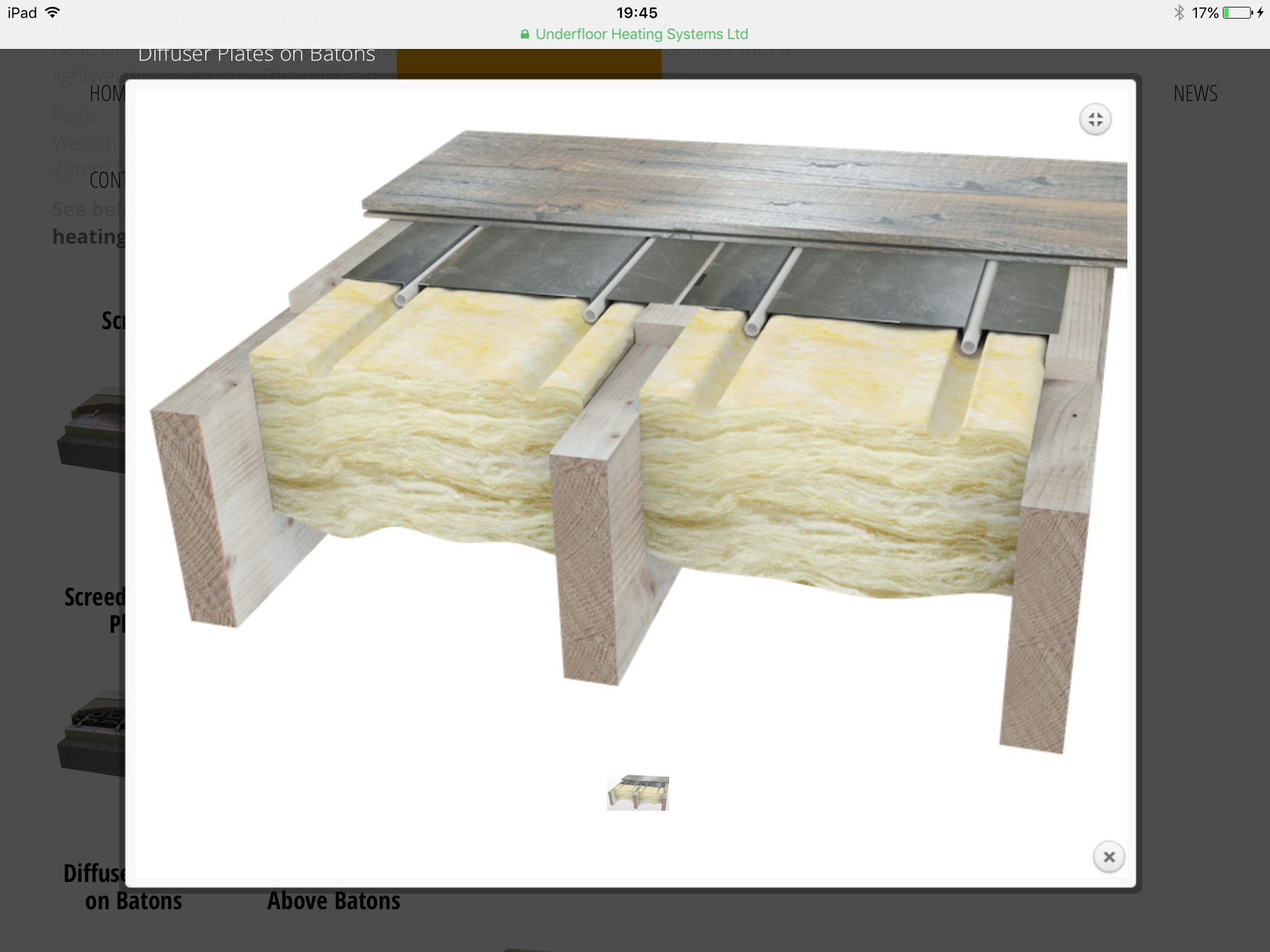

Nick, are you describing the "Diffuser plates on batons" solution as displayed here https://www.underfloorheatingsystems.co.uk/underfloor-heating-design/floor-construction/#! ? Just trying to make sure I get the picture right.

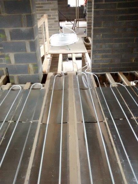

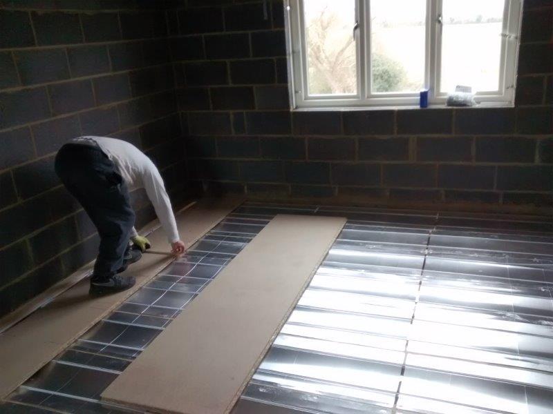

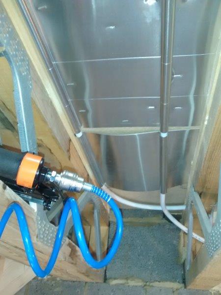

I went for the battening the web joist route and got on very well with it. I used a 22mm x 90mm sawn timber (or thereabouts) pasloded and D4 glued on to my webjoists (about 70mm wide), nailed down the spreader plates with some clout nails, threaded in the pipe and then boarded out with 22mm egger chipboard (glued and screwed).
Things I learnt as I went - have a decent sized sharpie pen and make notes of where pipes cross over the joists to avoid mindless screwing mistakes, don't weave the the pipe even under one joist (see below) - even on a small ensuite circuit that whole length of pipe then needs to be threaded down that same route.
I bought an air stapler (on NickfromWales advice/suggestion) only £20 off Amazon and fixed the spreader plates back to the underside of the flooring (done from below) - having an enthuasiatic 15 year old also helped this job go well
Another real benefit that helped a lot (I didn't learn this until I made my way downstairs to do the ground floor) is to use a bending spring on the pipe to help with forming corners and tight bends:
http://www.ebay.co.uk/itm/UFH-PROFESSIONAL-UNDERFLOOR-HEATING-AL-PEX-PIPE-SPRING-BENDER-/141260384210?var=&hash=item20e3c667d2:m:mH_qsDtK7756rsBIEu_V3Bw
I think I could have lived without a pipe-decoiler, I had 500m coils from Boulder and these were more than it could cope with, just rotating the coil on a clear bit of board seemed to go just as well.
This was one of the more rewarding things I did on the build - good luck!

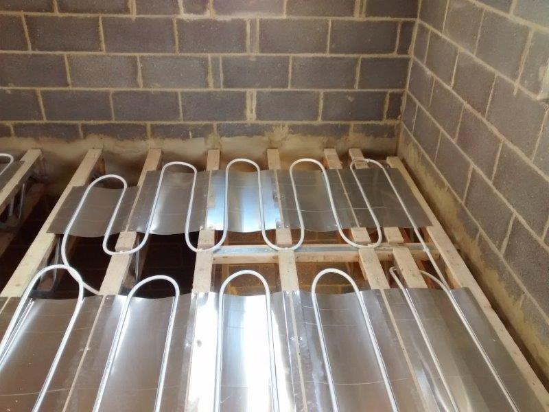

This method ;)
That allows you to cross the posi joists without cutting into them. Just remove the batten accordingly.
  • Like 1
Thank you, I got that.
Why is it better than this one? https://www.underfloorheatingsystems.co.uk/wp-content/uploads/2016/04/Diffuser-Plates-above-Floor-with-batons.png ? Looks simpler to implement but clearly there is a catch?
Well, I guess it would not work well (not enough support) for the tiles.
That method is for wooden floor as your finished floor. ;).  The only thing I'd add to that scenario is fitting some fluffy ( Rockwool ) under the plates to make them slightly proud of the finished height. That way, when you fix the wooden floor down you'll be forcing the plates against the fluffy and ensuring good surface contact between the plates and the wooden floor.
If you look at Frogeyes pics above you'll see how the plates naturally want to sag so that needs addressing with either method, eg fluffy or staples.
  • Like 2
