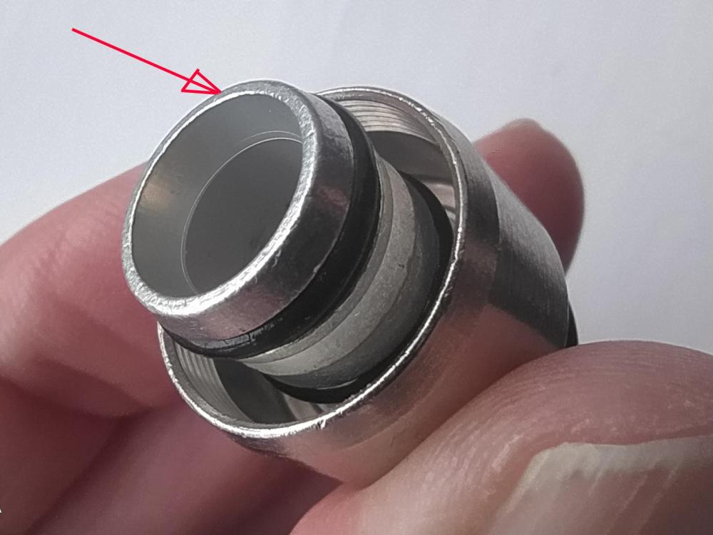

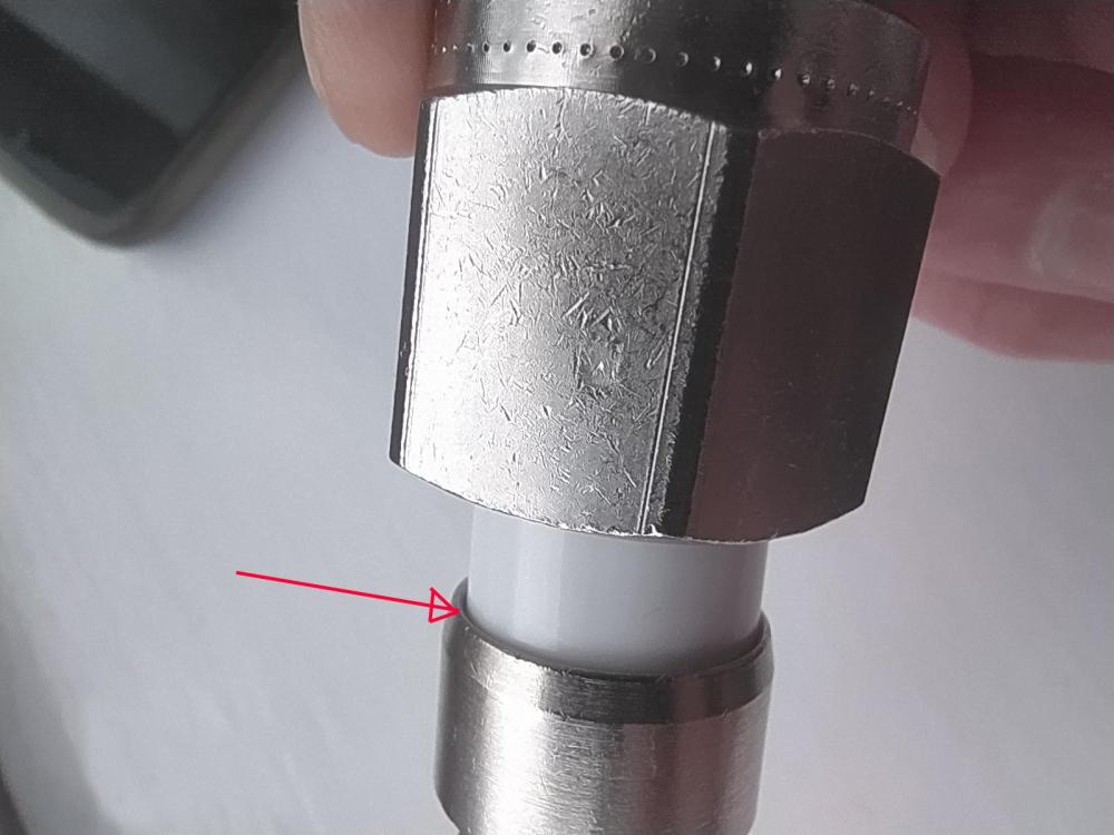

ruggers Posted December 7, 2020 Share Posted December 7, 2020 (edited) On 02/12/2019 at 14:03, MikeGrahamT21 said: +1 for MLCP Pipe. I got 16mm pipe, manifold with 16mm eurocones, and eurocones for all of the radiator ends, and ran full lengths from manifold direct to rads. No joints at all, so no ability to leak in horrible hard to reach spaces! Using plastic pipe can be a bad idea for radiators, as the integral oxygen barrier of things like JG tend to only work up to 50C, which most heating systems will run above. MLCP has an aluminium liner, so doesn't suffer from this, so overall things should last a lot longer, and as a bonus, if you have any mice knocking about, they shouldn't get through aluminium. This is what I'd like to do but never used Eurocones so not understanding them fully. Are eurocones always required to connect any size MLCP pipe to a manifold, even if both are the same size? ie: 16mm pipe into a 16mm manifold, or just when the two are different sizes? Most UFH manifolds I've seen are for 16mm pipe except polyplumb which takes 15mm pipe. Standard radiator lock shields take a 15mm pipe and if i want to insert 16mm pipe direct from the manifold to the radiator in one run, I want to know the best way to do so to make it fit the 15 lock shield valve? how did you do this? Edited December 7, 2020 by ruggers Link to comment Share on other sites More sharing options...
Russell griffiths Posted December 7, 2020 Share Posted December 7, 2020 (edited) A euro cone is basically the same as a nut and an olive just the same as any compression fitting if the manifold has been made to have a Euro cone fitting then that’s all that will fit it as the inside is machined to except a Euro cone. Dont panick they are dead easy to use and 100% bomb proof what you will need is the little tool to shape the end of the pipe nicely so the Euro cone insert seats nicely into the pipe. Do a bit of you tube searching, 100% you must use the correct pipe cutter, do not be attempting to carve the pipe around with a hacksaw. If you haven’t bought all your bits yet you can get very nice rad valves that take a Euro cone. Edited December 7, 2020 by Russell griffiths 1 Link to comment Share on other sites More sharing options...

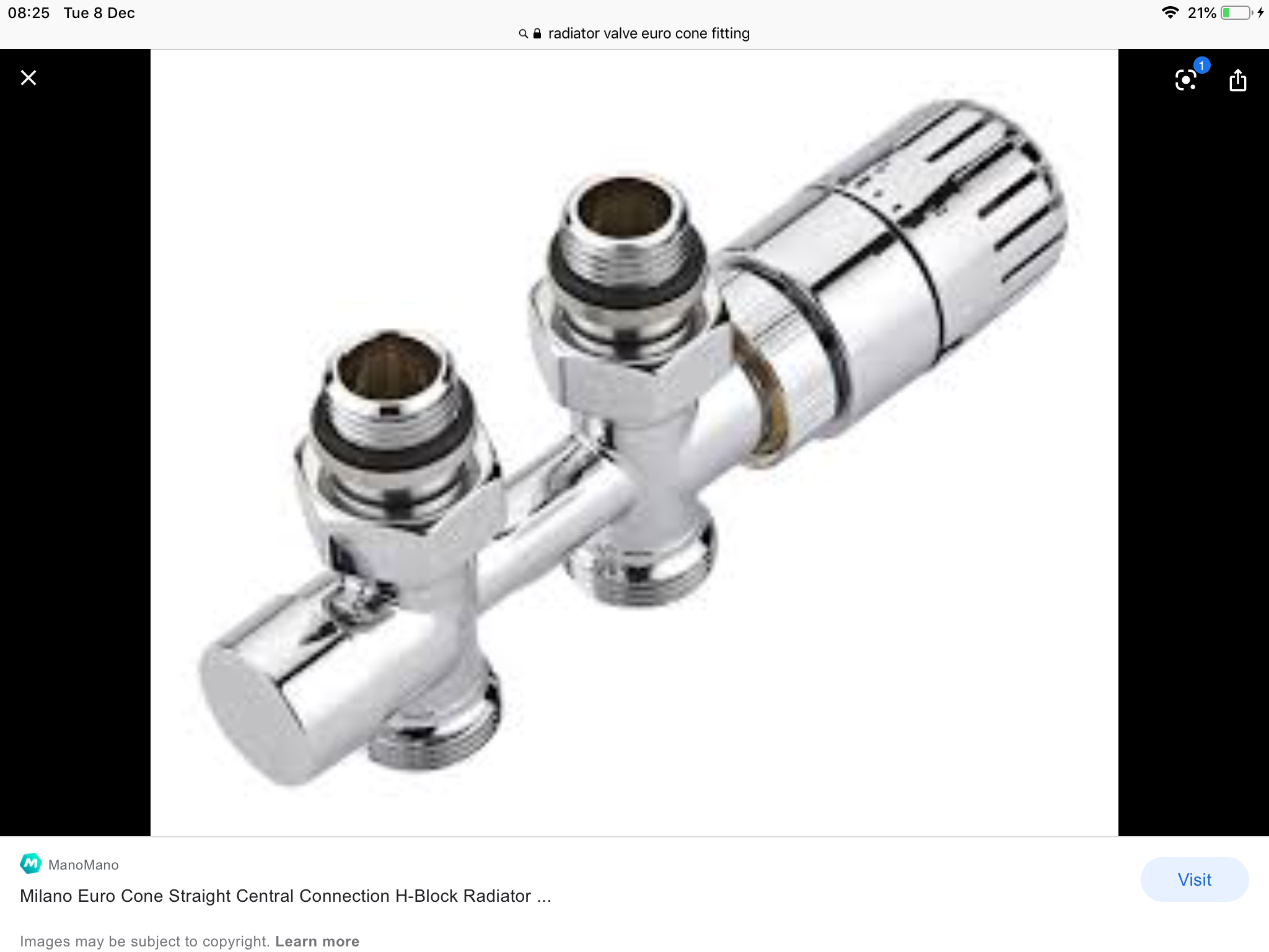

Russell griffiths Posted December 8, 2020 Share Posted December 8, 2020 (edited) Look at some of the foreign stuff, we are still living in the 60s, some of the nice rads have both valves on one end of the rad so you get this very neat two port valve, plumbed from underneath so no pipe tails on show at all. It is also easier to get the spacing right as you just know that pipes ate 50-60-70mm apart rather than knowing size of the rad. Edited December 8, 2020 by Russell griffiths 1 Link to comment Share on other sites More sharing options...

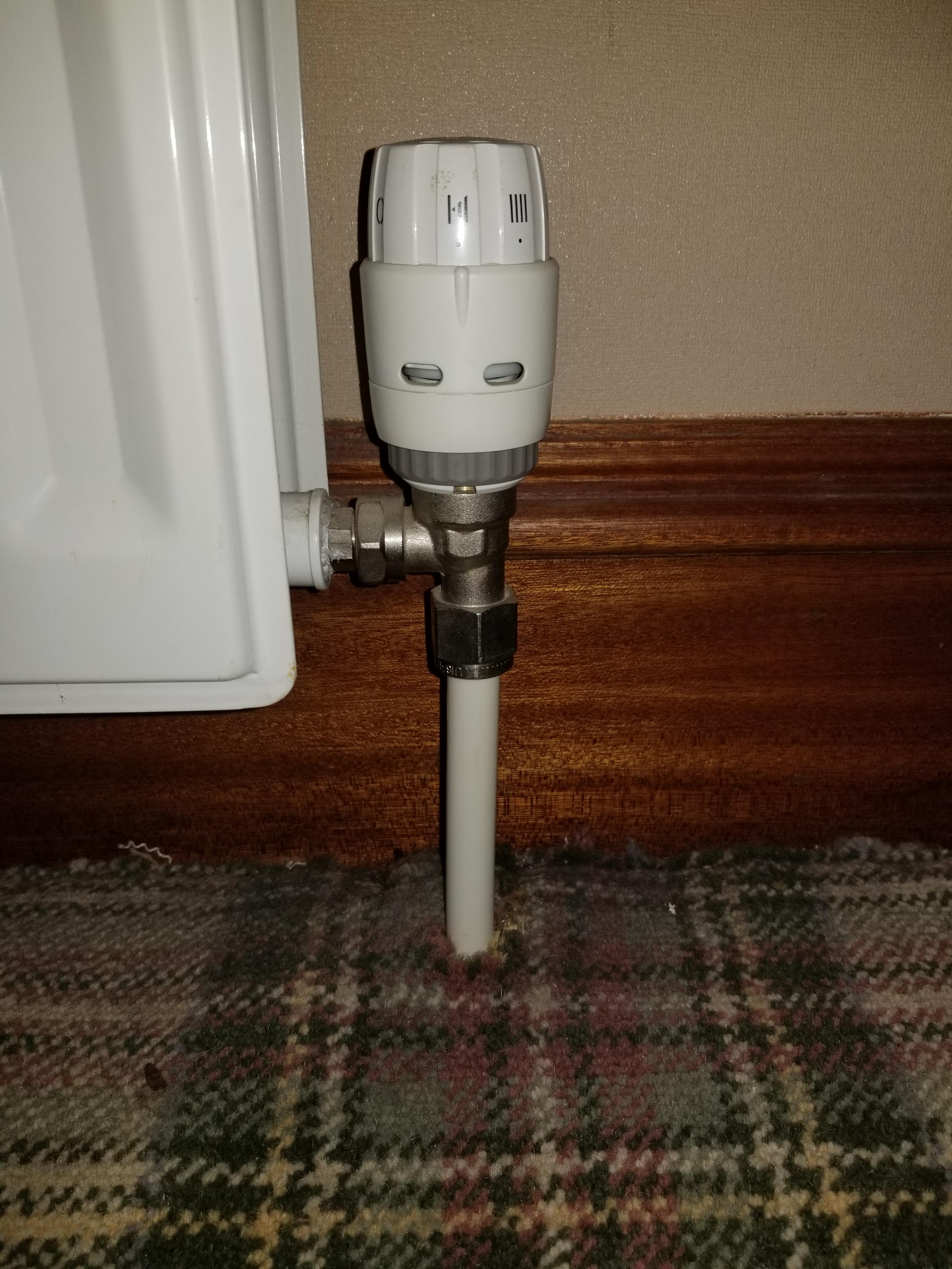

Dave Jones Posted December 8, 2020 Share Posted December 8, 2020 On 28/11/2019 at 18:59, Alexphd1 said: Just out of curiosity are we talking a full UFH type of manifold or just a old school micro bore type manifold? We are using a ufh type manifold on our upstairs rads so we can control flow temp from thermal store and no TRV's just room stats via phone app. I dont like painted copper pipes as it's very rarely painted nice (always paint over the valve nuts etc). I do like plain copper or chrome pipe especially to towel rails etc. I would not have push fit fittings on show either as the pretty bulky. Most of our jobs we took the white mlcp (uponor) plastic pipe rite to the radiator valve and used a chrome nut. Never had any customers complain. Ps carpet had yet to be fitted at that job. never out the floor looks terrible. Elbow out of the wall behind. Link to comment Share on other sites More sharing options...

Alexphd1 Posted December 8, 2020 Share Posted December 8, 2020 @Dave Jones 99% of retro fit around this area is out the floor. When you mention cutting holes in nicely decorated plaster its usually a no. I am not to fussed either way as long as they are not run superficially and boxed in. Link to comment Share on other sites More sharing options...
Dave Jones Posted December 8, 2020 Share Posted December 8, 2020 2 hours ago, Alexphd1 said: @Dave Jones 99% of retro fit around this area is out the floor. When you mention cutting holes in nicely decorated plaster its usually a no. I am not to fussed either way as long as they are not run superficially and boxed in. its behind the skirting, looks much more professional. Link to comment Share on other sites More sharing options...
Alexphd1 Posted December 8, 2020 Share Posted December 8, 2020 (edited) Do you have any pictures? Any behind the skirting system I have seen usually consists of micro bore and looks like a dogs dinner but that was a while ago maybe things have changed. Edited December 8, 2020 by Alexphd1 Link to comment Share on other sites More sharing options...
