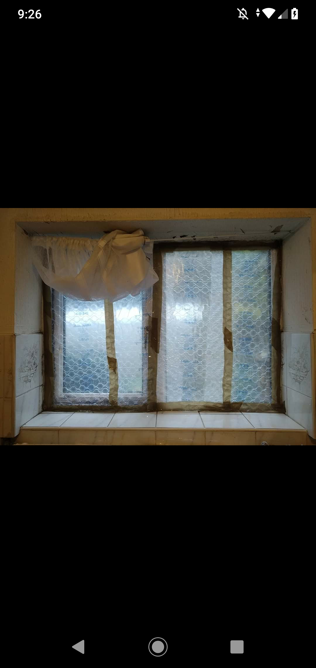

canalsiderenovation Posted January 7, 2020 Author Posted January 7, 2020 We got planning permission approved and our architects have had correspondence re the exemption. Finally, we can proceed now with a view to getting a builder booked..... If we are still in a house with no heating or hot water by the end of the year kill me... Oh and did I mention bubble wrap on the windows is my latest attempt to keep us warm... 1
