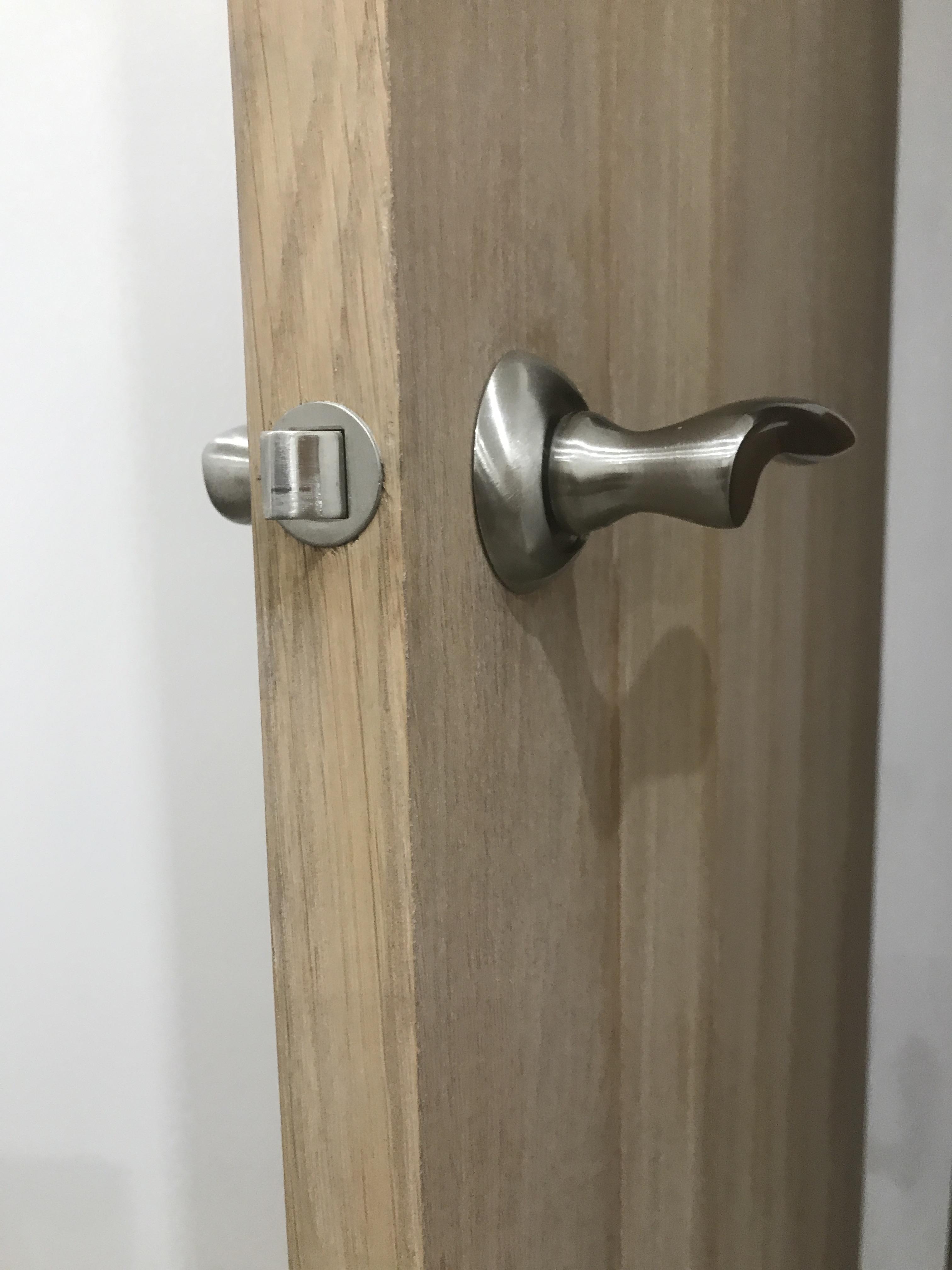

@Boris, don't know if you've chosen your furniture yet but these magnetic catches are magic imo. I just fitted them to a couple of cheap doors for now (oak later). As this little video shows. No chance of catching your hip or clothes as you pass:

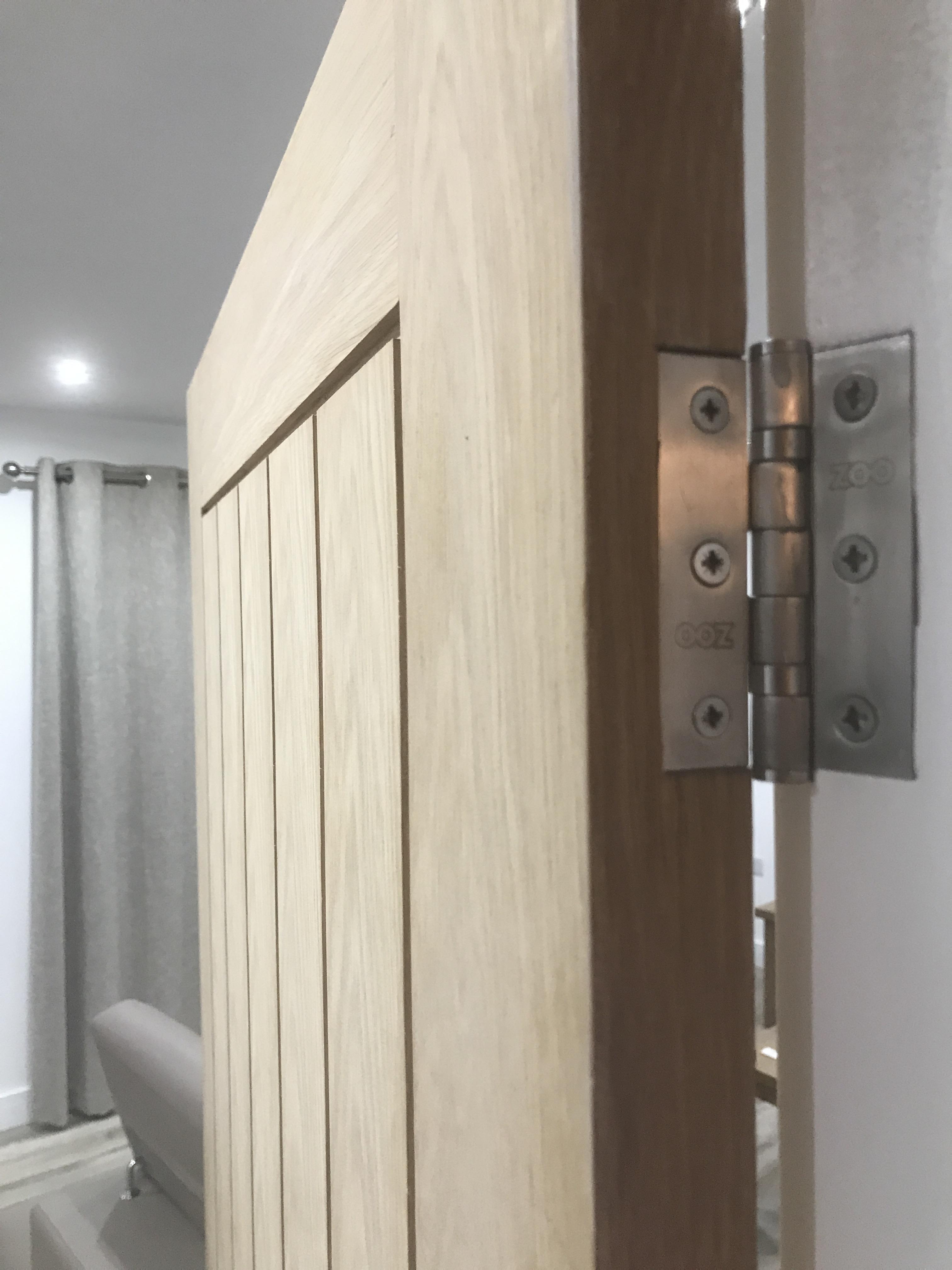

No he does that for free @AnonymousBosch but the gap at top of hinge to hang coat off is extra!
