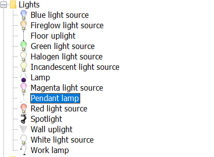

Ferdinand Posted December 5, 2019 Posted December 5, 2019 (edited) Sweet Home 3d (free) has some lighting design features, and is good at displaying internal layouts, but it may not be sophisticated (or complicated ) enough for @puntloos. I have 3 zoned dimmers in my kitchen, but have not used the dimmer bit since I switched wholesale to Ikea LED bulbs 5 years ago. Ferdinand Edited December 5, 2019 by Ferdinand
