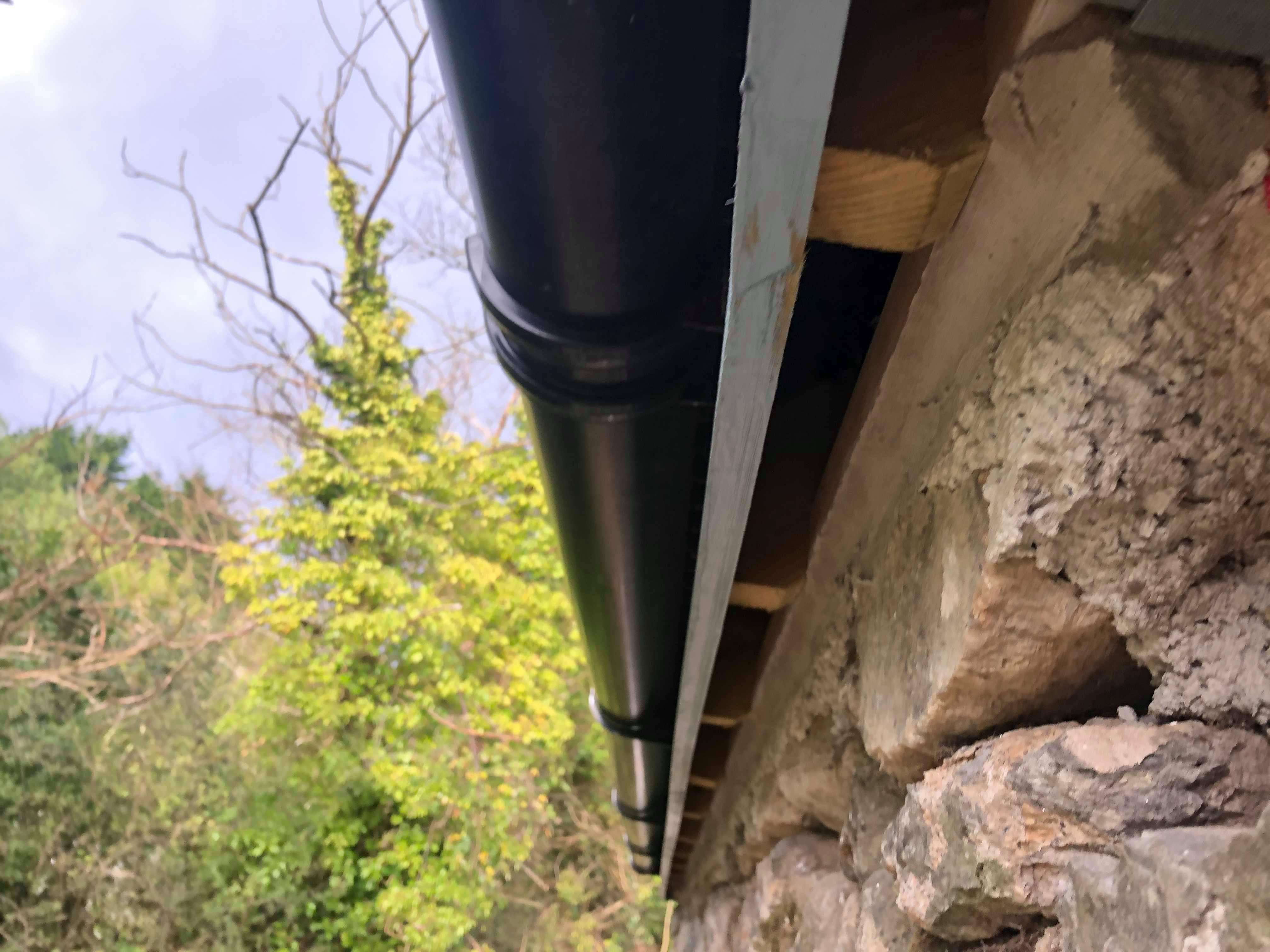

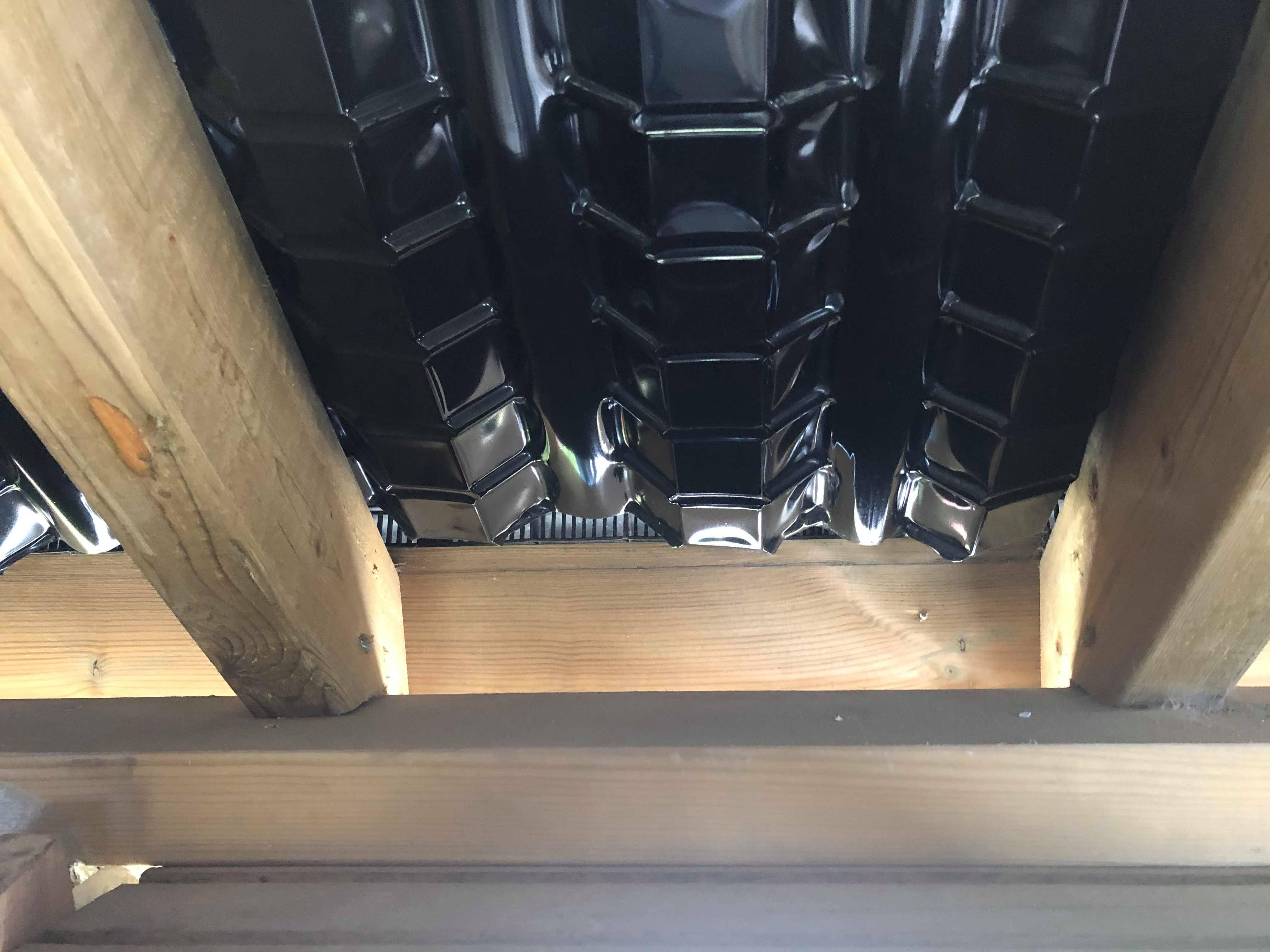

Roz Posted November 19, 2019 Share Posted November 19, 2019 (edited) Alright.... so we're about to insulate the roof. I thought I was going to put insect mesh over the gaps in the eaves until I realised the roofers had put ventilation thingys above, so I can block the eaves right? Question is, should I do it from below or above? Would it be weird to do it from below? I'm tempted by the small chunks of wood and sealing around them rather than having to make a soffit fit to the barn wall? It varies in width along the length of the eaves. Edited November 19, 2019 by Roz Link to comment Share on other sites More sharing options...
Roz Posted November 19, 2019 Author Share Posted November 19, 2019 1 minute ago, Sensus said: How much, what type, and where are you putting your insulation? If it's fibreglass insulation, and a cold roof (insulation at ceiling level) then we're experiencing serious problems with loft condensation, these days. The precise mechanism is variable, and in some instances additional ventilation actually makes things worse, but equally it sometimes helps. Since it's easier to replace insect mesh vents with solid blocks/strips than the other way around, I'd be inclined to stick to your plan to use the former, and see how you get on. If you do decide to block the soffits, personally I'd do it with strips of Medite Exterior or similar, fixed to the underside of the rafter feet, rather than individual blocks of wood inserted between the rafters. We're using 90mm celotex and about 30mm ventilation gap. We've got breather membrane under the tiles but the building control officer recommended at least 25mm gap anyway. It's a warm roof, underneath this we'll have insulated plasterboard too. Does that change anything? Link to comment Share on other sites More sharing options...
Roz Posted November 19, 2019 Author Share Posted November 19, 2019 1 hour ago, Sensus said: Yes, very much so. In that case, ignore what I said: there'd be no benefit to the additional ventilation, if it's a warm roof. I assume you've got an insulated plasterboard ceiling as well as the 90mm. Celotex between the rafters? 90mm. Celotex isn't a lot, on its own, these days. I'd still be inclined to block the soffits using strips rather than individual chunks of wood between the rafters, though - I think you'd find it easier. Yes 90mm celotex between the rafters and insulated plasterboard ceiling OK great I will look up the Medite you mentioned! Link to comment Share on other sites More sharing options...

Roz Posted November 20, 2019 Author Share Posted November 20, 2019 ?soooo , eaves / soffits. @AnonymousBosch I saw your thread and was going to post my question in there but didn't want to hijack... I don't know the right etiquette! So yes, warm roof. Basically it has a vent strip under the tiles, so I can block the eaves right? There will be a 30mm gap up to the ridge. Cutting a soffit well seems like a job I don't want to do, so cutting chunks of board or wood to fit the eaves gaps internally seems easier and I can glue and screw then seal around them. I dont mind the look of the eaves from underneath as they are now, and a soffit maybe isnt that fitting for a barn anyway. Can anyone else agree/disagree to make me feel better about making this decision? Thanks @Sensus for already doing so, I'm not going to try and understand whats going on so will just try to stick on topic, which I admit now seems off topic, but there we go. I cant seem to get Medite down here, so maybe marine ply would replace? p.s. I should put insect mesh over the vent strip? with... gaffa tape???? Lol. Asking so many questions in one post is probably a bad idea but I have a bad habit of rambling. Link to comment Share on other sites More sharing options...
