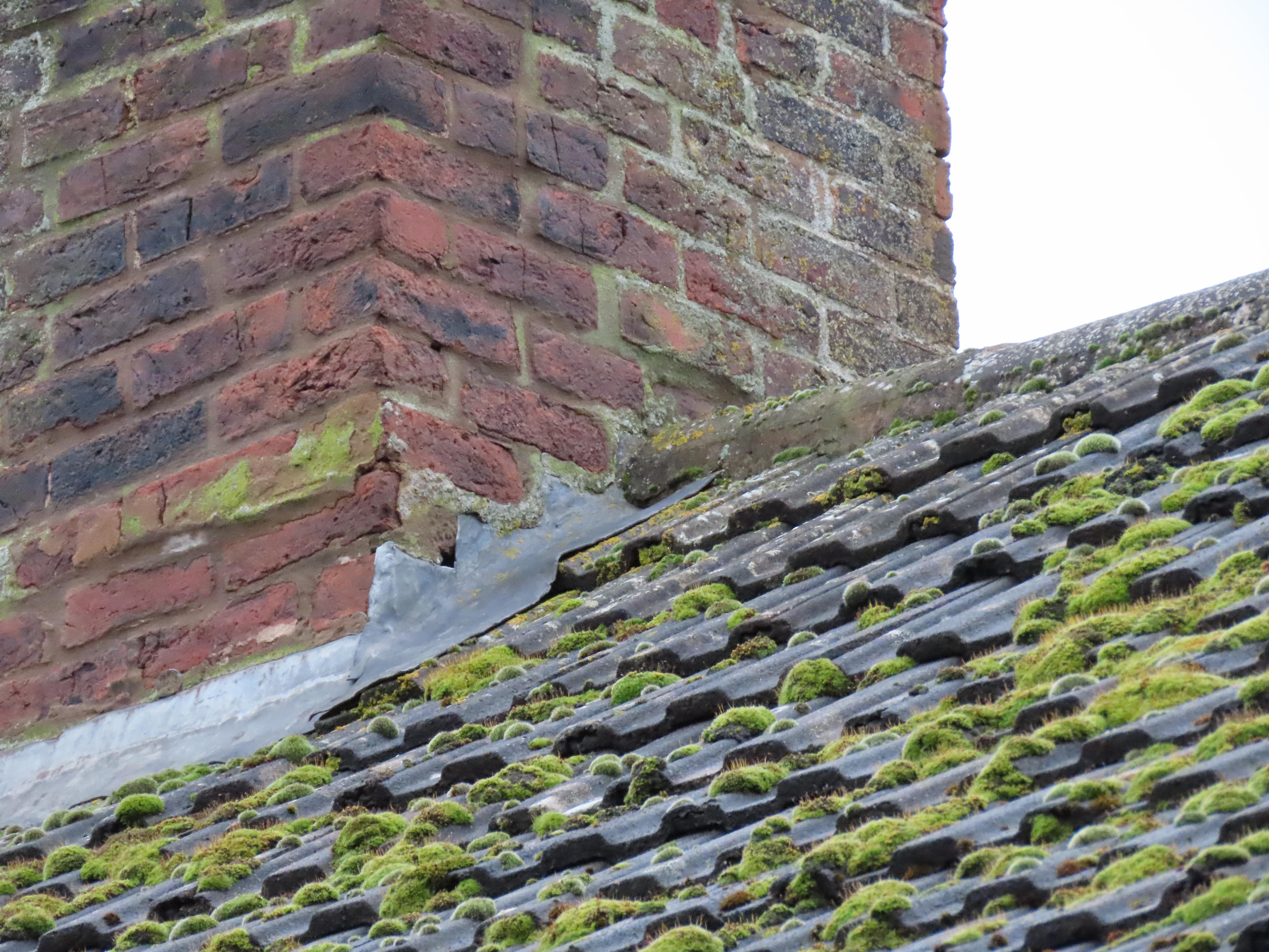

H F Posted November 15, 2019 Posted November 15, 2019 I've got to say I'm getting tired of our DIY dramas at the moment. After the storms yesterday, we had a leak on our ceiling and we think it has come the chimney - took some photos of the stack and it looks like the lead isn't covering the chimney properly. Any thoughts? PS - I know we have to deal with the moss too.
bassanclan Posted November 15, 2019 Posted November 15, 2019 The lead doesn't look great. There appears to be a hole at tge back of the first step, but it would be worth getting into the attic to have a look
Big Jimbo Posted November 15, 2019 Posted November 15, 2019 No soakers ?, and i would have tucked that lead uner the ridge tile at the top. It looks poor i'm afraid.

H F Posted November 15, 2019 Author Posted November 15, 2019 2 hours ago, bassanclan said: The lead doesn't look great. There appears to be a hole at tge back of the first step, but it would be worth getting into the attic to have a look We don't have attic access under the chimney - so we would have to scale the roof. I agree, having taken a close up photo the work looks awful.
H F Posted November 15, 2019 Author Posted November 15, 2019 2 hours ago, Big Jimbo said: No soakers ?, and i would have tucked that lead uner the ridge tile at the top. It looks poor i'm afraid. Looks like we're going to need a pro to come in and look at it - first few we've called said call us back at the end of January. Crazy. Wait till Jan and the water pouring in. What are soakers?
Big Jimbo Posted November 15, 2019 Posted November 15, 2019 1 minute ago, Home Farm said: Looks like we're going to need a pro to come in and look at it - first few we've called said call us back at the end of January. Crazy. Wait till Jan and the water pouring in. What are soakers? Soakers are basically L shaped bits of tin or ally. You can make yhem out of lead. At the moment any water going under you lead, has reached the tiles. It will run down the tiles, and pass onto the tiles further down the roof, and eventually into the gutter. However if any of the water that has passed you lead onto your tiles goes sideways, due to a slight slope in that direction, or being pushed sideways by the wind, it will run off the side of your tiles up against the chimney and into your house. It there were soakers under the tiles, they would act as a last defence, and carry any water down to tiles below your chimney.
Big Jimbo Posted November 15, 2019 Posted November 15, 2019 The morter in you chimney looks soaking wet. I've had it before where the bricks, and morter were taking in so much water, that regardless of the lead, etc, the chimney was soaking up the water, it was dropping downwards through the brickwork, and the heat in the room below was drawing it out, and staining the wall. To be honest, i gave it 3 good coats of Thompsons waterseal, and it was fine up to the point when i sold the place.
joe90 Posted November 15, 2019 Posted November 15, 2019 Chimneys should be built with a full lead tray but very few are (mine is, old time builder who knew his trade). I agree that the bricks look very porous and waterproofer may help but that lead looks suspect IMO.
Temp Posted November 15, 2019 Posted November 15, 2019 (edited) My money is on a lack of lead soakers. It looks like any rain blown under the existing lead can go sideways then down the side of the chimney if there is no soaker under there. If the lead had been a few inches wider you might have gotten away without them because of the profile of the tile. In fact the other side (left hand) on the chimney might not be leaking because on that side the lead might be lapped down the tile profile. Soakers go under the tiles and deflect any water going sideways out onto the tile below. They are fitted before the tiles and the stepped flashing that you can see. Skips to about 2 mins in.. Edited November 15, 2019 by Temp

PeterW Posted November 15, 2019 Posted November 15, 2019 Could be a hidden gutter under the last row of tiles - can’t tell until the tiles are off and the lead is checked.

Oz07 Posted November 15, 2019 Posted November 15, 2019 Seen full lead tray on some dummy chimneys on a job last year. Couldn't work out why they didn't use dpc myself. These still leaked through brickwork last winter anyway. Builder sealed with water seal and fixed problem
