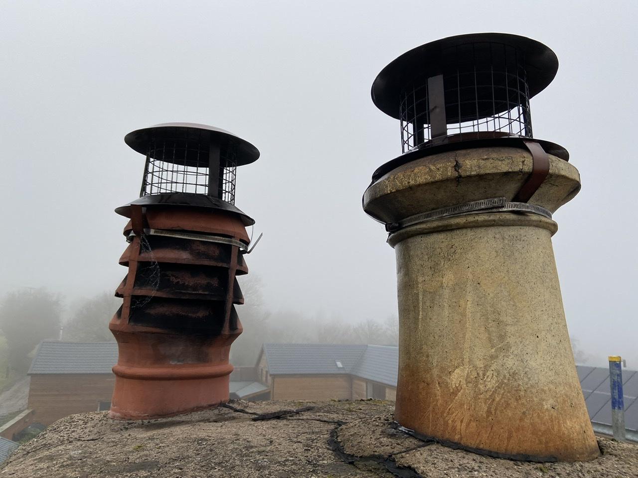

We’re struggling to find chimney pots as replacements for our chimney rebuild. We’ve searched online and we’re not finding what we’re looking for. It’s a red brick farm house, so we’re thinking of pots that are terra-cotta - the ceramic pots clash a bit. Any online store that you can recommend would be helpful.
Never envisaged buying a chimney pot in the uk would be this tricky.
Link to comment
Share on other sites
how big are they ..? You’ll need to know the full height which could be another 10-12” on what is visible.
All the big merchants will carry standard pots, they start at about £35-40 each.
If you want something more ornate then a chat with WT Knowles wouldn’t go amiss ..
Other option is a reclaim yard or eBay - loads on there like this
  • Thanks 1

We've in the process of appointing a specialist builder to rebuild our chimney - it's the only way forward after having had a good look at it.
On that note, we're waiting for the final quotation from the builder - what kind of guarantee should we request from them? What is standard in the Uk for such matters? And should I be requesting anything else in writing that I have not yet thought of?
Thanks in advance.
