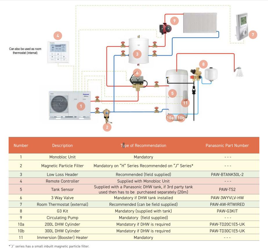

Re-starting this thread as contemplating going down the DIY install route for my ASHP. The current plans are to go with a Panasonic TCAP with a 50lt buffer tank as per their recommendation (sounds straight forward!). I understand that the G3 kit would need to be signed off annually by a suitably qualified plumber, and I'd need to do my research with regards to regulations around routing and what not, but were there any significant pitfalls in regards to the actual ASHP setup and commissioning. I've gone through the installation manual and can see the numerous options for setting up the control system, but other than that it does appear quite simple? My feed/return from the ASHP will be a short 2m 'above ground' route, which simply runs through an external wall which already has a duct in anticipation, and under the staircase where I'm hoping to site the UVC / buffer tank. I have thought about their DUO pre-plumbed tank which offers a 300l +70l buffer tank in one package, but not sure if this will fit under in the allocated area, and whether this will work out any more cost affect or quicker in the long run.
The supplier of the ASHP is trying to steer me down getting an installer to do it, which I can understand seeing as he'd have greater piece of mind w.r.t. the warranty Has anyone had any good / bad experiences in going down the DIY route please?

I have just had my Panasonic 9kw ( not Tcap) fitted before xmas. I had a plumber friend to help with the pipework and I did the rest with help from people on this forum. It was a bit nerve wracking at first as although I have done most things in my build the thought of damaging my ASHP was always at the front of my mind. What i will say is if you follow the pipe layout as per the drawing it is very easy to do. Connect up the wiring as per the diagram, turn it on (everything crossed) and hope it works which in my case it did.

How are you finding the Panasonic? The 9kW version is the same one we are most likely going with. I don't suppose you'd have any pictures of the install by any chance? I intend on following the schematic below...All that data at your finger tips must be tantalising! How was it been performing so far?
Really pleased with the Panasonic but then ASHP are new to me so have nothing to compare it with.
It is performing as well as can be expected and our elec usage is pretty low. Yesterday we used 10kw for heat and HW for a 330m2 house. I cannot get over how the slab holds the heat for hours and hours. I know this was meant to happen but when you walk round in bare feet many hours after there has been no heat input and it is still warm is great.
The controller took some getting used to but now I have got to grips with it.
There are no schematic drawings in your post?
I will post some pics later of the install.

Apologies! Schematic below (hopefully)
