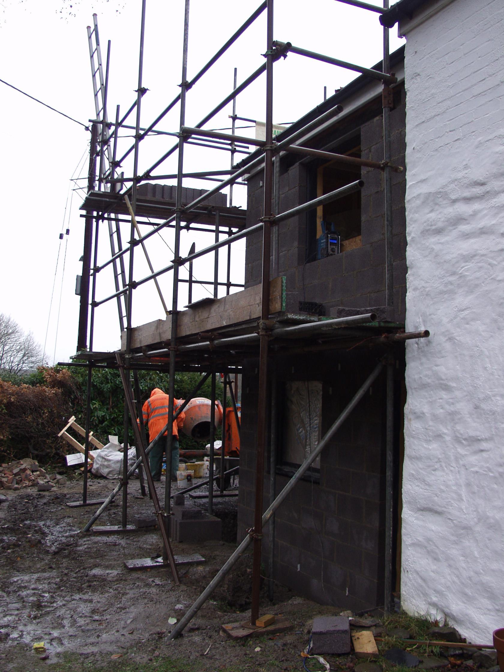

zoothorn Posted November 17, 2019 Author Share Posted November 17, 2019 I have two other things on my mind, if anyone can help. The first: The lintels for the knock-through (2x in a stepped config) are concrete. But all others, above the two windows, above the door, above the french doors.. are a thin galv steel strip with engineering bricks on forming the lintel > then block above. This seems ok for the upstairs window because only one block course above: but the others I see a bow in the galv strip + bricks, quite evidently (to me) the weight above causing it (the lower window the most pronounced/ the most block weight above seems to confirm this). I Q'd this with no2 builder (brickie) as it was being done who just muttered away agreeing, but blaming the bad steel (IE couldn't be bothered to answer/ not his concern).. then when I Q'd my main builder about it he dismissed my concern 'what? oh its fine' & walked off. I got the impression he knew what I was Q'ing, as he quickly took off instead of maybe explaining why it was ok. Is this type of lintel ok? before I get the sniping replies, I realise its a Q for my BCO ideally but opinions would be useful.. if I can dismiss it as a concern I don't need to get back to my builder about it. Thanks- zoot. Link to comment Share on other sites More sharing options...
Danny68 Posted November 17, 2019 Share Posted November 17, 2019 We need photos of lintel in situ to see your concerns , very unlikely your builder would put the wrong spec Lintel/ damaged in place when he knows a bco would flag it up. Link to comment Share on other sites More sharing options...
Gone West Posted November 17, 2019 Share Posted November 17, 2019 3 hours ago, zoothorn said: The lintels for the knock-through (2x in a stepped config) are concrete. But all others, above the two windows, above the door, above the french doors.. are a thin galv steel strip with engineering bricks on forming the lintel > then block above. What roughly is the thickness of the steel. The only flat steel lintel in my old bungalow was around 1/4" thick and the opening only about 2' wide. Link to comment Share on other sites More sharing options...
zoothorn Posted November 17, 2019 Author Share Posted November 17, 2019 (edited) 2 hours ago, Danny68 said: We need photos of lintel in situ to see your concerns , very unlikely your builder would put the wrong spec Lintel/ damaged in place when he knows a bco would flag it up. Quite- that's what i thought too.. gives me some reassurance/ but the bow just doesn't (nor a new concrete lintel sitting nearby laughing at me: this could've been halved & used: my only conclusion is obviously builder saving ££s). Sorry my camera has finally failed/ cannot take even 1 pic now. But I think you might know the galv 'tray' type of lintel 'shell'.. maybe? so its filled with a line of dark grey bricks = a concrete lintel cheap substitute (my view on it). The bow is ~ 3/4" down in the mid-point, on the lower window here: that's alot to me: so how will the window fit in without the bow seen (or fit in at all if the tolerance is maybe 1cm!?). Sorry the pic is the best I can do. Edited November 17, 2019 by zoothorn Link to comment Share on other sites More sharing options...
zoothorn Posted November 17, 2019 Author Share Posted November 17, 2019 (edited) 2 hours ago, PeterStarck said: What roughly is the thickness of the steel. The only flat steel lintel in my old bungalow was around 1/4" thick and the opening only about 2' wide. Good question. All of 2-3mm Peter. [2.5mm]. The whole thing is not only bowing down 3/4" but twisting forward in the middle too, & door one nearby: both have alot of block weight above. It just seems very wrong to me, a clear builder shortcut. Edited November 17, 2019 by zoothorn Link to comment Share on other sites More sharing options...

PeterW Posted November 17, 2019 Share Posted November 17, 2019 7 minutes ago, zoothorn said: Russel- there is no way on god's earth this thin bit of steel is more expensive than a concrete lintel. No way. I'm happy to be proved wrong, but no way. A 1/4" thick one.. perhaps. That thin bit of steel is a timber frame lintel - probably a Catnic. It will be twice the price of a concrete lintel - it’s a specialist piece of kit. 1 Link to comment Share on other sites More sharing options...
Declan52 Posted November 18, 2019 Share Posted November 18, 2019 It just wasn't propped with a bit of timber when the blocks went on top. It has sagged a bit , no big deal it happens. You could take the lintel out now and the blocks won't go anywhere so there is no chance of it falling down due to not being structurally sound. So take a breath and let your builder work away. Link to comment Share on other sites More sharing options...
