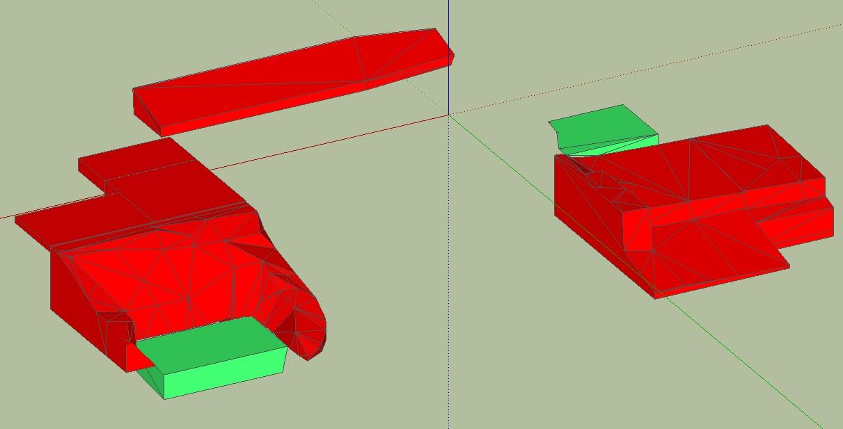

I am looking at the cut and fill of my site, in terms of m3 soil.
I am looking at scaling up the in ground m3 by a factor of 2 to account for the increase in volume, and a soil weight of 1,800kg/m3.
Can anyone shed any light on how muck away is calculated, by a loads m3 or weight per lorry?

I disagree, as groundworks and foundations are the biggest question mark about our potential build, as its a sloping site and i want to be as forearmed as possible.

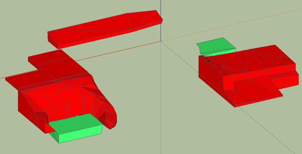

I have a 3D model of the site terrain, and now i know the final design and levels i can cut chunks out of the 3D terrain which has been a quick and easy way to work out the cut and fill m3.
I'm adding on 20% contingency to my calculated volume which should give a robust figure.

This is where i am at the moment, i have the topo survey which i created a 3D sketchup model of, and now i have a final planning house design, i have been able to work out the cut and fill volumes as below (may need refinement once the structural engineer has designed it). This is about 320 m3 in total, which for cost estimates i have added a contingency of 20% for the development currently has a out the ground m3 with contingency of 380m3.
I haven't had a bore hole on site yet, and am in the process of arranging (waiting on specs / locations from a structural engineer), but know that its likely to be sandy from a historic bore hole 200m away. Assuming a sandy soil weight of 1800 kg/m3, and a 20T truck (well 19T load), that's 36 loads with the muck away at just under £10k (TBC).
I need to get a soil/borehole survey arranged with screening for waste characterisation, asbestos, and WAC.
This will go on to the SE who then can design the foundation/retaining walls, and then i can get that to the GW contractor to price the job.
However in the mean time, i want to start getting a feel for what the GW cost is going to be.
