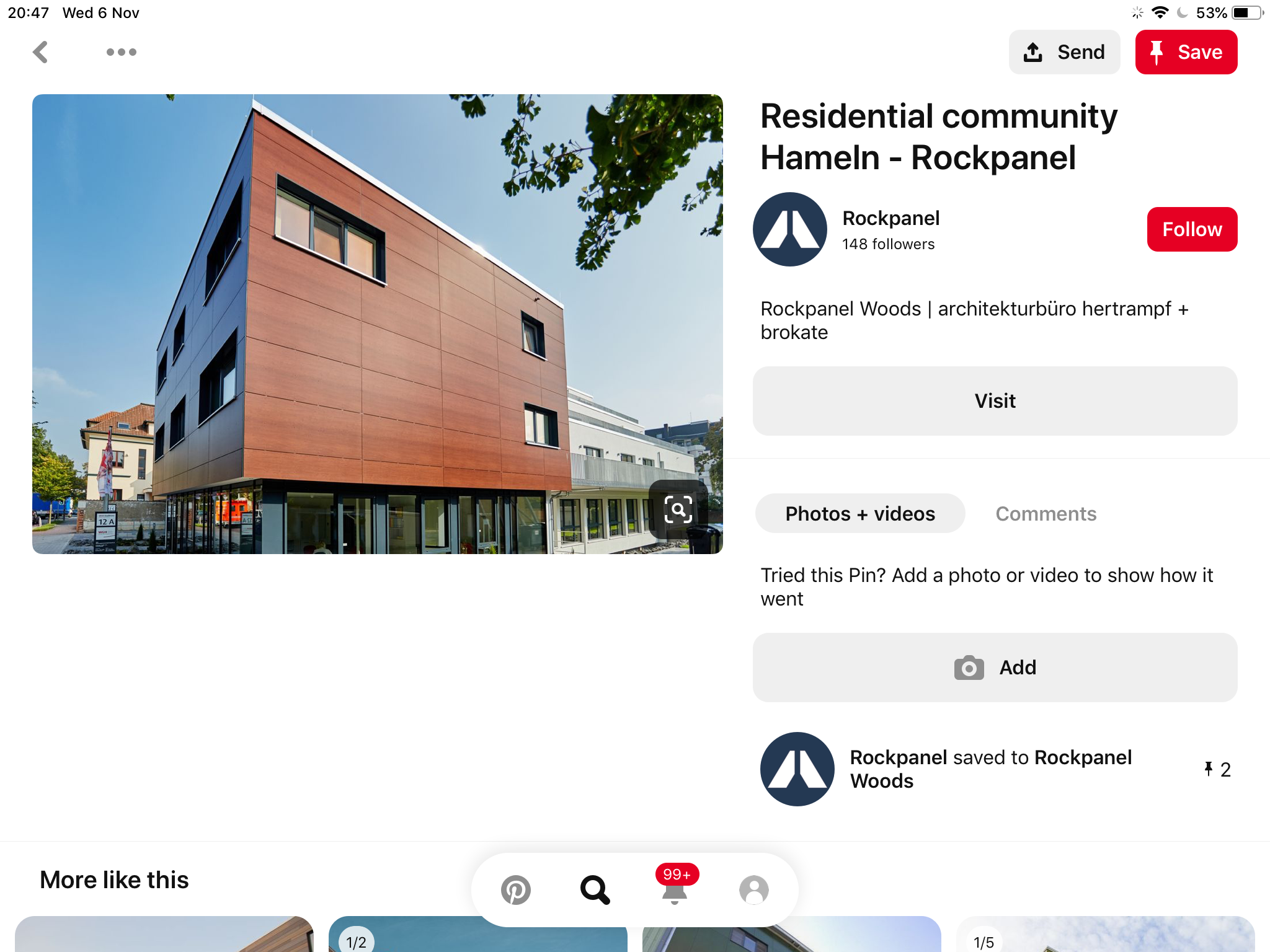

Russell griffiths Posted November 6, 2019 Share Posted November 6, 2019 Have you looked at a product called rockpanel we are looking at it for a couple of elements of our place. Link to comment Share on other sites More sharing options...
Carrerahill Posted November 6, 2019 Share Posted November 6, 2019 3 hours ago, DarrenA said: Yes, that has crossed my mind. If the drips drop down I think the run off can be managed to avoid the bricks. But if they are blown around in the rain and streak sideways then yes it's going to be an issue. My fallback plan is to hose the bricks down but am not sure if that will remove the stains. It's a very good point. No, it will not, you will have rusty staining on everything it touches. Once the layer or protective rust has set up it certainly stops, but by that time it is too late for the materials it has stained. Google New York Corten Steel road staining - I remember it was used on a job years ago, and there were a lot of concerns about the staining, and someone produced a photo of a whole road in New York that was rusty coloured from a new building. It was there for years! Nice in the right situation, but needs managed. 1 Link to comment Share on other sites More sharing options...
Conor Posted November 6, 2019 Share Posted November 6, 2019 58 minutes ago, Russell griffiths said: Have you looked at a product called rockpanel we are looking at it for a couple of elements of our place. That's exactly what I thought of. I got some samples and one of them basically looks like rusted steel. I'd guess much easier to work with and install than the steel. I've had the samples outside for over a year now, and they look perfect. Great material, I'll be using if for my soffits and fascia. Would like to use more of it, but can't as we're in a conservation area. 1 Link to comment Share on other sites More sharing options...

DarrenA Posted November 8, 2019 Author Share Posted November 8, 2019 On 06/11/2019 at 20:49, Russell griffiths said: Have you looked at a product called rockpanel Do you have any idea of the price and whether they sell direct rather than through installers. I've gone through my samples pile and found some and it might work. Link to comment Share on other sites More sharing options...

Russell griffiths Posted November 8, 2019 Share Posted November 8, 2019 24 minutes ago, DarrenA said: Do you have any idea of the price and whether they sell direct rather than through installers. I've gone through my samples pile and found some and it might work. Nope, just got a sample. Link to comment Share on other sites More sharing options...
