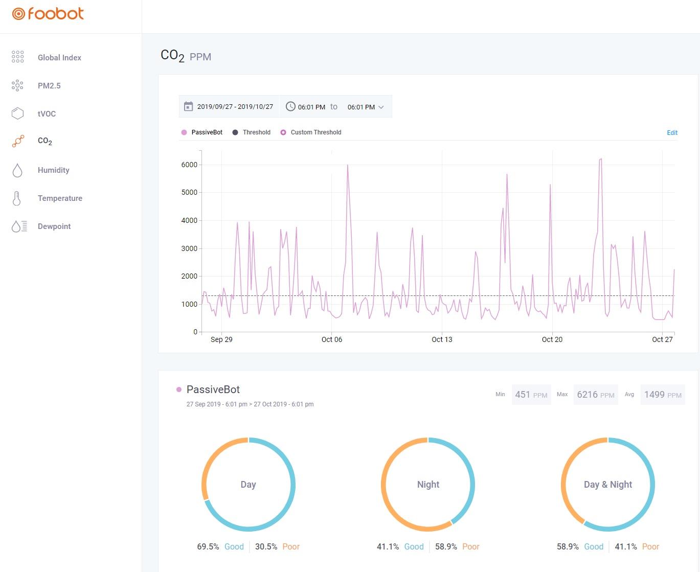

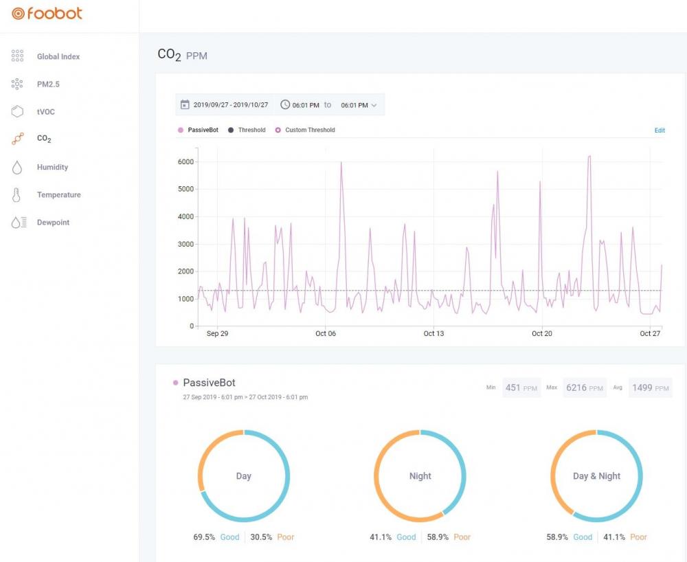

mike2016 Posted October 27, 2019 Posted October 27, 2019 I got one of a batch of FooBots being used as part of a research project on ebay. I also wanted something off the shelf and not fiddly like the Raspberry Pi. Unfortunately they are no longer sold but are developing a next gen model, no idea of availability. Some second hard units are available on ebay from the Netherlands but a bit pricey @ £160 ea. USB powered. They can log to an app on your phone and the internet which is great for tracking activity. See the available measurements in the screenshot below. That's my bedroom CO2 I've focused on. It's certainly possible, depending on your budget.... 1
