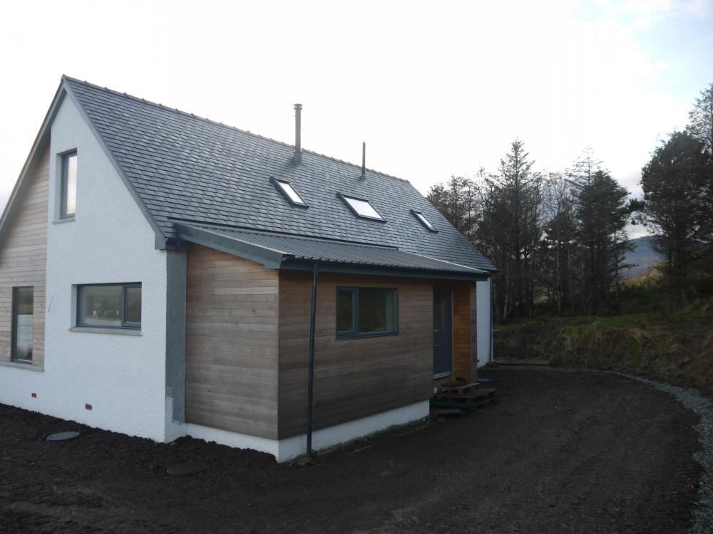

Pocster Posted October 16, 2019 Share Posted October 16, 2019 Every house i’ve Lived in had one of these ; not particularly pretty . On large building sites I don’t see any . I assume it’s a requirement so how do they do a ‘hidden’ stench pipe ??? Link to comment Share on other sites More sharing options...
NSS Posted October 16, 2019 Share Posted October 16, 2019 10 minutes ago, pocster said: Every house i’ve Lived in had one of these ; not particularly pretty . On large building sites I don’t see any . I assume it’s a requirement so how do they do a ‘hidden’ stench pipe ??? Our stink pipes run up into the roof space and then exhausts via a tile vent. Seems to be standard practice these days. 1 Link to comment Share on other sites More sharing options...
Pocster Posted October 16, 2019 Author Share Posted October 16, 2019 1 minute ago, NSS said: Our stink pipes run up into the roof space and then exhausts via a tile vent. Seems to be standard practice these days. Ah right ! That’s why I don’t see great dirty pipes everywhere. So does the vent have to be as ‘high’ as possible up the roof ? . I guess i’m Asking what’s the min height from presumably the ‘nearest’ toilet ??? Link to comment Share on other sites More sharing options...
Carrerahill Posted October 16, 2019 Share Posted October 16, 2019 16 minutes ago, pocster said: Every house i’ve Lived in had one of these ; not particularly pretty . On large building sites I don’t see any . I assume it’s a requirement so how do they do a ‘hidden’ stench pipe ??? They are all internal now - usually a boxed in pipe runs through the kitchen. They have a vent at roof level. 1 Link to comment Share on other sites More sharing options...
Pocster Posted October 16, 2019 Author Share Posted October 16, 2019 Do they have to run vertical? Can they twist and turn to get to the roof vent ? Link to comment Share on other sites More sharing options...
Carrerahill Posted October 16, 2019 Share Posted October 16, 2019 1 minute ago, pocster said: Ah right ! That’s why I don’t see great dirty pipes everywhere. So does the vent have to be as ‘high’ as possible up the roof ? . I guess i’m Asking what’s the min height from presumably the ‘nearest’ toilet ??? The spec is x mm away from an opening, window or vent. Link to comment Share on other sites More sharing options...
NSS Posted October 16, 2019 Share Posted October 16, 2019 Just now, pocster said: Do they have to run vertical? Can they twist and turn to get to the roof vent ? Ours run vertically into the roof space and then at a variety of angles. We even have a short section that runs horizontally. 1 Link to comment Share on other sites More sharing options...
Carrerahill Posted October 16, 2019 Share Posted October 16, 2019 Just now, pocster said: Do they have to run vertical? Can they twist and turn to get to the roof vent ? Our new soil stack goes up to roof level of the single storey section of the house, then takes a 90° at the last branch (where a pan connects) then goes about 400mm horizontal (or 92.5°) then through a wall, then 90° and up the side of the house. So I am going to say yes. Link to comment Share on other sites More sharing options...

Nick1c Posted January 15, 2020 Share Posted January 15, 2020 I discussed this with BC this week. Our house is at the top of the foul run, next door has an SVP 20m away. He would accept an AAV in the loft, but would prefer an SVP as belt & braces. He wasn't too fussy about the route but wanted the pipe to be as big as possible (up to 110mm) where possible. The plumber suggested a vented slate which will have to penetrate a 400mm warmcell roof. 1 Link to comment Share on other sites More sharing options...
Pocster Posted January 16, 2020 Author Share Posted January 16, 2020 10 hours ago, Nick1c said: I discussed this with BC this week. Our house is at the top of the foul run, next door has an SVP 20m away. He would accept an AAV in the loft, but would prefer an SVP as belt & braces. He wasn't too fussy about the route but wanted the pipe to be as big as possible (up to 110mm) where possible. The plumber suggested a vented slate which will have to penetrate a 400mm warmcell roof. I assumed I need an AAV and stench pipe ? I.e both - this not correct ?? Link to comment Share on other sites More sharing options...
Mr Punter Posted January 16, 2020 Share Posted January 16, 2020 37 minutes ago, pocster said: I assumed I need an AAV and stench pipe ? I.e both - this not correct ?? If the neighbouring houses are connected to the same drain and they have vent pipes you could just have an AAV. If not, you will need to vent to atmosphere. If you have more than 1 soil pipe you will need either an AAV or vent to atmosphere at the top of each. 1 Link to comment Share on other sites More sharing options...
Pocster Posted January 16, 2020 Author Share Posted January 16, 2020 (edited) 53 minutes ago, Mr Punter said: If the neighbouring houses are connected to the same drain and they have vent pipes you could just have an AAV. If not, you will need to vent to atmosphere. If you have more than 1 soil pipe you will need either an AAV or vent to atmosphere at the top of each. Excellent! The house on the same drain ( which I use to own ) has a stench pipe . Their drain joins into my new build which in turn joins straight into the main drain . Just an AAV then ? Edited January 16, 2020 by pocster 1 Link to comment Share on other sites More sharing options...

Pocster Posted February 16, 2020 Author Share Posted February 16, 2020 (edited) Ok ! umm ‘d and ahh ‘d about this . Stench pipe will be internal - so a 4inch pipe off the main internal drain ok ? Can’t find any regs about where it’s vent should ( or shouldn’t ) go on the roof ! - assume not critical then .... Architect wants stench pipe and AAV Edited February 16, 2020 by pocster Link to comment Share on other sites More sharing options...
Pocster Posted February 16, 2020 Author Share Posted February 16, 2020 (edited) Ah confused myself again ! I’m sure the architect isn’t as clued up ... There’s lots of suggestion that you shouldn’t have an open stench pipe . Indeed you can even get an external AAV that sits on the stench pipe .. I don’t really want to penetrate the roof for a stench vent if it’s not necessary . Can I come off my WC internally ; take a pipe up into the loft and ‘joint’ it towards the loft hatch ; put an AAV ontop ? Makes access for the AAV easy , it’s higher than any cistern - but does it have to be a straight run ? i.e can the pipe work be horizontal for a bit ? Edited February 16, 2020 by pocster Link to comment Share on other sites More sharing options...
