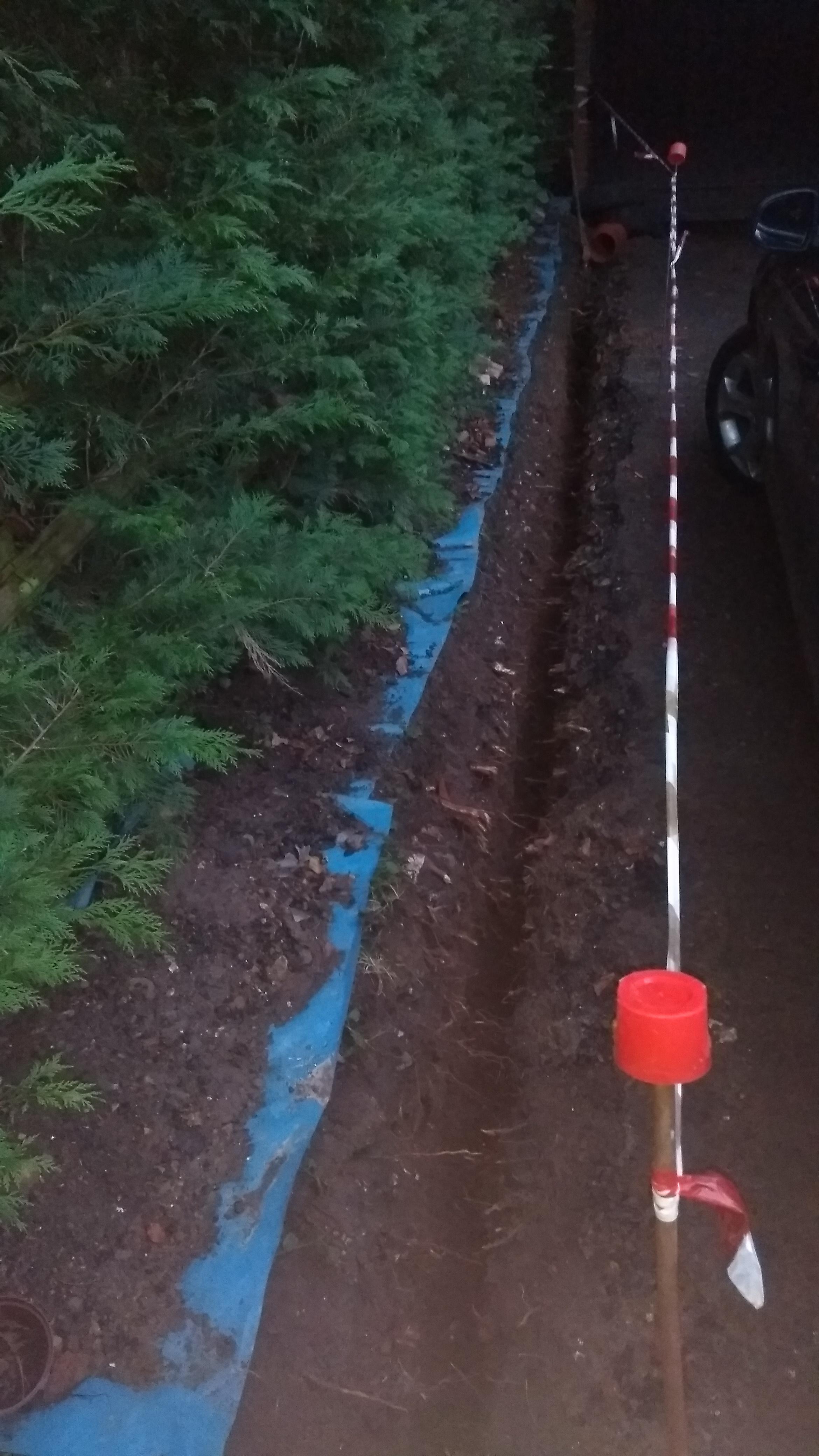

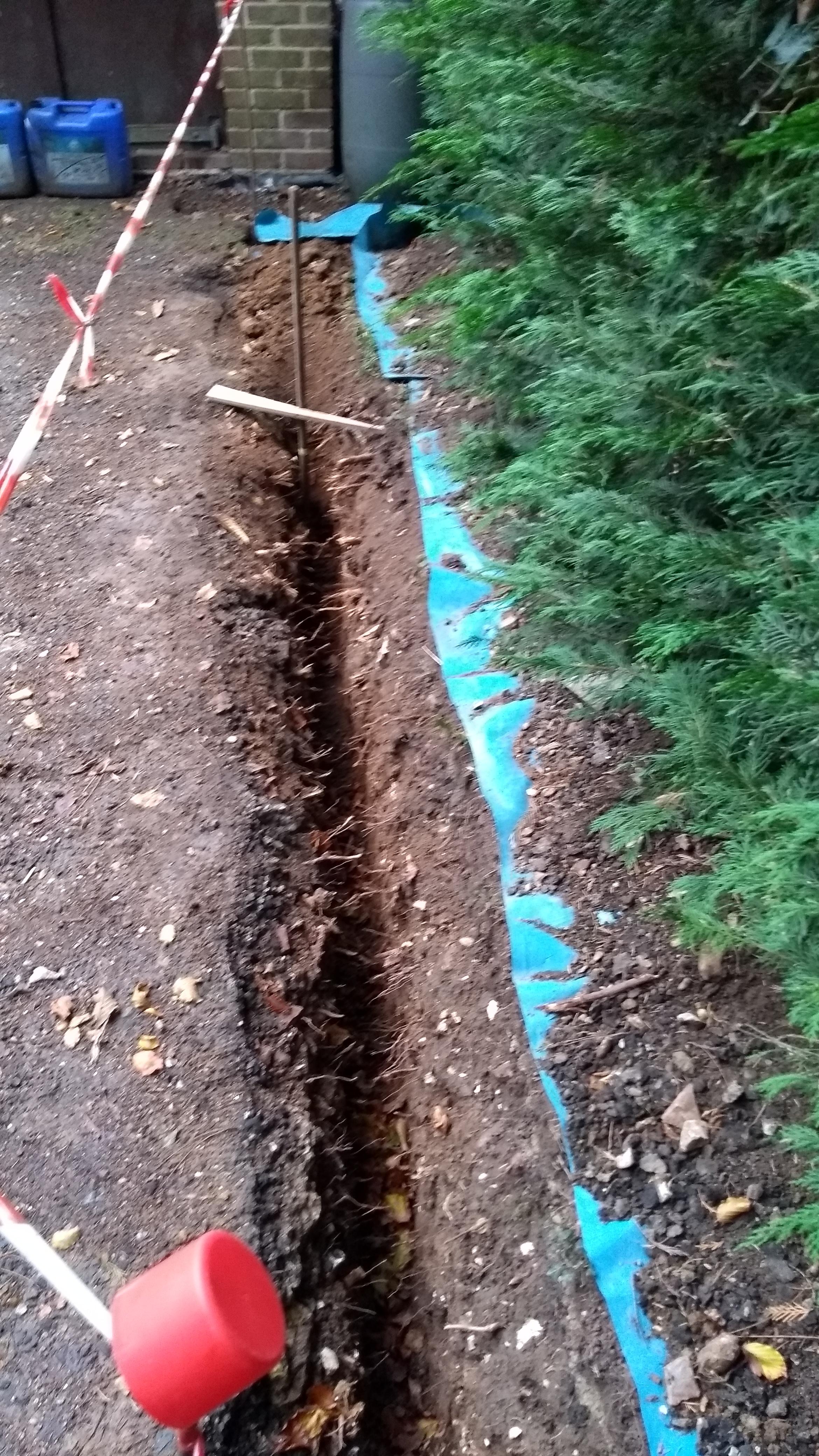

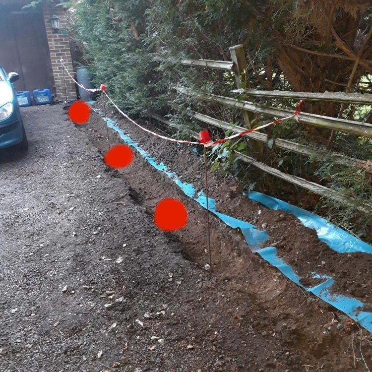

Onoff Posted October 19, 2020 Author Posted October 19, 2020 Still mulling a car port. Funds don't allow at the moment but I'm thinking ahead. I'm currently digging (by hand), a 13m trench from my garage to gate post, 600mm deep and the width of a mattock at the bottom. Into that will go some heavy duty DNO type ducting. The thing is, if I were to do a car port I'm guessing that at 6m x 6m I'd have 6 posts, maybe 8. Wondering if it's worth digging out for then pouring in 6/8 mass concrete "cubes". Later I could simply drill and fix the car port leg feet to these pads. To dig for the bases later I'd risk hitting the duct when digging. One option, but I imagine they wouldn't be big enough, is to dig post holes with the auger bit on a pto. Think the Bil's auger is about 12" dia.
Gone West Posted October 20, 2020 Posted October 20, 2020 If I were doing it I wouldn't have the pads more than 600mm deep so the ducting would be safe and I could do the pads later. Easier than boring holes for the posts.

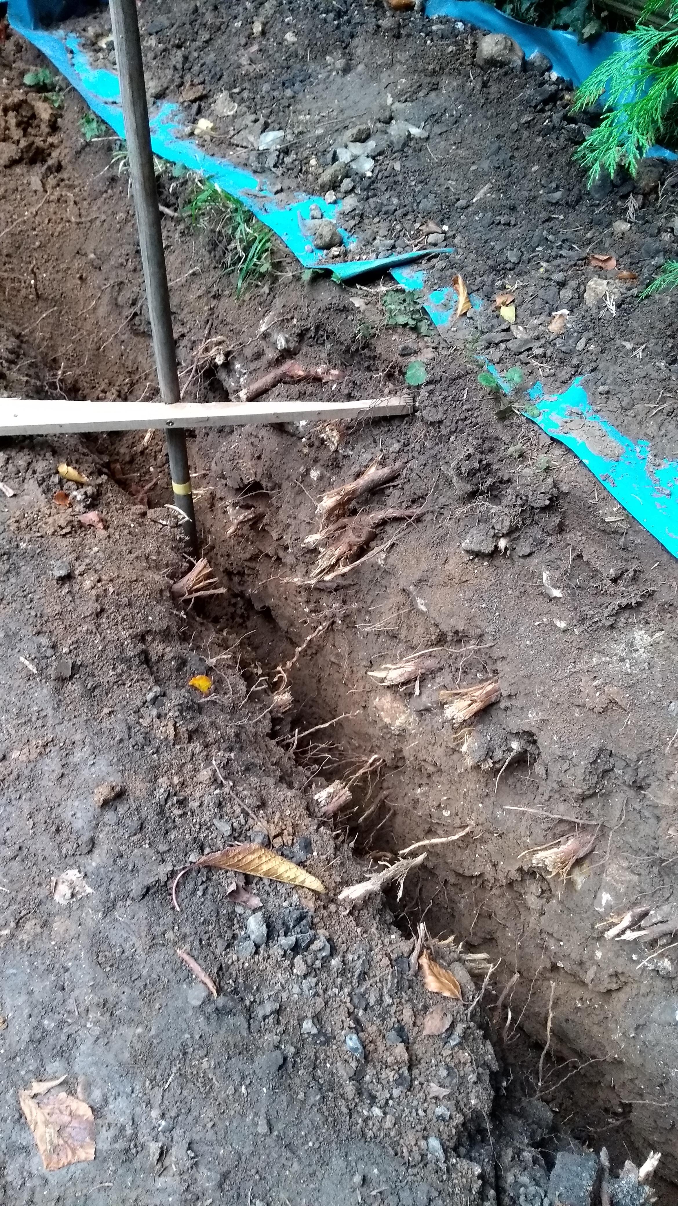

Onoff Posted October 20, 2020 Author Posted October 20, 2020 29 minutes ago, PeterStarck said: If I were doing it I wouldn't have the pads more than 600mm deep so the ducting would be safe and I could do the pads later. Easier than boring holes for the posts. Fair enough. Gut feeling was saying 800 - 1000mm deep. I almost want "cardboard" boxes or tubes I can leave in the ground and fill up with concrete later. Was thinking some shuttered wooden boxes that would rot away. Half rain barrels, oil drums etc. I'm nominally at 600mm at the mo depth wise in the trench. Bloody hard going! Not sure yet where my core drilling from inside the garage comes out depth wise nor how far down the duct is I left at the pillar end. I want to ensure the duct is deep enough so as to allow unimpeded excavations if I later block pave. The root layer from the conifer hedge is a pita. I've a bfo concrete post footing from the original gate post to break out yet, right on the trench line. Then there's the flints. The clay keeps sticking to the mattock blade too so I have to keep a can of spray oil handy. Oh well, back to the digging!

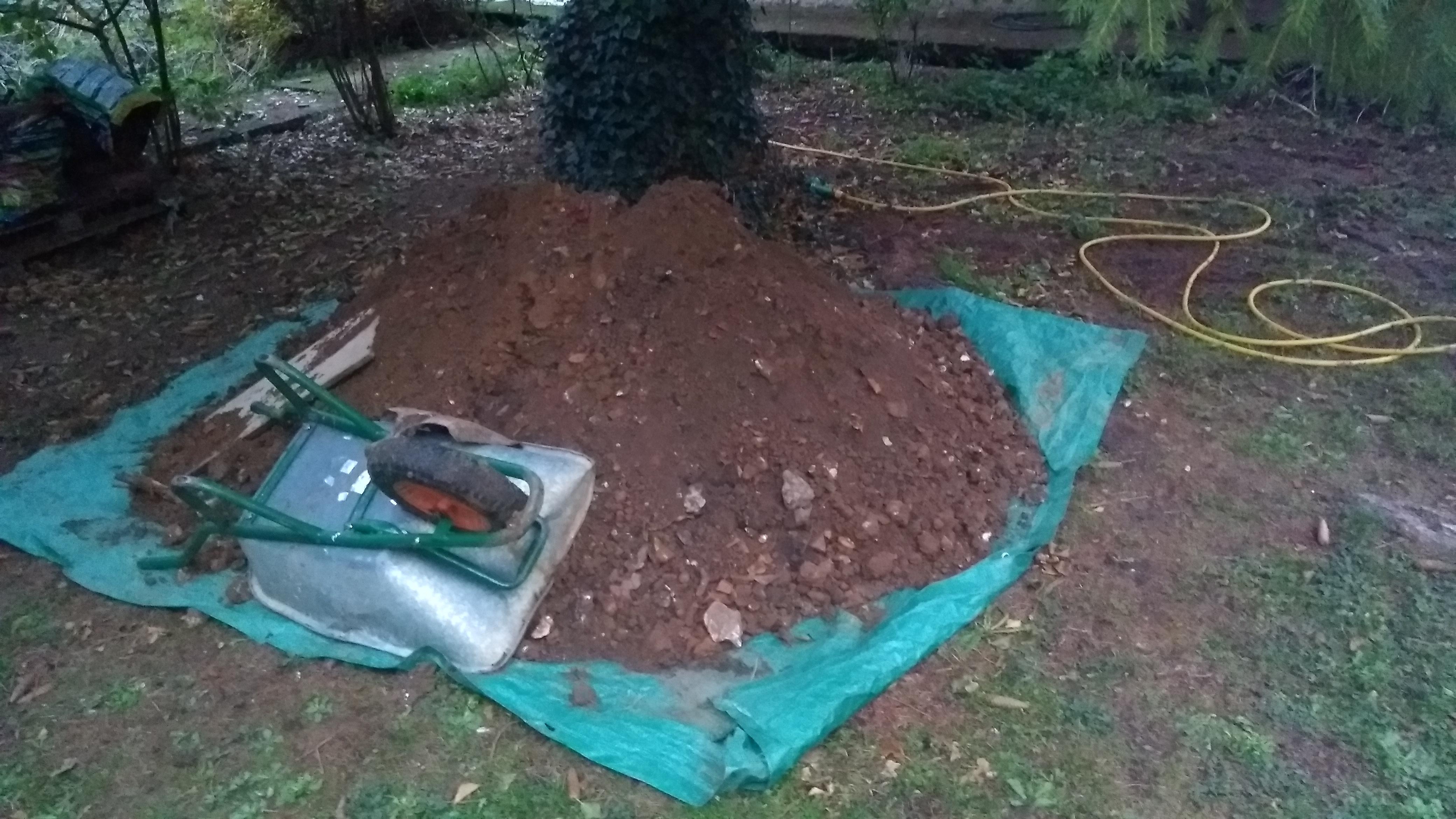

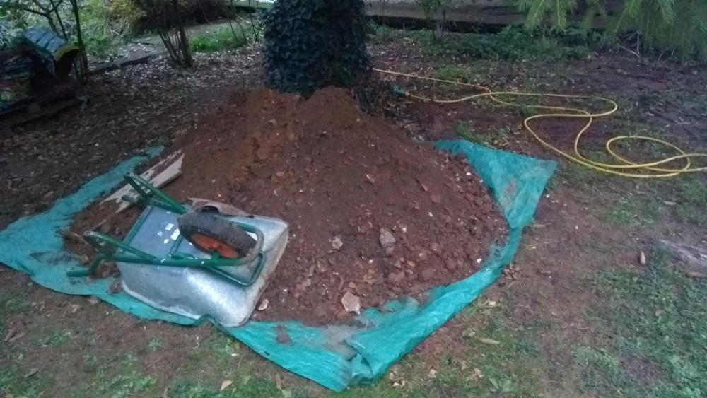

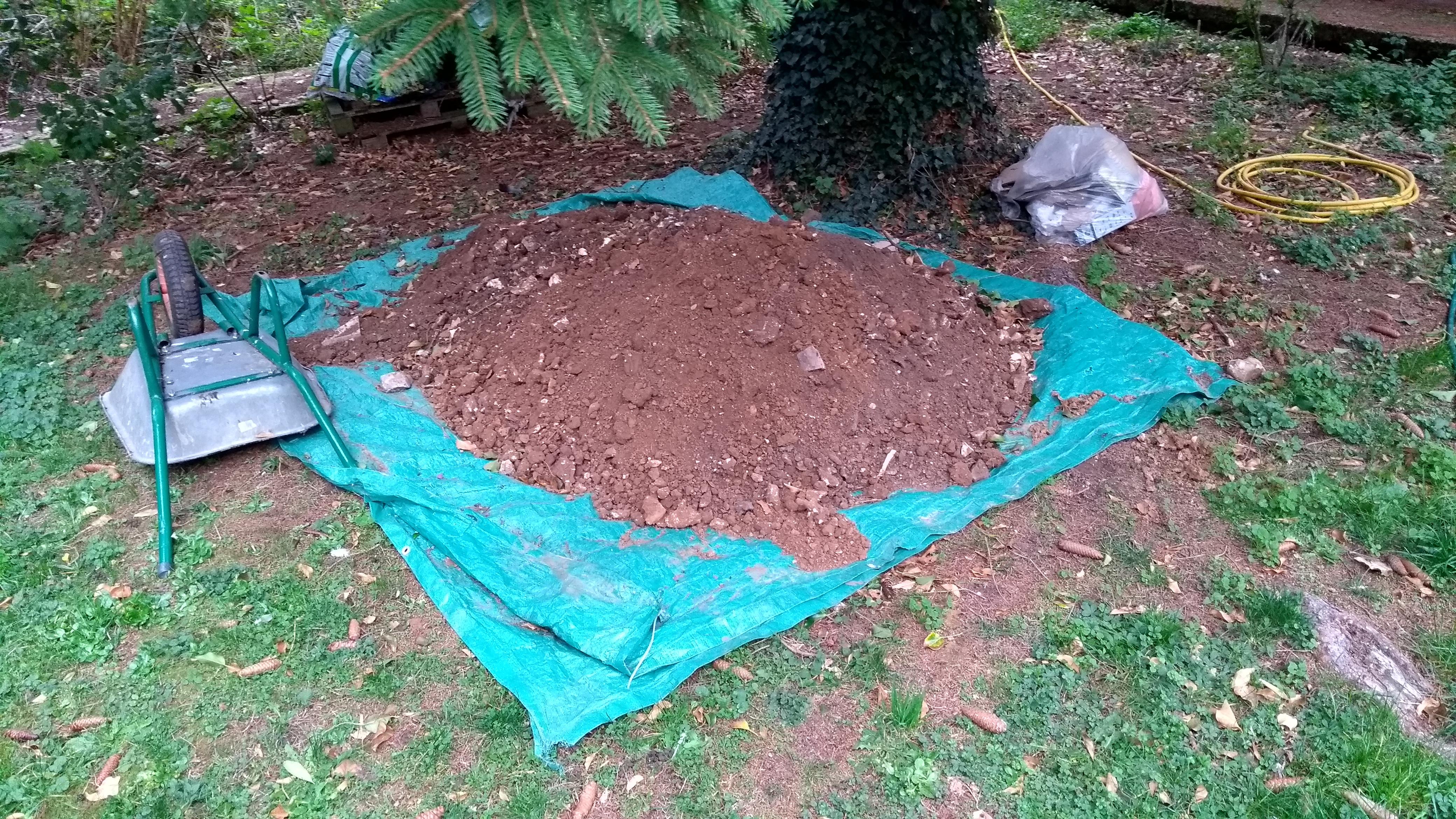

Onoff Posted October 23, 2020 Author Posted October 23, 2020 600mm deep all the way. A question; I excavated the trench a section at a time so I've a large mound of mixed soil, some top soil, some clay etc. Should I bother trying to separate it as it goes back in as in clay in first then top soil. Similarly , other than removing obvious bits of tree root can the big 'ish stones and flints stay in?
Russell griffiths Posted October 23, 2020 Posted October 23, 2020 Good god NO just fill it back in and get on to the next job. 1
