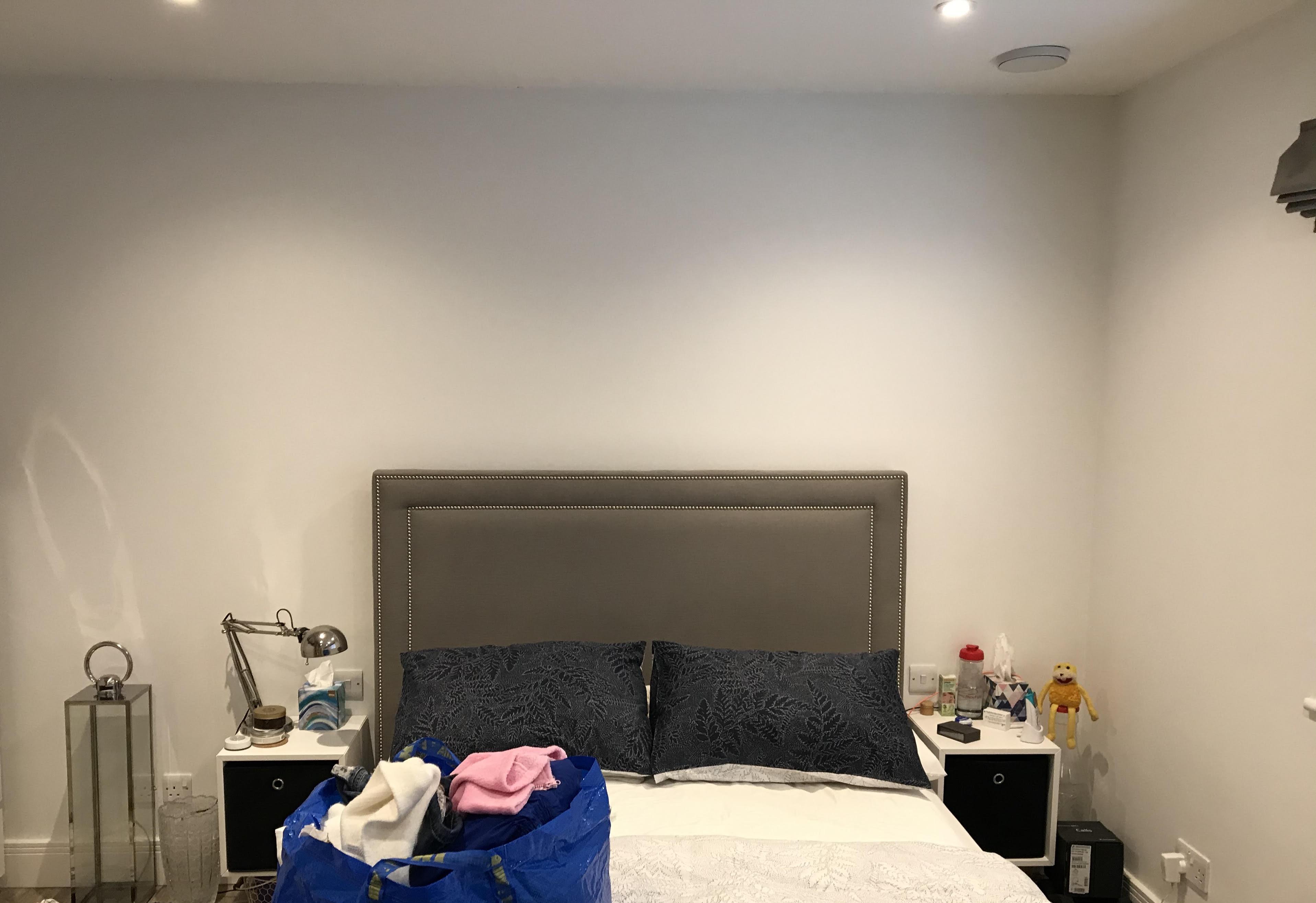

phatboy Posted October 12, 2019 Posted October 12, 2019 Long story short, we still get mould behind the bed with MHRV running. It's held 5" away from the wall with wooden blocks, but with the bedside units air circulation is still limited. And the headboard is tall. And it's the north wall. My current thinking is 1 or 2 12v silent computer fans running all the time, or maybe a on a timerswitch on some programme. Is this the best way, or am I missing an obvious trick? Thanks! Tim

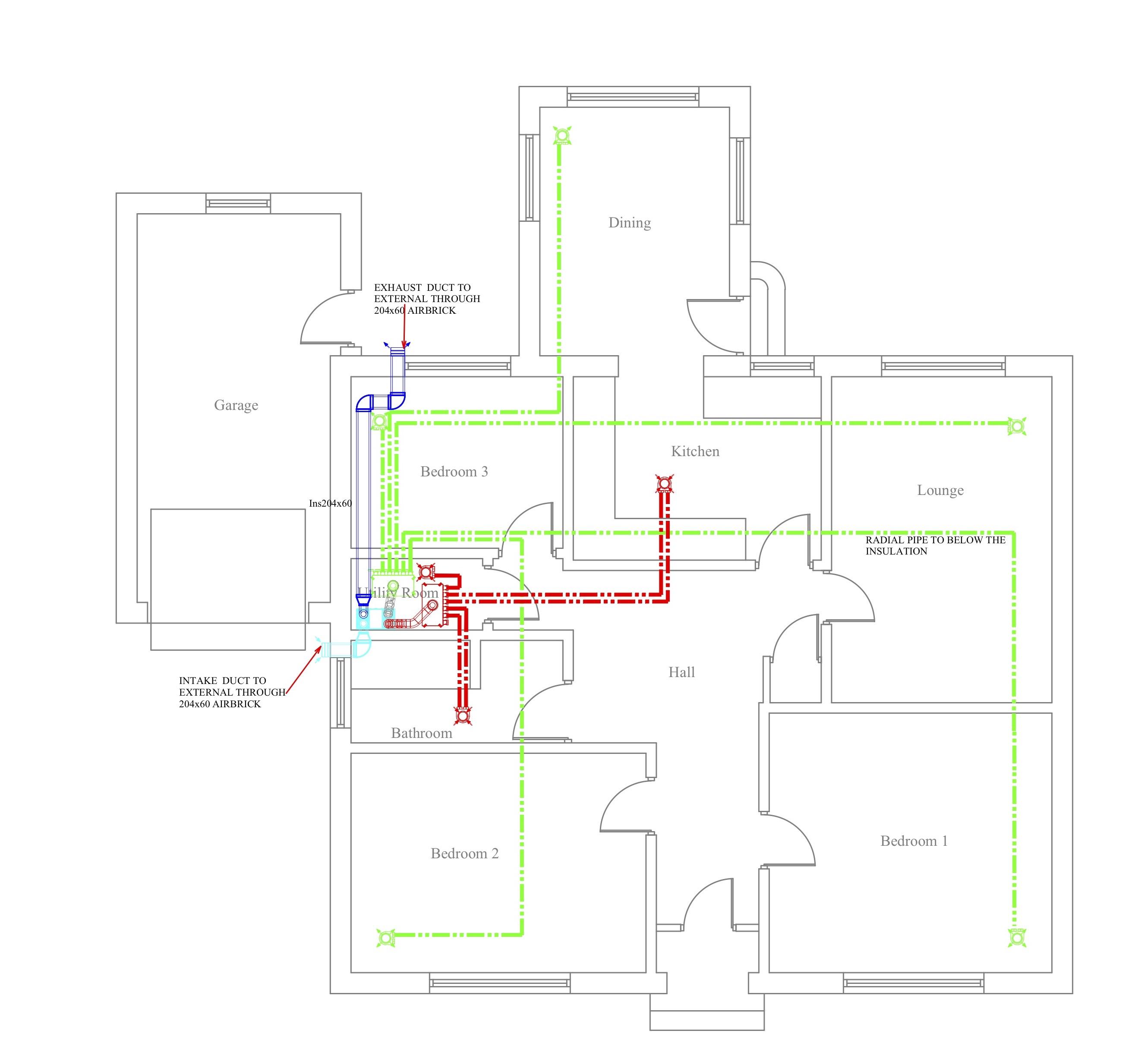

phatboy Posted October 13, 2019 Author Posted October 13, 2019 Sorry I've not made things very clear! With the MHRV I cannot have an extra extracts (presumably), nor should I need to I don't think? Please see attached room with issue, and whole house MHrV design. The problem room is Bedroom 1. Thanks again... Tim

ProDave Posted October 13, 2019 Posted October 13, 2019 We live in a new modern near passive house level house with mvhr. There is a complete absense of condensation or mould anywhere, and I share others views that the air always feels fresh inside. Smells, e.g from cooking disperse very quickly. Back to the OP. You mention "moisture from the shower" Do you just have the 1 bathroom, or are you saying there is an en-suite shower in this bedroom? One thing that strikes me is you have 5 fresh air points but only 2 stale air extract points. I would try adding an extra stale air extraction point to bedroom one at the opposite corner to the existing fresh air point.

Declan52 Posted October 13, 2019 Posted October 13, 2019 4 hours ago, phatboy said: Sorry I've not made things very clear! With the MHRV I cannot have an extra extracts (presumably), nor should I need to I don't think? Please see attached room with issue, and whole house MHrV design. The problem room is Bedroom 1. Thanks again... Tim Could you open the ceiling vent up a bit more to try to increase the flow rate a bit more.
