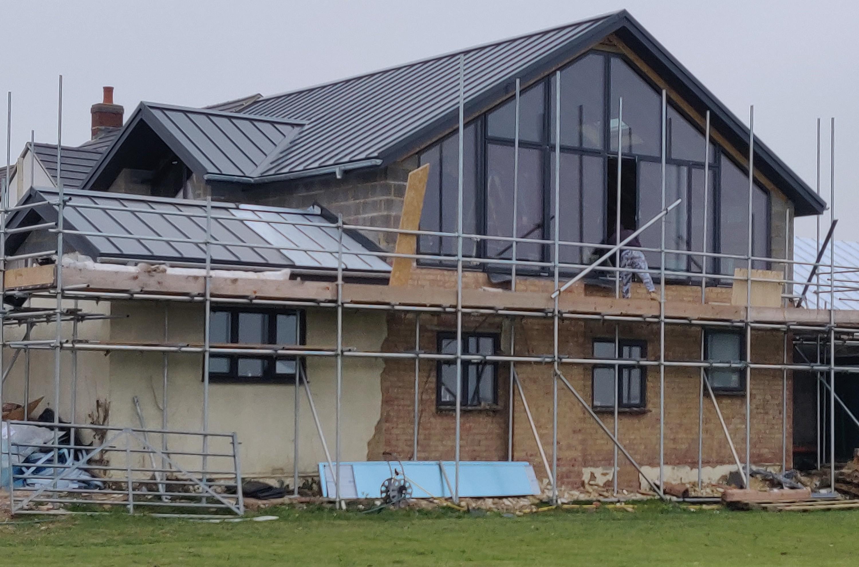

Oz07 Posted October 9, 2020 Share Posted October 9, 2020 @craig is there not an industry standard fitting guide a bit like the one BWF produces for stairs. It's very generic but covers most essentials. I'm sure most carpenters would be capable of fitting these Windows if they knew the exact specifications/details. Always seems to be a lottery with window fitters whereas if the customer has a chippie they trust I'm sure they could manage. Neck I even think @Russell griffiths even fitted his own And he's a rough arse tree surgeon. 1 Link to comment Share on other sites More sharing options...
craig Posted October 9, 2020 Share Posted October 9, 2020 (edited) 6 minutes ago, Oz07 said: is there not an industry standard fitting guide a bit like the one BWF produces for stairs. It's very generic but covers most essentials. Yes, each manufacturer will have one and guideline supplied by GGF for example. They will vary slightly but generally they are the same. Not being fitted to factories recommendations, will void warranties. Issue Nick experienced was something else entirely. Edited October 9, 2020 by craig Link to comment Share on other sites More sharing options...
Oz07 Posted October 9, 2020 Share Posted October 9, 2020 Wasn't specifically talking about that case, just in general. I've never really met a window fitter who takes pride in their work. Seems to be a rough trade then you get the firms expert come to fix up or adjust any issues. 2 Link to comment Share on other sites More sharing options...
