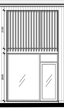

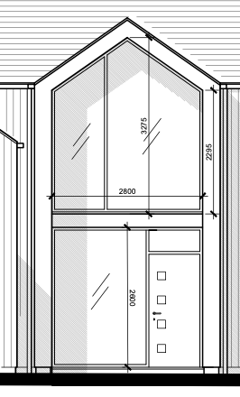

GaryM Posted July 30, 2020 Posted July 30, 2020 (edited) I'm looking for two glazed gable ends, total area of 33m2, one has a front door, the other one or two sliding doors. The quotes I'm getting to supply range from 20k to 42k, which is £600 to £1,280 m2, this is for aluminum with double glazed solar glass and other than the door all fix panes, so not that special. I can't work out if I have complex design (I don'r think so) or have prices all been jacked high recently, looking at other people prices my quotes seem double. So far the best quote is idealcombi, but it still seems high One thing I have just realised my cost include VAT as we are extending upwards. Edited July 30, 2020 by GaryM
Thorfun Posted July 30, 2020 Posted July 30, 2020 our large gable entrance hall windows and doors from Norrsken (alu-clad triple) came in at around £11k (excluding VAT and fitting). drawings of it are attached. think it's about 32m2 in total.
GaryM Posted July 30, 2020 Posted July 30, 2020 4 minutes ago, Thorfun said: our large gable entrance hall windows and doors from Norrsken (alu-clad triple) came in at around £11k (excluding VAT and fitting). drawings of it are attached. think it's about 32m2 in total. Thanks for the reply, I think that is in the region of my lowest quote 11k + vat will be 13.2 + 5k for install. so 18K, but that is for triple glaze. I will give them a call. The layout is below, but I'm happy for the supplier to simply it to help reduce cost
