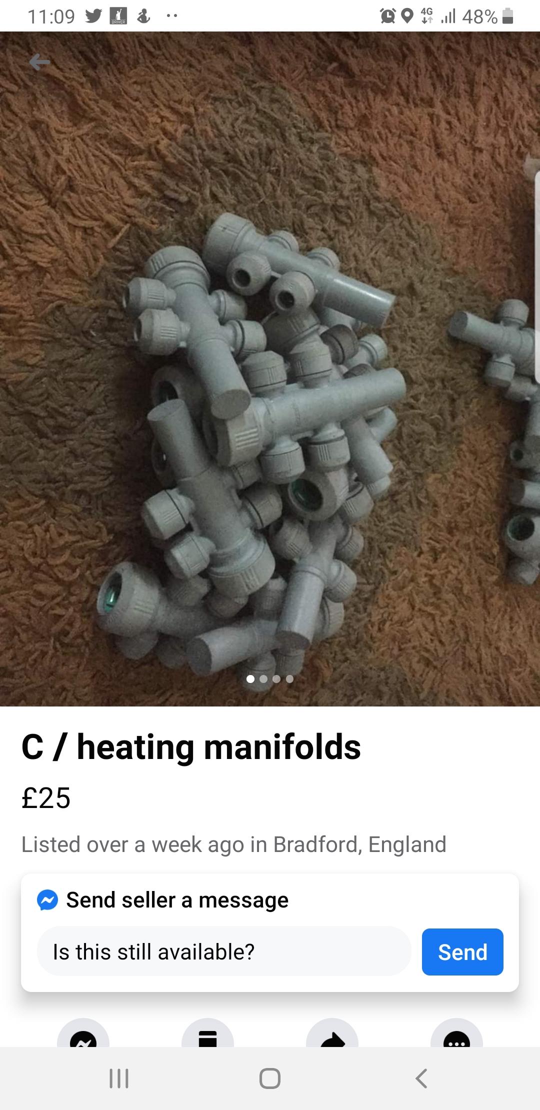

Danny68 Posted January 15, 2020 Share Posted January 15, 2020 Manifolds are I suspect one of the hidden costs that you can never imagine when trying to guess the cost of building a house , now when ever I read a post on BH that tweaks my interest I head for ebay fb marketplace and gumtree to see what's out there . Heres today's offering from fb marketplace a week old advert but may still be available to anyone near Bradford. Link to comment Share on other sites More sharing options...

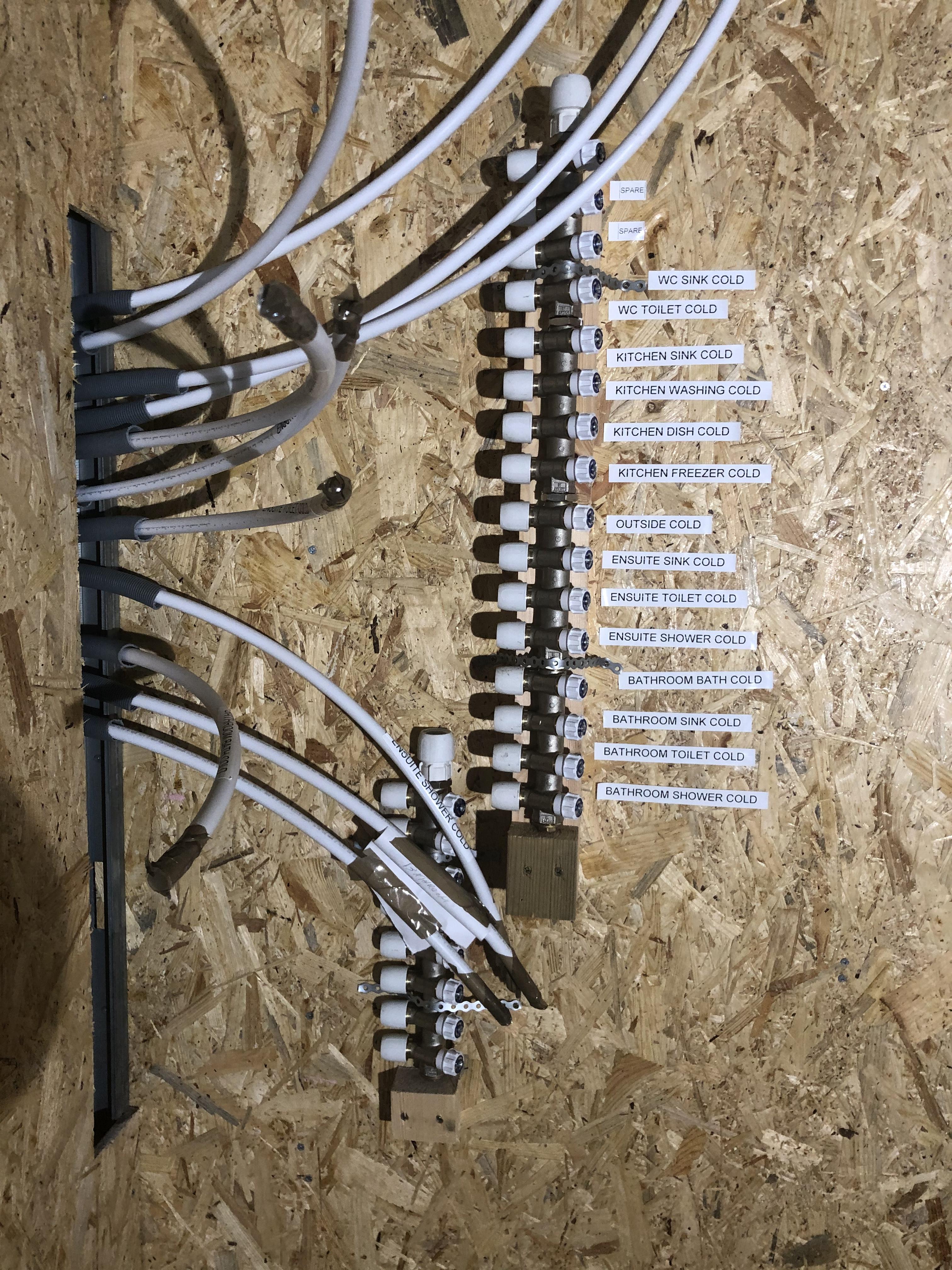

ProDave Posted January 15, 2020 Share Posted January 15, 2020 40 minutes ago, Onoff said: Didn't @ProDave make his? Yes It just feeds a bath, 2 showers and a basin (the other basin tees off straight from the airing cupboard. This is in the void between the utility room ceiling and bathroom floor. The location was chosen as it was the most logical place to branch off for all the destinations, without making any of the pipe runs any longer than necessary. It is now accessed by a mini loft hatch in the utility room ceiling. 1 Link to comment Share on other sites More sharing options...
