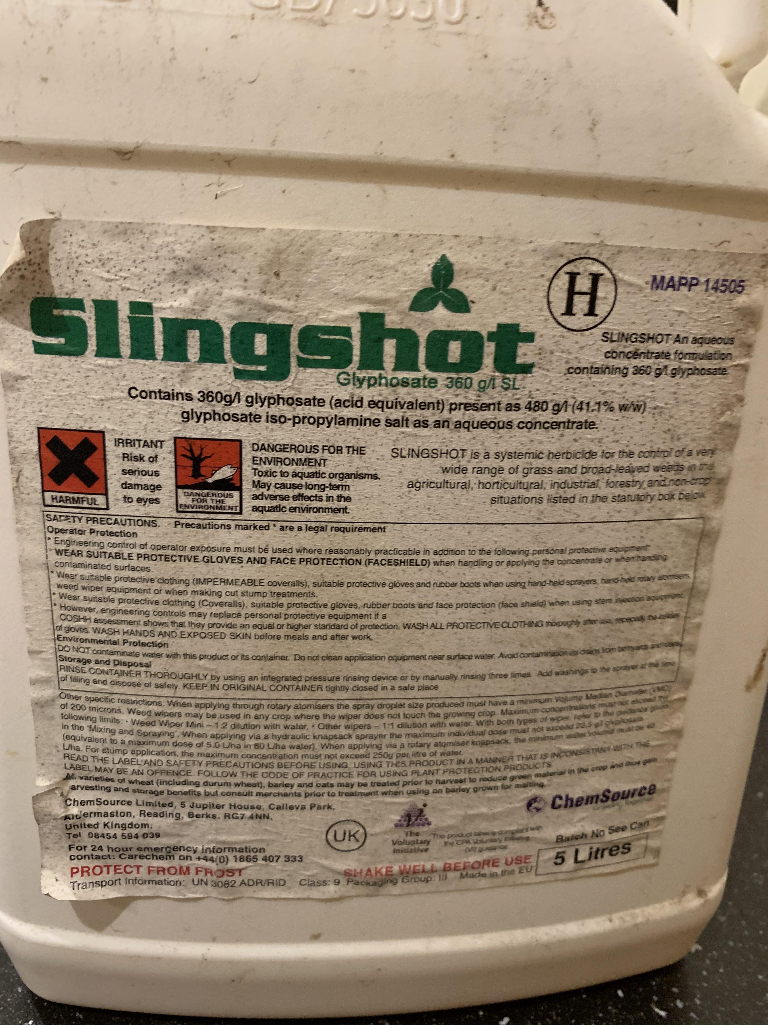

ProDave Posted October 7, 2019 Share Posted October 7, 2019 What did you treat it with originally? I used Glyphosate weed killer in the form of Gallup360 from a back pack sprayer. Link to comment Share on other sites More sharing options...

ProDave Posted October 7, 2019 Share Posted October 7, 2019 10 minutes ago, deuce22 said: I'll need some type of sprayer as the area is quite big. Is it better to spray the plant or clear the site and then spray the earth? Glyphosate is absorbed into the plant via the leaves, so spray a living plant. Don't strimmer it first and don't dig it up. Link to comment Share on other sites More sharing options...

Jeremy Harris Posted October 7, 2019 Share Posted October 7, 2019 Just now, deuce22 said: I was planning to clear the site in 3 weeks. How long after I've sprayed it (with either glyphosate or salt) would I need to leave it before digging it up? Two to three weeks after spraying, or when you see the signs of the leaves yellowing. For best effect, spray twice, about two or three days apart, as at this time of year growth is slow and uptake of glyphosate will be much reduced. The idea is to leave it long enough for the glyphosate to be translocated to the root system. One issue is rain. If it rains within 12 to 24 hours of spraying, then you'll need to spray again, as the stuff may well have been washed off the leaves. Link to comment Share on other sites More sharing options...
newhome Posted October 7, 2019 Share Posted October 7, 2019 This is fortuitous as I have just come to the end of my current batch of weedkiller and need to buy more. I assume that this is the same as Gallup 360? It has been quite effective but I could do with a final spray before winter as there are still new weeds appearing. £30 for 5 litres seems to be about the going rate from a quick google Link to comment Share on other sites More sharing options...
Jeremy Harris Posted October 7, 2019 Share Posted October 7, 2019 6 minutes ago, newhome said: This is fortuitous as I have just come to the end of my current batch of weedkiller and need to buy more. I assume that this is the same as Gallup 360? It has been quite effective but I could do with a final spray before winter as there are still new weeds appearing. £30 for 5 litres seems to be about the going rate from a quick google Yes, any glyphosate with "360" in the description is generally the strongest concentrate that's easily available. I've been using Gallup 360 for years, as it's generally the cheapest way to buy concentrated glyphosate. £30 sounds about right to me, I'm pretty sure that's about what I paid for the last lot I bought. It does contain a surfactant, but it can be slightly improved when used on waxy-leaved weeds by adding a squirt of detergent, to help it wet the surfaces of the leaves a bit better. 1 Link to comment Share on other sites More sharing options...

deuce22 Posted October 7, 2019 Author Share Posted October 7, 2019 I need to spray around 500m2. Would 5l be enough? Link to comment Share on other sites More sharing options...

Jeremy Harris Posted October 7, 2019 Share Posted October 7, 2019 41 minutes ago, deuce22 said: I need to spray around 500m2. Would 5l be enough? Massively so. 5l of 360 is good for treating well-established weeds over about 10,000m2 I'd be inclined to dilute to a fairly strong mix, of around 30ml/litre at this time of year (20ml/litre is usually fine in peak growing season). You'll find that 5l of concentrate will last a pretty long time. Link to comment Share on other sites More sharing options...
Redoctober Posted October 7, 2019 Share Posted October 7, 2019 (edited) I've been using Longbow with a back pack on an area which measures about 600sqm - and found it to be very effective against the weeds Approx cost - £85 for 5ltrs. Back pack around £50 - worth investing in a decent one. I suspect my 5ltrs will last a very long time so no worries on that front. Edited October 7, 2019 by Redoctober additional info. Link to comment Share on other sites More sharing options...
PeterW Posted October 7, 2019 Share Posted October 7, 2019 Please remember that Glyphosate 360 is actually a commercial product, and should be used with caution !! This is the warning from most of the products : Safe Use of Pesticides The purchaser and/or end users are responsible for ensuring that these products are used in line with industry Approved Codes of Practice. All operators must be trained and certificated in using and applying any Ministry Approved professional product. You must ensure the end user of these products complies with the DEFRA/HSE Code for the Safe use of Pesticides: "By law, everyone who uses pesticides professionally must have received adequate training in using pesticides safely and be skilled in the job they are carrying out." Do not think that mixing it double or triple strength will make it work quicker - it won't !! Link to comment Share on other sites More sharing options...
